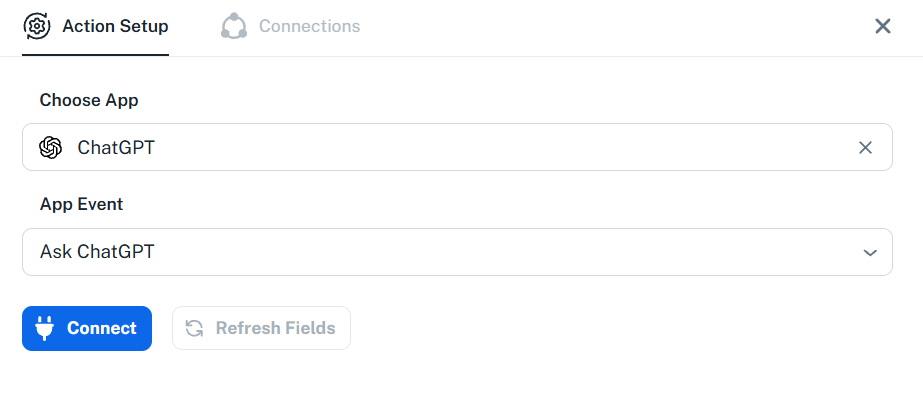

For Issue 2 (feeding the email to AI to classify it as Interested/Not Interested): This can be handled by adding an AI action step to the workflow after the trigger and using the returned classification to route the rest of the automation.
You can add a ChatGPT action step to your workflow wherever you want to check for interest/disinterest. Then, add a Router with two routes: Interested and Not Interested. Within each route, you can add the respective action steps you want to execute.

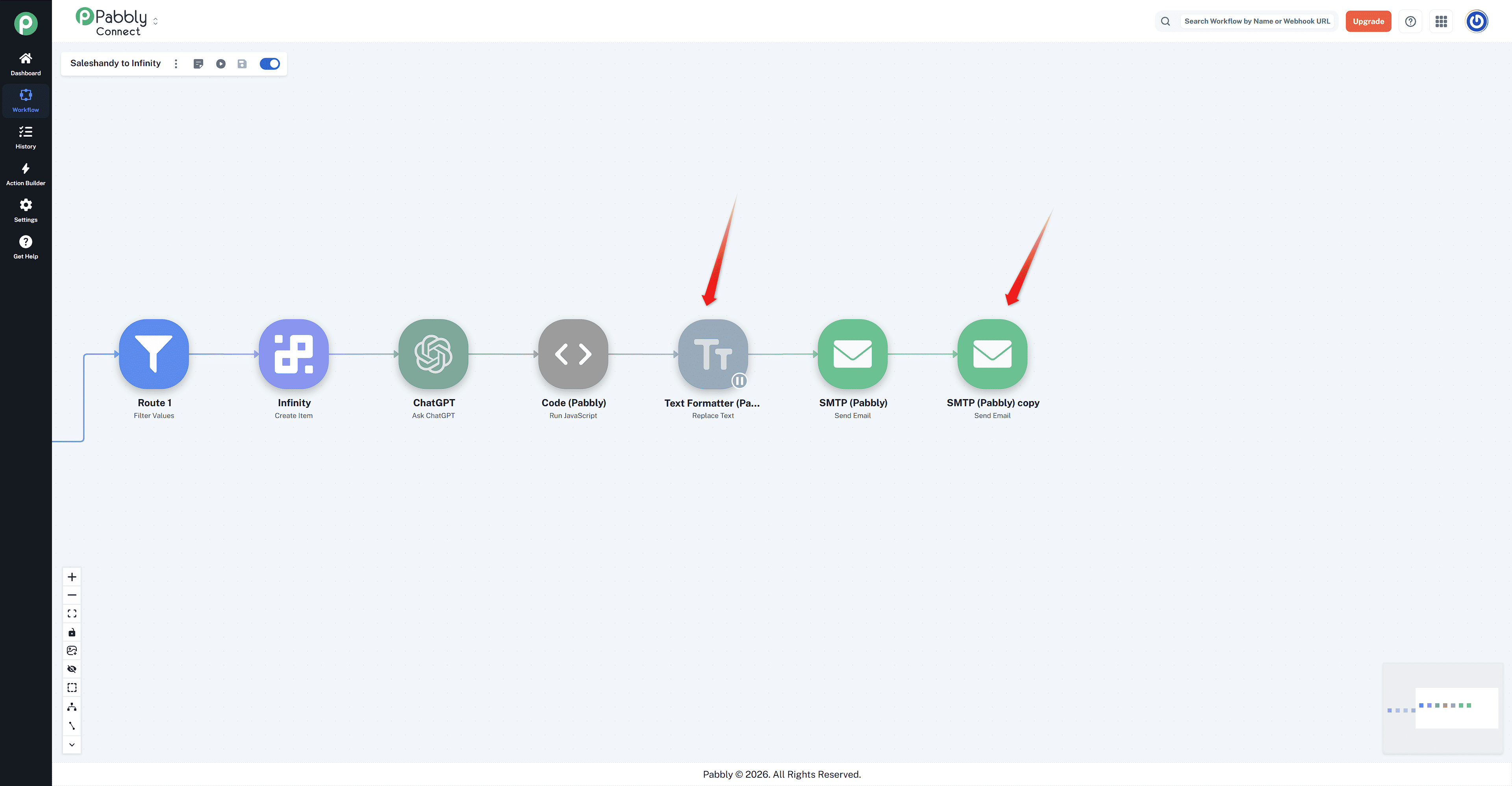

Hello there,
We have updated the Text formatter and then added another SMTP: Send Email action in the workflow and sent the email from it to you. Can you check if you received the email correctly?
