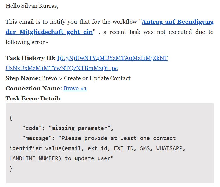

Hi, I get this message but all seems fine, the workflow is running. So what exactly is missing/not working so that I can check?

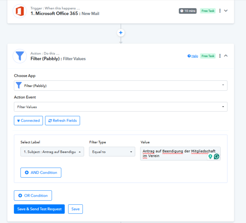

  1. I don't want all Outlook emails to trigger an action, but only emails with a certain content or subject line. In Zapier, this trigger is called "New Email Matching Search". The search term in the subject line is: "Antrag auf Beendigung der Mitgliedschaft im Verein:" How do I set this up?
    Currently, the workflow is triggered with every email, which is of course not possible.

My problem: I don't want all Outlook emails to trigger an action in this workflow, but only emails with a certain content, or subject line. In Zapier, this trigger is called "New Email Matching Search". The search term in the subject line is: "Antrag auf Beendigung der Mitgliedschaft im Verein:" How do I set this up?

Hello @flowyze,
To process only the emails with a specific subject line, you can add a filter right after the trigger. In the filter step:
  • Select the Subject label.
  • Choose the filter type (e.g., Contains).
  • Enter the desired text in the value field, as shown in the attached screenshot.
This will ensure that only emails with the specified subject are processed further in the workflow.
Let us know if you have any further queries.
