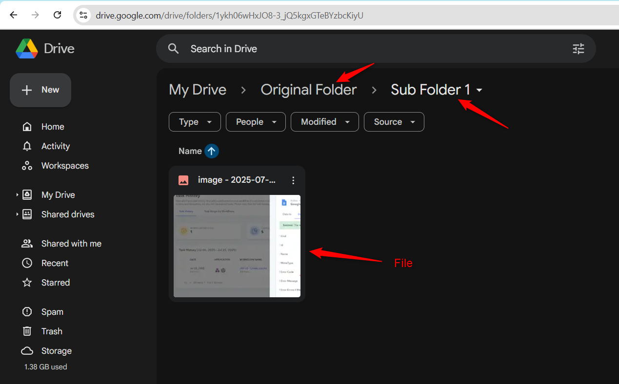

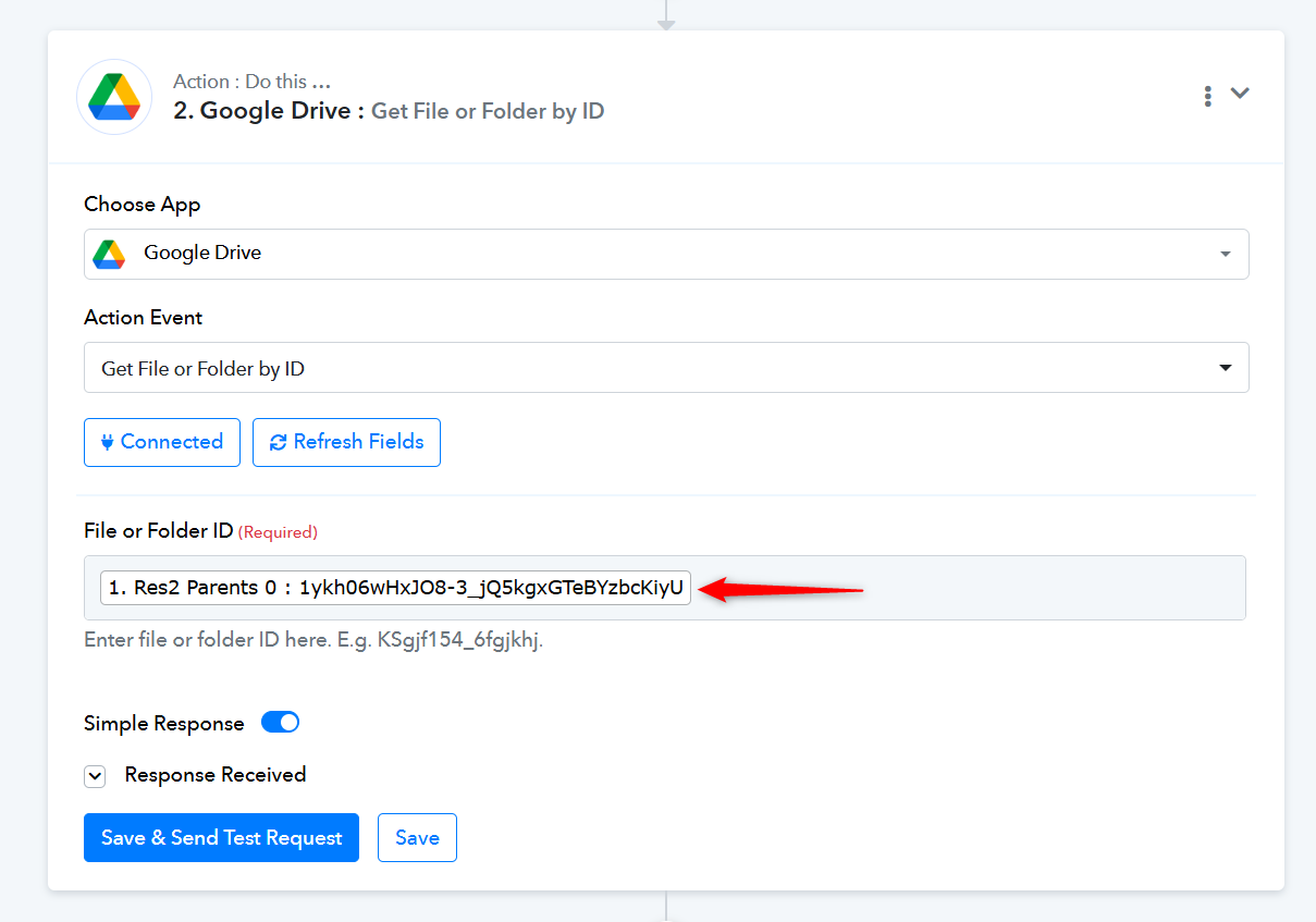

You would have to set up your workflow in this manner.

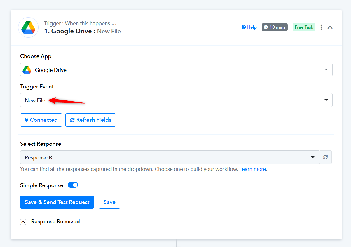

  1. Set up 'Google Drive: New File' as your trigger step. It triggers whenever a new file is uploaded to your Google Drive, regardless of the folder.
  1. Then, add a 'Google Drive: Get File or Folder by ID' action step to your workflow and search using the Parent ID of the file. The Parent ID refers to the 'Sub-Folder'. This step will fetch the Parent ID of the sub-folder, i.e., the original folder to which the sub-folders are being added.

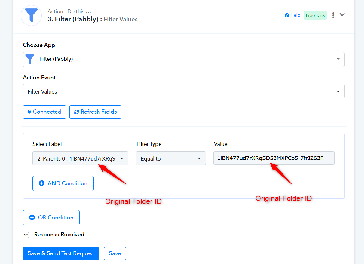

  1. Add a Filter as step 3 of the workflow to ensure that the subsequent steps are executed only if the files are added to the sub-folders of the original folder.

  1. The trigger remains the same—it will still trigger on every file uploaded to your Google Drive.

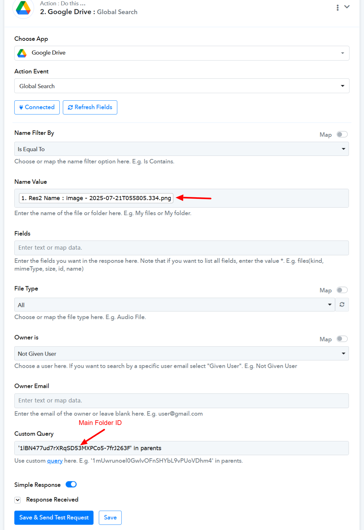

  2. In step 2, we are using the 'Global Search' action with a query to ensure that only files uploaded within the Main Folder are fetched.
  1. The Filter will ensure that only files uploaded to the Main Folder (regardless of how deep within its subfolders the file is placed) will trigger the next steps. If the file is not uploaded to the Main Folder—or any of its subfolders, sub-subfolders, and so on—then the next steps will not be executed.

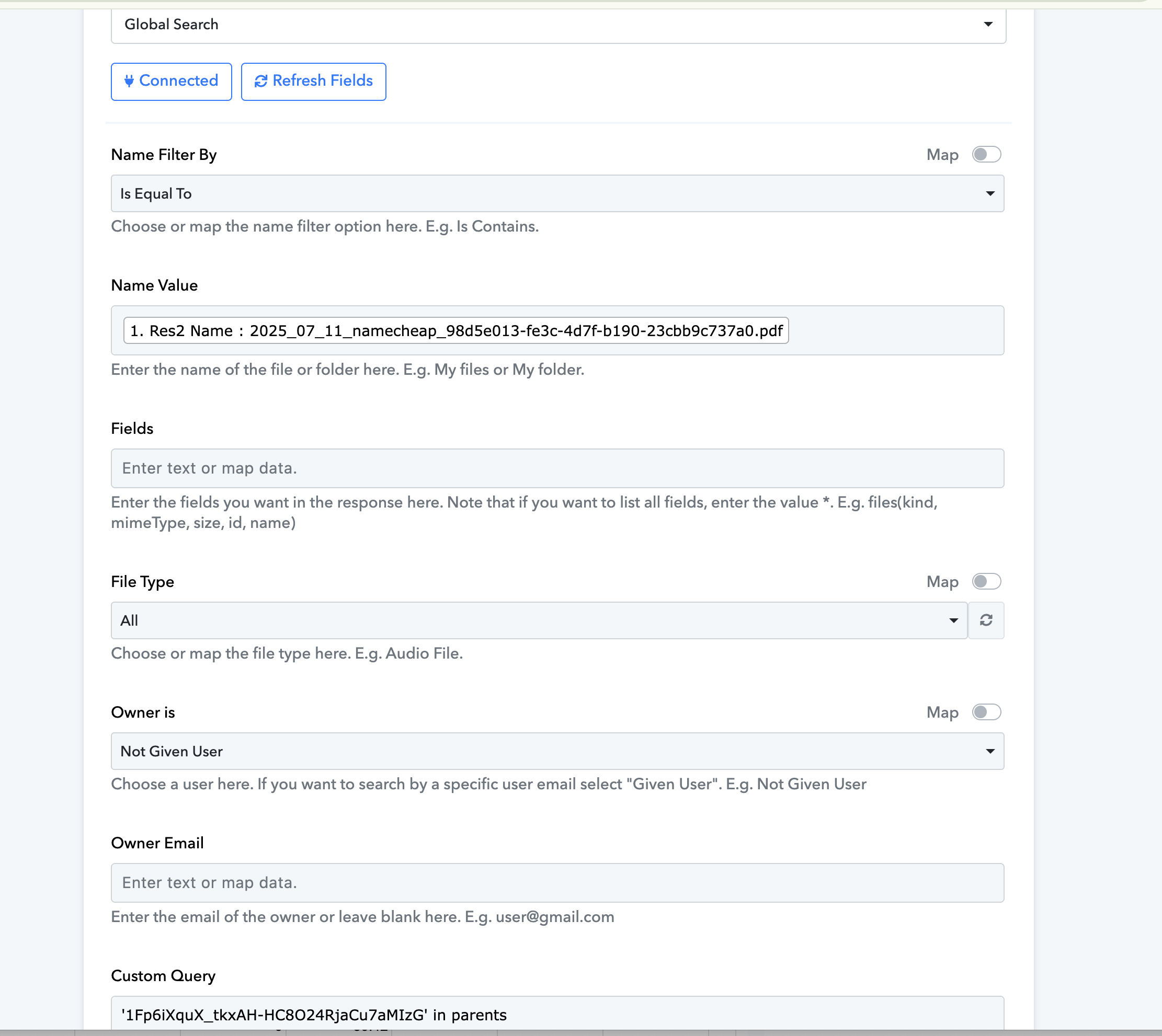

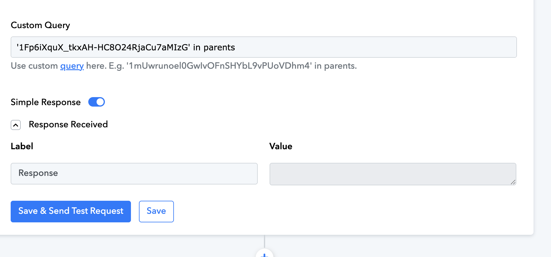

Hi again, thanks for the response!
I tried to set this up.

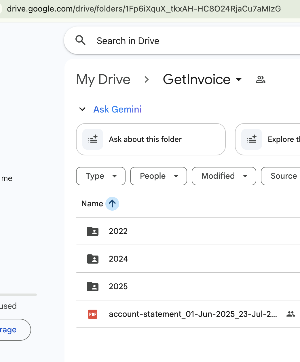

I took the folder ID:
And inserted it here:

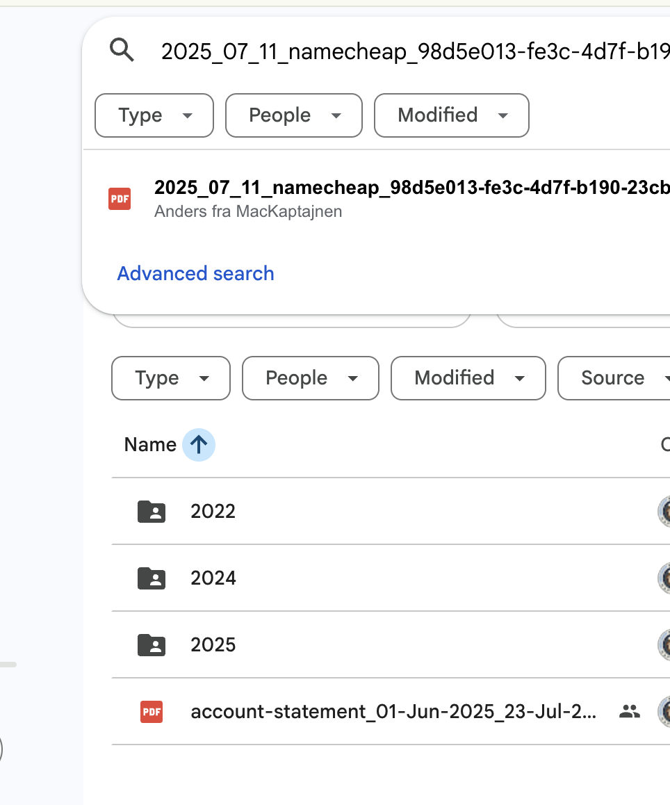

But I get an empty response
But the file is there?
So something still seems wrong? I copied the exact ID of the main GetInvoice folder url as you see on the screenshots.
The specific namecheap invoice file is in Gdrive > GetInvoice > 2025 > July
ArshilAhmad
Moderator

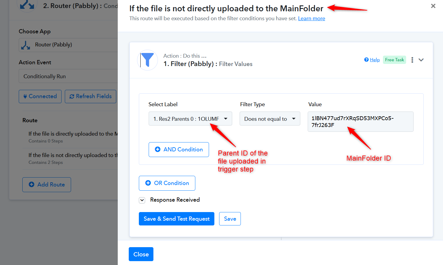

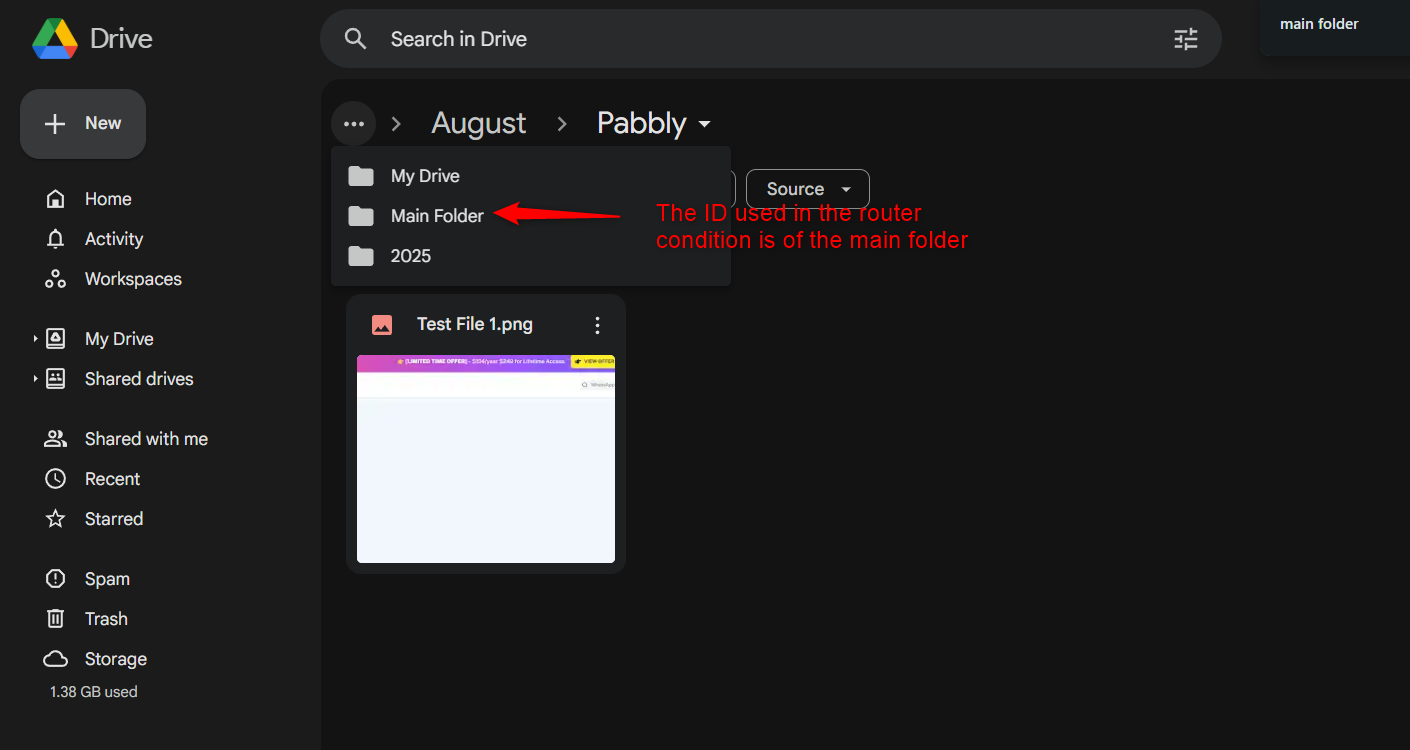

It looks like the 'Global Search' doesn't fetch a file located within a sub-folder of the Main Folder. The file shown in the example I shared above was retrieved from the Main Folder itself. We apologize for the inconvenience caused.

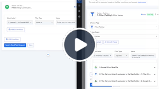

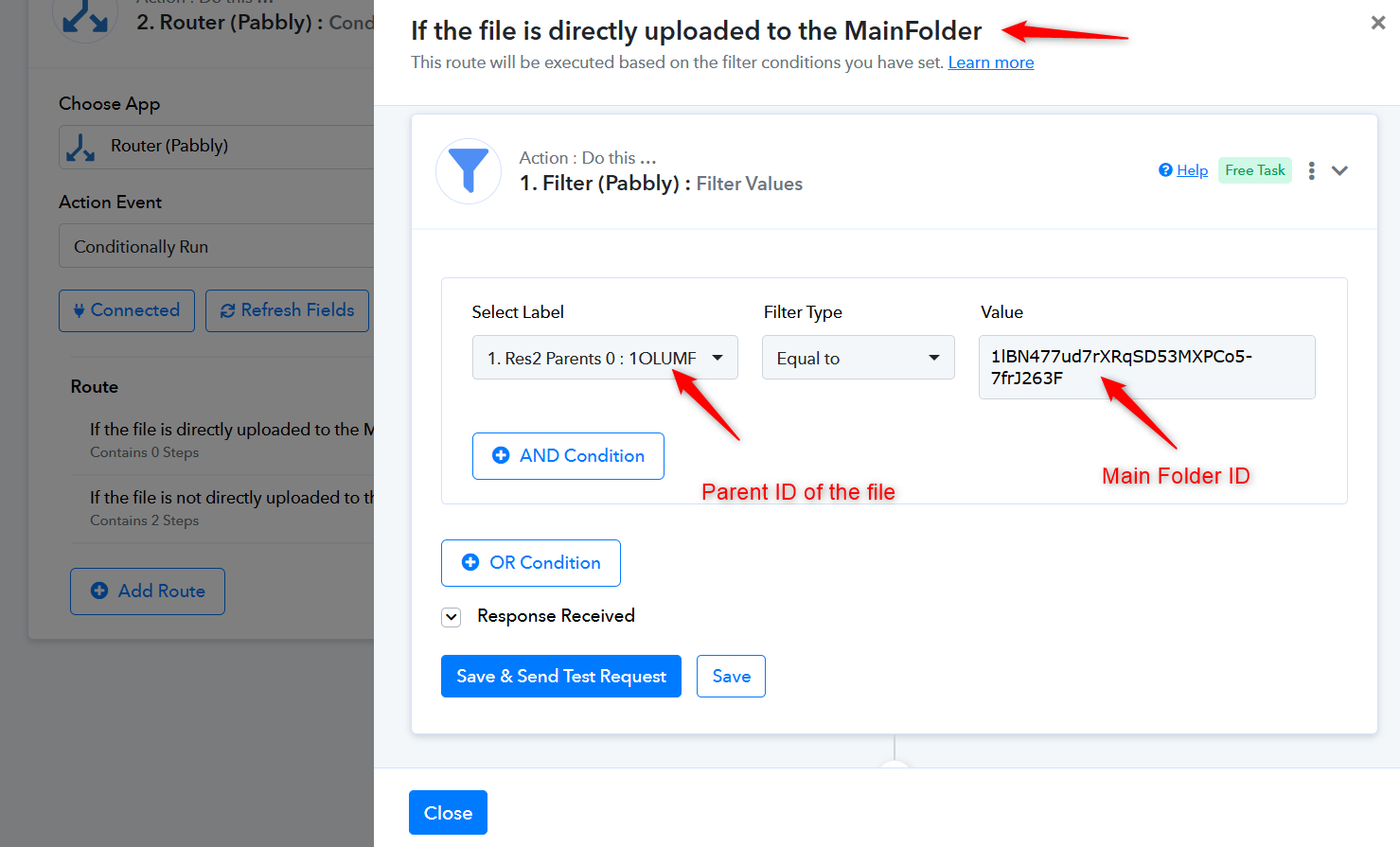

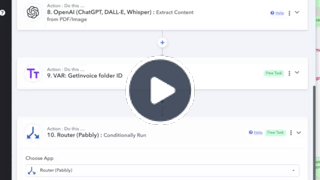

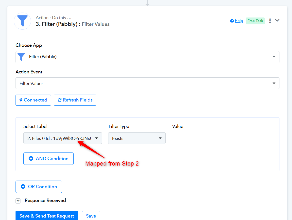

We have set up this workflow for you, which uses routers and filter conditions to continuously search for the parent of the file. Once the Parent ID matches the ID of the Main Folder, the filter condition is met, and the next steps are executed.
Please take care when configuring the router conditions and mapping the data to avoid any issues
apps
Wow, thanks! Checked out the workflow. Can't quite understand it - it looks very complicated :-D But I will try to reproduce it.

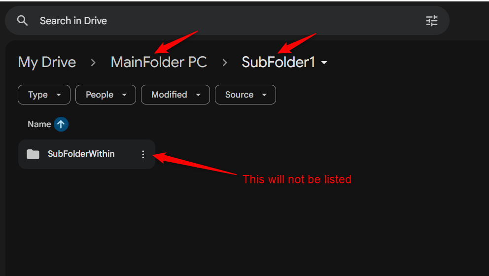

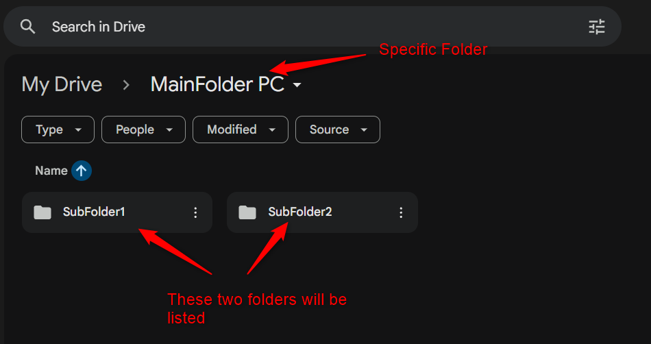

Hi again,
I tried to set this up but got stuck. I don't see how this work as I have multiple years and 12 months in each year. So the flow doesn't seem to work unless I am missing something. It seems that the workflow assumes I have a subfolder "Year" with a subfolder of Month. I am trying to show what I mean here:
