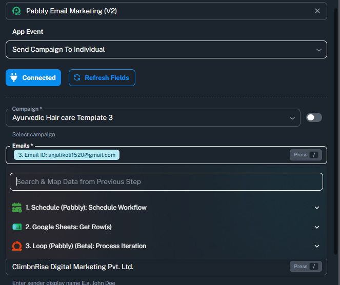

Sidharth Parmar โ€” Reply ยท
also showing like this, data maping not showing also status will showing error please check on your back end please
Pabbly Support โ€” Reply ยท
Thank you for sharing the details.
In the Send Campaign action step, under the Emails field, you need to select the Loop by Pabbly response from the dropdown. From there, map the individual email address field (e.g., Email: [email hidden]) rather than the raw array.
Once this clean email field is mapped from the Loop step, click Save & Send Test Request. The test request will run successfully and queue the campaign emails properly.
Please update this mapping in your step and let us know if you need any further assistance!

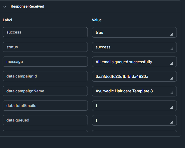

Hello Pabbly Team,
In my Pabbly Connect workflow, โ€œSave & Send Test Requestโ€ shows a successful response, but the emails are not reaching the recipientโ€™s Gmail account. I checked Inbox, Spam, Promotions, and All Mail, but the emails are nowhere to be found.
Workflow: Email marketing Demo - 1
Action: Pabbly Email Marketing (V2) โ€” Send Campaign To Individual
Delivery server: Amazon SES (ap-south-1)
Sender: [email hidden]
Please check my setup and sending logs to identify why the test request shows success but the emails are not being received. Kindly confirm whether they are being queued, rejected, or bounced, and guide me on the exact steps to resolve this.
Please help resolve this as soon as possible so I can start my email campaign.
Thank you.

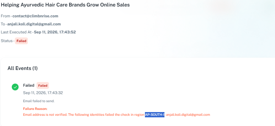

Hello Sidharth,
We checked the response from the workflow and found that the email was successfully queued under action: Pabbly Email Marketing (V2) โ€” Send Campaign To Individual. However, in the Pabbly Email Marketing campaign report, 4 emails are showing as failed and 1 as delivered.
When we checked the View Details section for the failed emails, the failure reason is the same one we discussed earlier: โ€œEmail address is not verified. The following identities failed the check in region AP-SOUTH-1.โ€
As discussed during the meeting, your Amazon SES account is currently in Sandbox mode, so recipient email addresses must be verified before Amazon SES can deliver emails to them.
Please follow the Amazon SES steps to verify the required recipient email address(es). Once done, please test the campaign again.
Steps:
  1. Open the Amazon SES console at https://console.aws.amazon.com/ses/.
  2. In the navigation panel, choose Account dashboard.
  3. In the warning box at the top of the console that says, "Your Amazon SES account is in the sandbox", on the right-hand side, choose View Get set up page followed by Request production access.
Reference URL: https://docs.aws.amazon.com/ses/latest/dg/request-production-access.html
For regular campaigns where emails need to be sent to unverified recipients, you will need to request Production Access to move the SES account out of Sandbox.
Please complete these steps first and then perform the testing again.
