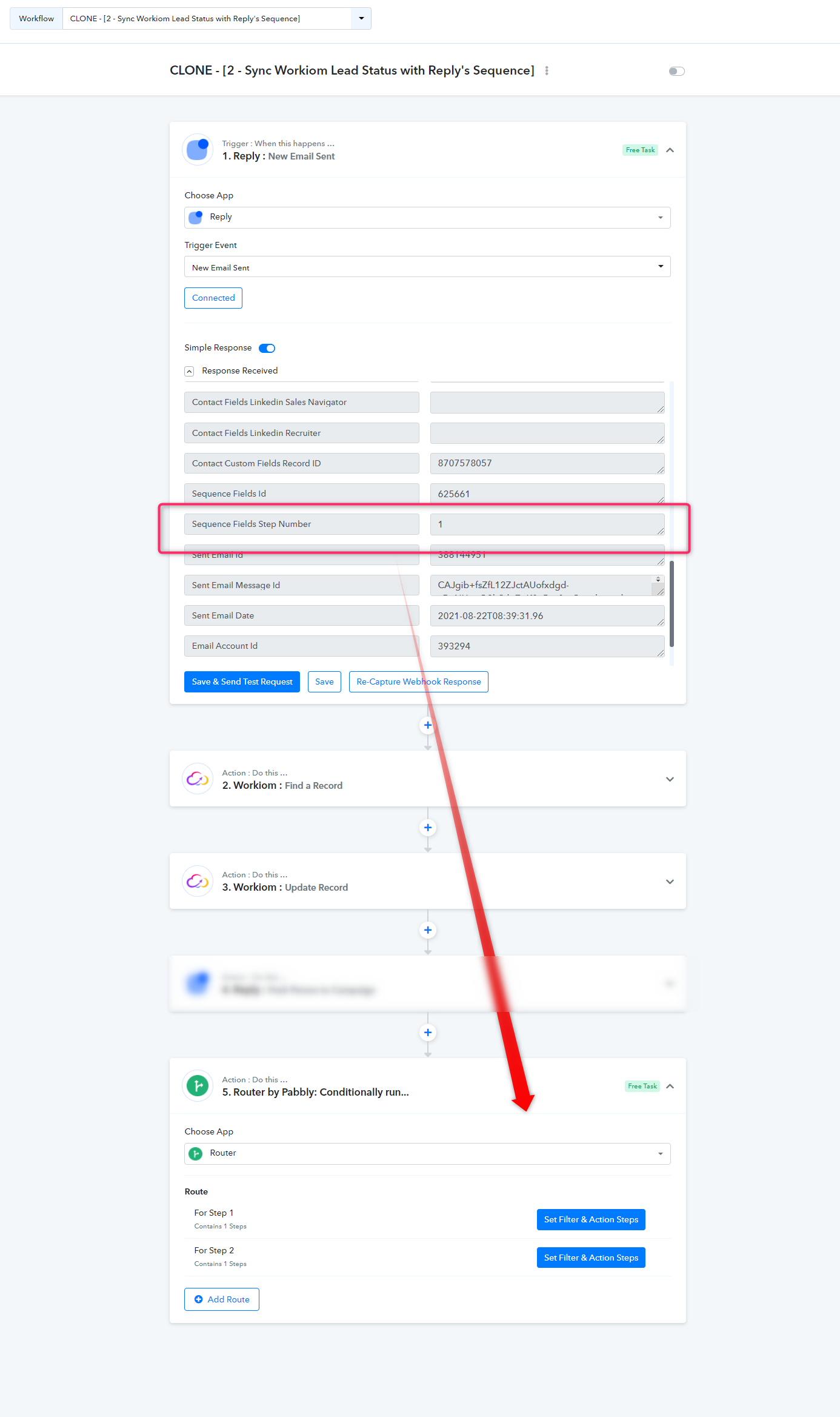

Hey @Edwin
To clarify - I need to create 6 different Pabbly workflows for 1 Reply.io sequence, correct?
You might need to add router conditions in your workflow where you can add router as many steps as you are trying to involve as per your requirement in Reply.
Although we have set 2 routers on your cloned workflow as of now on the basis of Sequence Fields Step Number, you can add as per your need. Please check this out and try to implement the same steps in your original workflow.

@Supreme Verma ah yes, this makes sense!
I'll test the following:
1) Trigger > Reply > New Email Sent
2) Action > Pabbly > Router > "If Sequence Fields Step Number" equals "1" > Action > Workiom > Find Record + Action > Workiom > Update Record
3) Action > Pabbly > Router > "If Sequence Fields Step Number" equals "2" > Action > Workiom > Find Record + Action > Workiom > Update Record
and so on...

Unfortunately, the routers didn't work as the records were not synced.
So I basically have 2 questions:
1) is this the correct setup: https://www.loom.com/share/070678bba690459aa4e3a2ff18506064
2) I guess I can't have 1 workflow for the entire Reply sequence. Because I also want to use another type of Reply.io trigger: when the lead replies to my email.
Am I on the right track?
I'm also implementing Calendly w/ Zoom and Meet in the Reply sequence, I can already see the Pabbly challenge of getting this all synced 🤣

Supreme
Hey @Edwin
Yes, the workflow seems fine to us. As it is implementing the emails accordingly.
You can make separate workflows as you have required 2 different events another type of Reply.io to trigger.
