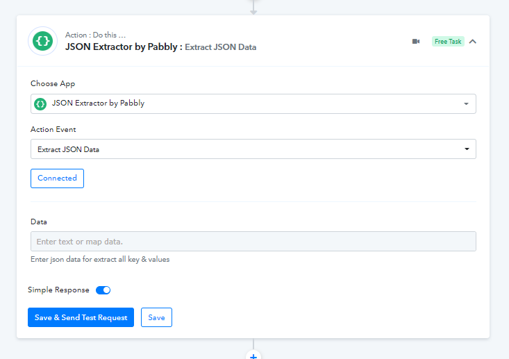

Hey @JTUlyatt2
You should check if there is any plugin to extract json on pabbly.
To extract the JSON on Pabbly, you can use the "JSON Extractor " action step after the trigger event by capturing the trigger response in advance response by toggling the "Simple Response" button.

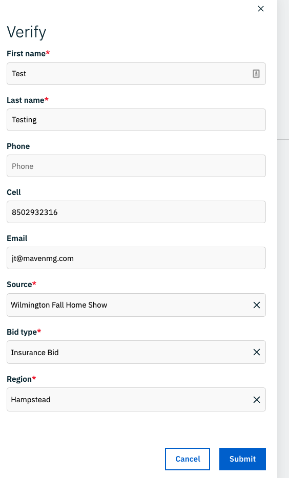

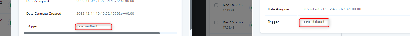

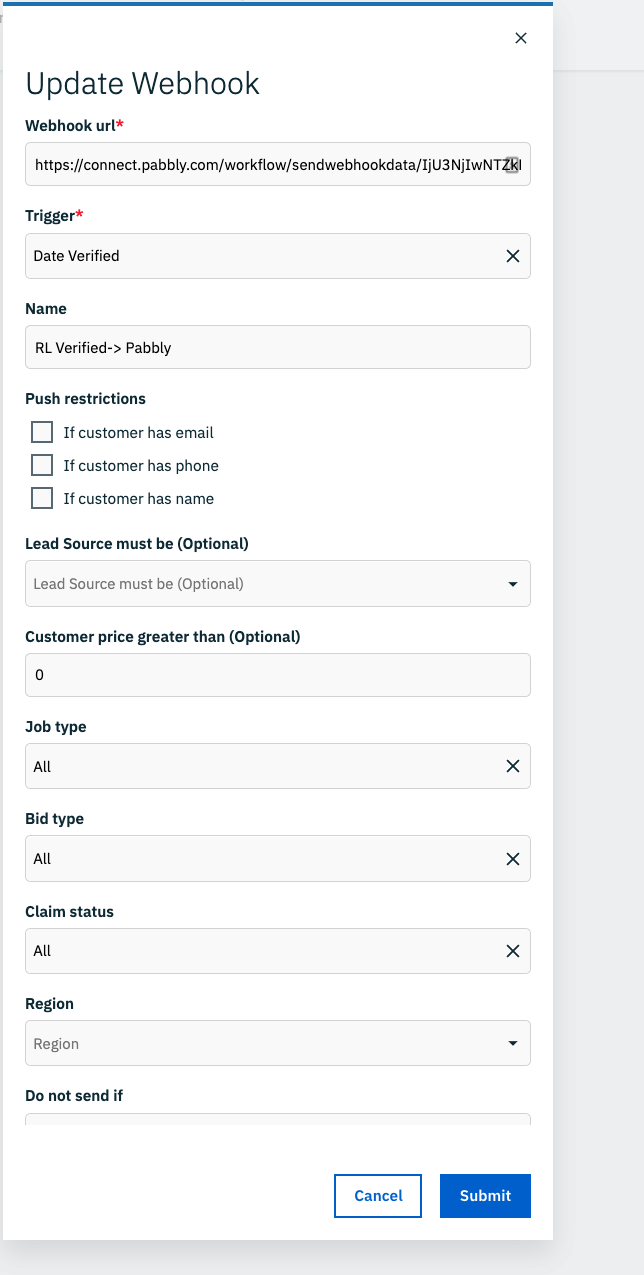

I'm triggering off (1) trigger in my CRM (Roof.link) called Date Verified. When I hit the date verified, see image in my RL CRM, it will send this data to a webhook. Are you stating they are sending it twice? Or could you be seeing my testing from the same file?

Hey @JTUlyatt2
Yes, from your history logs it looks like you are getting a webhook response with multiple trigger events.
Which you can control further with the help of the Filter action step.

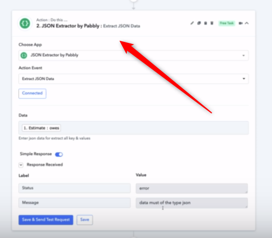

I'm getting JSON error. See loom video.
Zapier seems to not have this issue, what makes your webhook different?
It appears that you are not passing the data in the JSON format and because of that you are getting the error message in the action step.
Please refer to the following video tutorial on how you can use the JSON extractor action step.

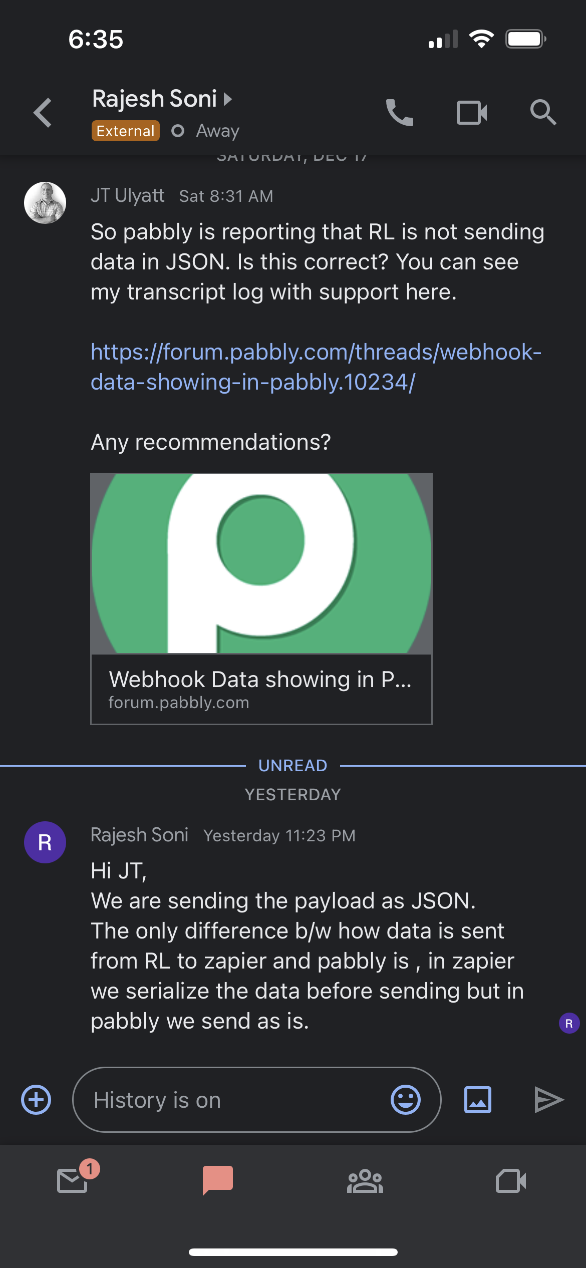

JTUlyatt2
They are reporting this from the other software. Sounds like it is in JSON.
Not sure the difference of “serialization”
Can you add to this?

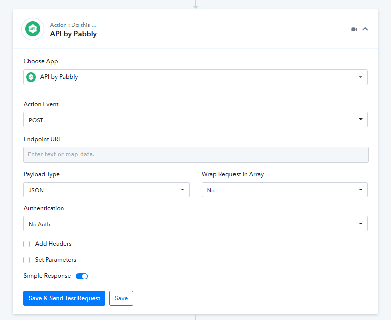

It seems like you should use the "API by Pabbly" action step instead of "JSON Extractor" to use the API request in the workflow.
JTUlyatt2
I have been using the API by Pabbly to post this into to the 2nd software or final endpoint. So I don't understand your intention.
Did you read the comment from Rajesh above? In the screenshot?

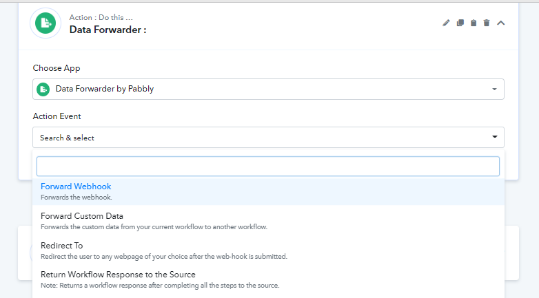

Are you trying to forward the webhook data to another platform or workflow? If yes then why are you using "JSON Extractor by Pabbly" when you can use the "Data Forwarder" action step instead?
JTUlyatt2
No, Here are the actions i'm trying to take....
SYSTEM #1 > SENDS DATA OUT OF SYSTEM USING PABBLY SUPPLIED URL > PABBLY RECEIVES DATA > THEN POSTS DATA IN SYSTEM #2
The issue is not all the data is coming through from System 1. See comments from SYSTEM #1 developer.

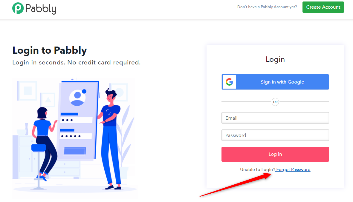

Is there a way to disconnect my google login to pabbly so I can share my password someone?
I need them to have the ability to login and help me with this.
Currently changing my password does not work. Says my old password is not correct.
I think there is some sort of issue with my password and login to google
