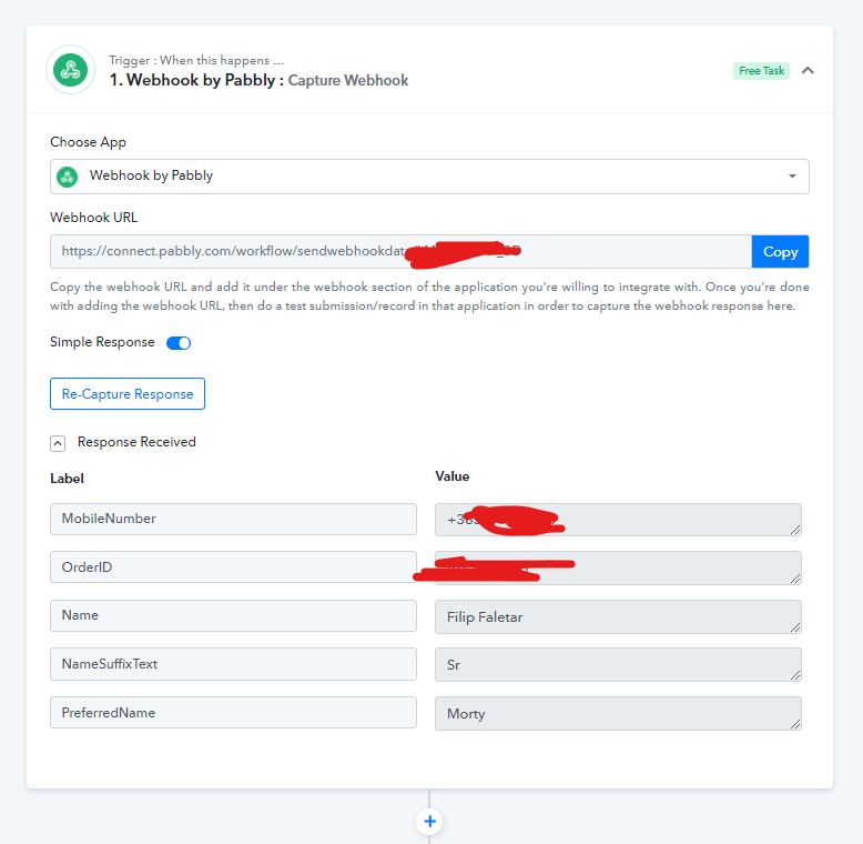

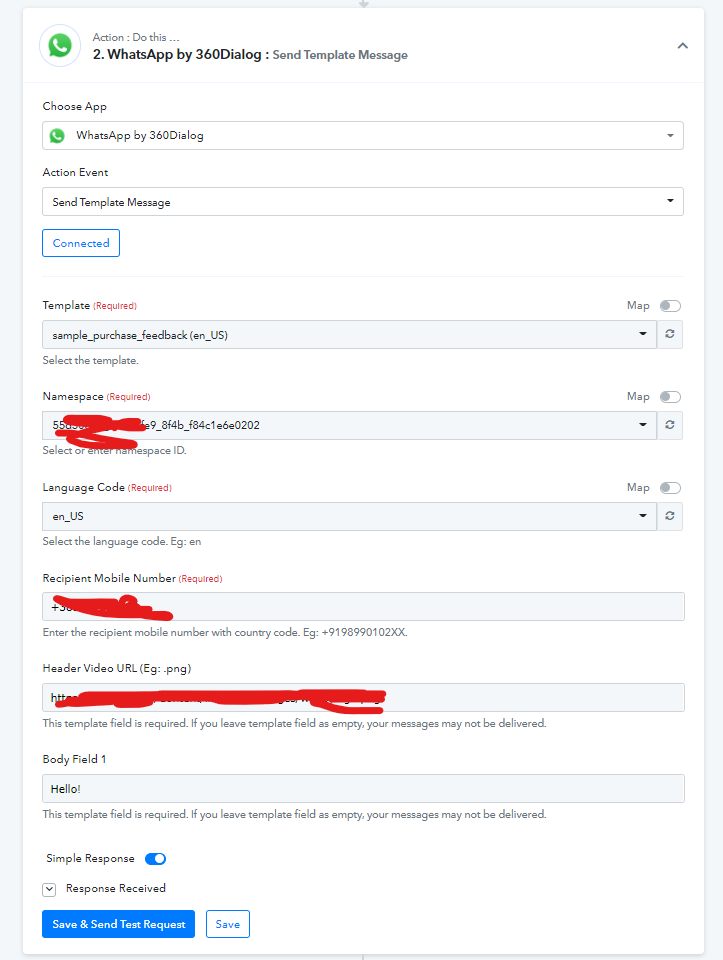

Hi! I'm trying to integrate my web shop with Pabbly and 360Dialog.
I created the workflow with webhook trigger and 360Dialog action. So, to test the workflow I took provided Pabbly webhook URL, put it into the Postman app and made a test POST request. I was surprised when 10 messages got delivered to Whatsapp because I only sent 1 POST request.
Now when I check the Pabbly connect history and tasks count, I can see that this 1 specific POST request consumed 4250 paid tasks and 4253 free tasks.
I disabled this workflow, but I would like to know what happened and how to fix it. I haven't done anything wrong.

Could you please confirm why you're adding the webhook URL in the Postman? Instead, you need to add the webhook URL in the application form where you need to get the details. i.e. you should add the webhook URL in your webshop application only.
Go through this video tutorial to understand how to work with webhooks -
Meanwhile, we have reset your task limit in your Pabbly Connect account. Please check at your end.

We can see that the same webhook URL is being added somewhere else as well apart from the Postman. Most probably in your 360Dialog account itself. Can you please check and confirm the same?
Fale1994
Well, I think I added a webhook URL in 360dialog in the process of creating 360Dialog. Right now I can't find it in their app. Do you think that is the problem?
Pabbly
Administrator
Yes. As a workaround, please delete the current workflow and then create a fresh workflow. That should solve the problem.
