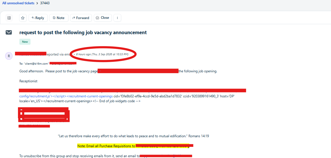

This Freshdesk ticket was sent yesterday, but it wasn't created by Pabbly in Basecamp. Could you please take a look when you get a chance?image.png
Pabbly Workflow: https://connect.pabbly.com/workflow/mapping/IjU3NjYwNTZiMDYzZTA0MzU1MjY1NTUzNjUxMzUi_pc

Ticket ID is 37443.
There were also a lot of issues reported by Freshdesk that time.

We searched our Task History records for Ticket ID 37443, but no corresponding execution log was captured in Pabbly Connect.
Since Freshdesk was experiencing technical issues at that time, it is likely that Freshdesk failed to send the webhook payload to Pabbly Connect when Ticket #37443 was created. Because the trigger webhook was never delivered by Freshdesk, the workflow did not execute, and no To-do item could be created in Basecamp.
To verify that your integration is active and operating normally now, please create a new test ticket in Freshdesk. If the webhook triggers successfully for the new ticket, the issue was strictly due to Freshdesk's temporary outage during ticket #37443.
