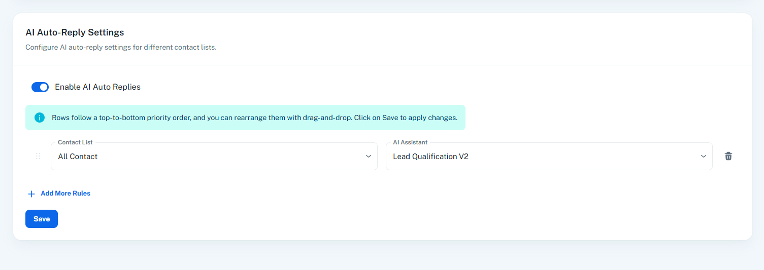

Hello Gaurav,
Thank you for reaching out to us and for sharing the details.
We checked your settings and found that under Settings > Inbox Settings, the AI Auto Reply option is enabled for All Contacts.
Because of this, whenever any contact sends a message, the selected AI Assistant is automatically assigned to that conversation, even if a human agent has previously intervened.
If you do not want the AI Assistant to automatically respond to contacts after human intervention, you can disable the AI Auto Reply option for All Contacts from the Inbox Settings.
Please try this and let us know if you need any further assistance.
Thanks and Regards,
