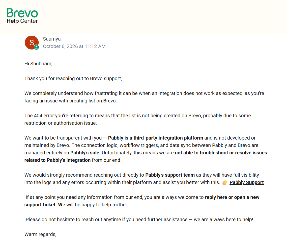

Got this from brevo:

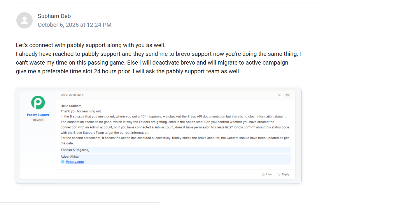

Subham Deb — Reply ·
sure thankx, mainly focuson the API endpoint url for the specific task like create list not connection levle as brevo is also mentioned the same.
