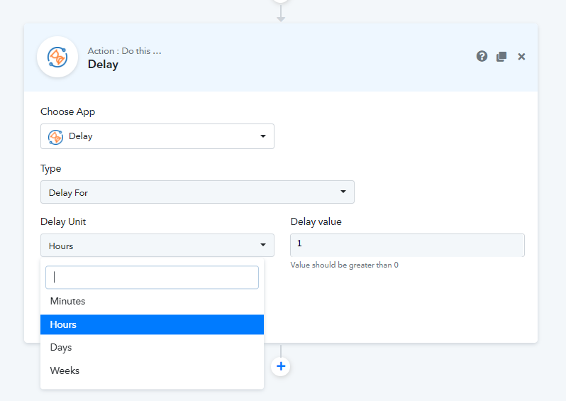

You can make use of Delay step to wait for an hour as shown in the screenshot:
Then, you can use Google Sheets - Lookup Spreadsheet Row(s) step to find the email in your google sheet and then, use Router step to set your condition if Google Sheets - Lookup Spreadsheet Row(s) has a row index in response or not and then on that basis you can send the email else, do different thing.
I hope you find this helpful.
