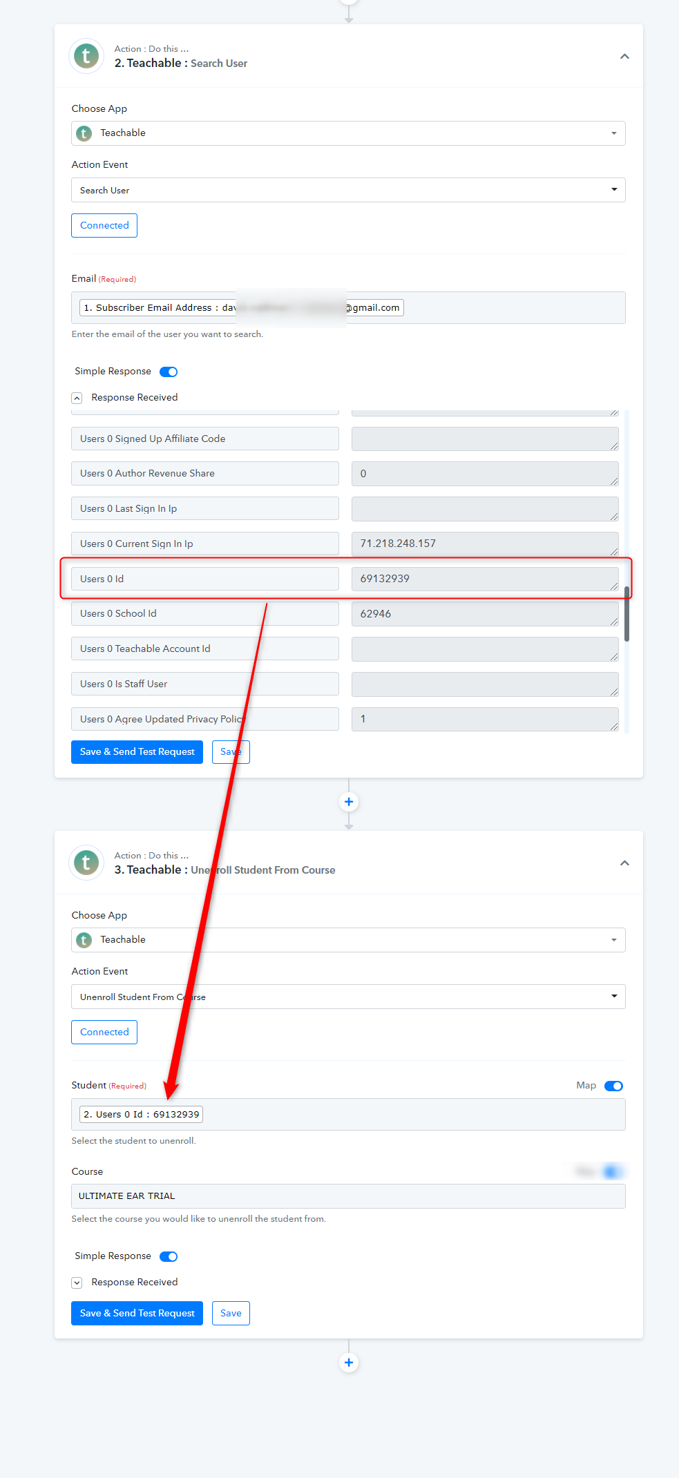

Hey @Wallimann
In the student field of the "Teachable: Unenroll Student From Course" action event, you need to pass the students' Id from the "Teachable: Search User" action steps response received. Please check out the following screenshot for a better understanding -

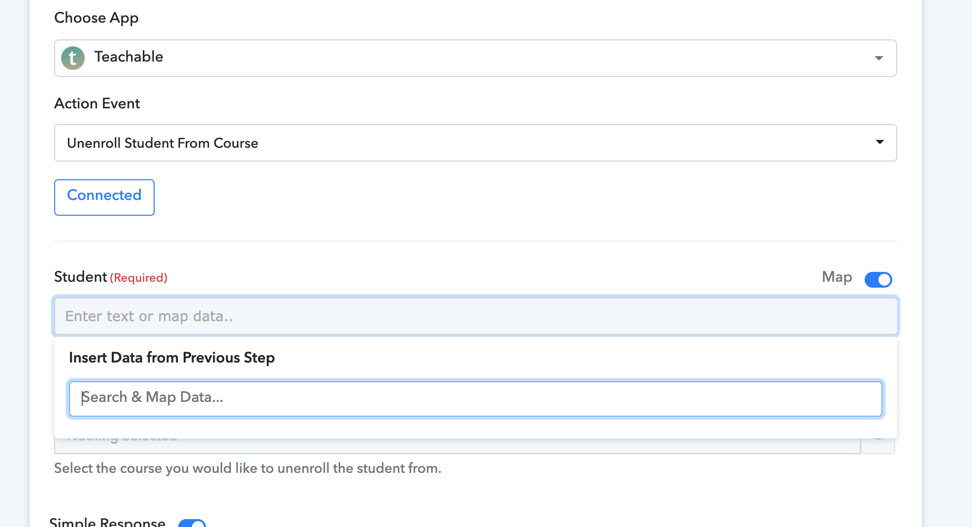

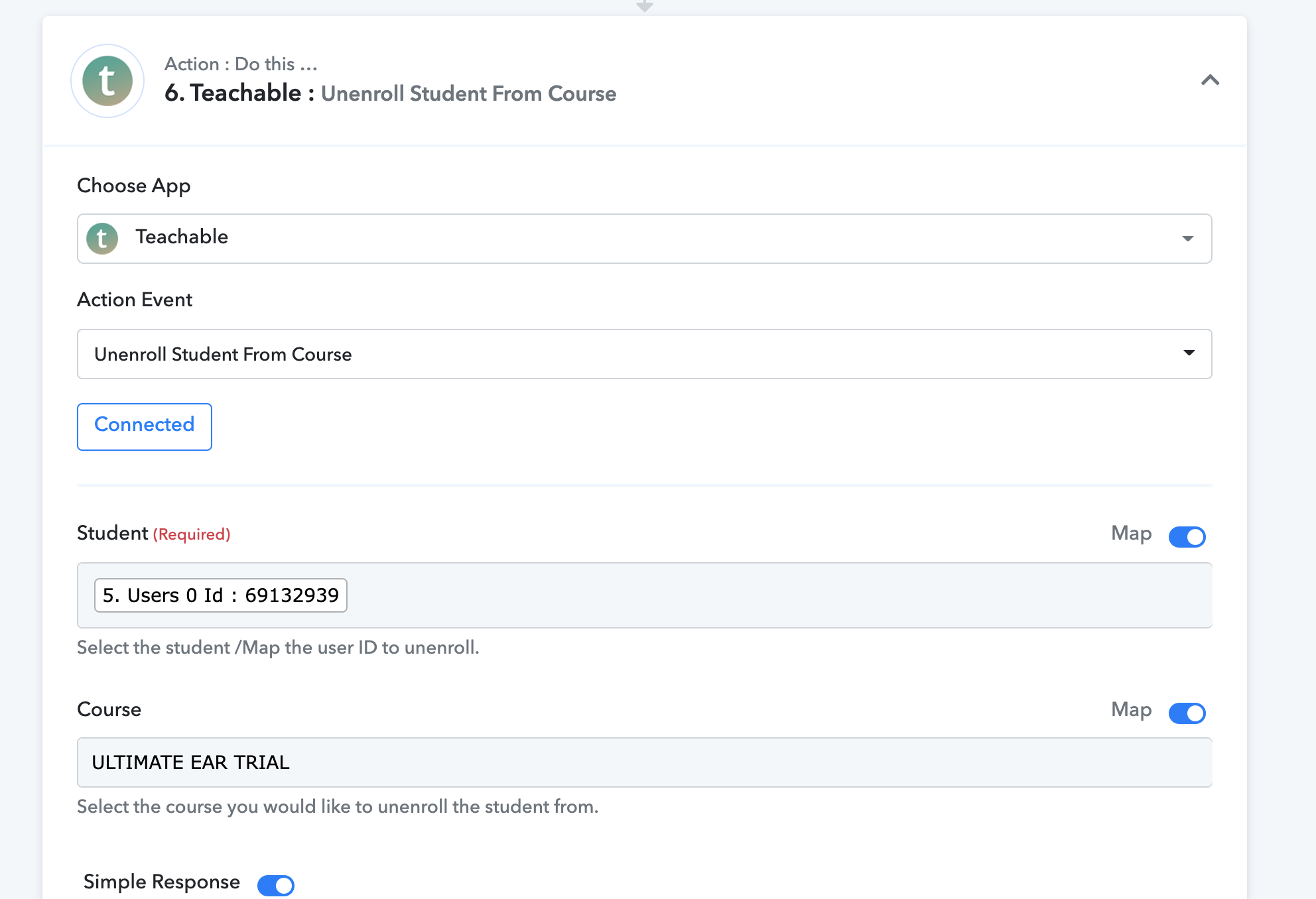

Supreme
Hey @Wallimann
We looked into your workflow and it is working fine. And you do not need to turn on the map button on the Course field and if you do you need to map/type the course Id instead of the Course-name.
Supreme
Hey @Wallimann
Please try again and make sure that the student whom you are unrolling from a course must already enroll in the course.

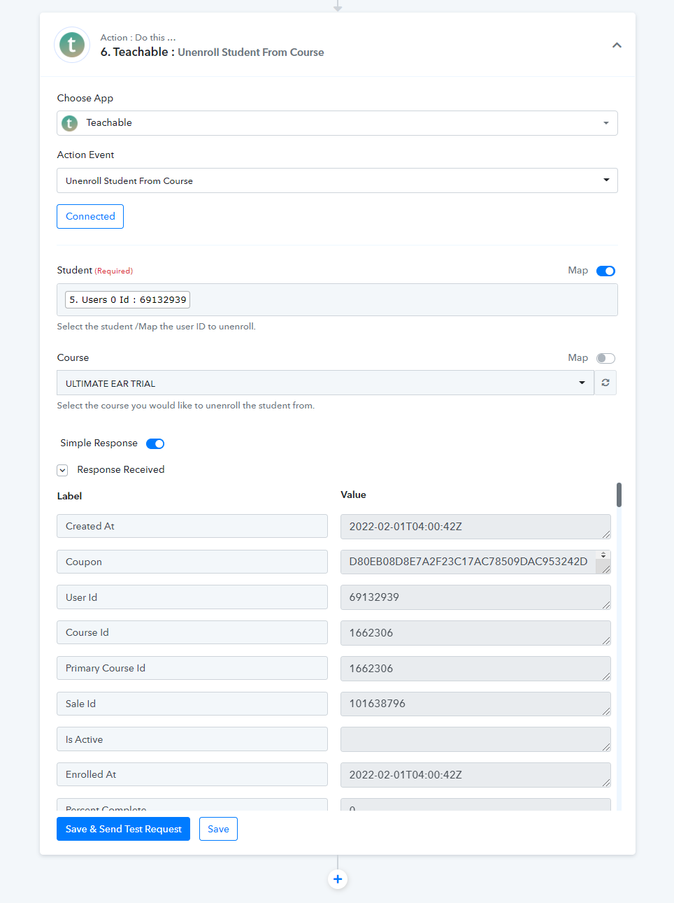

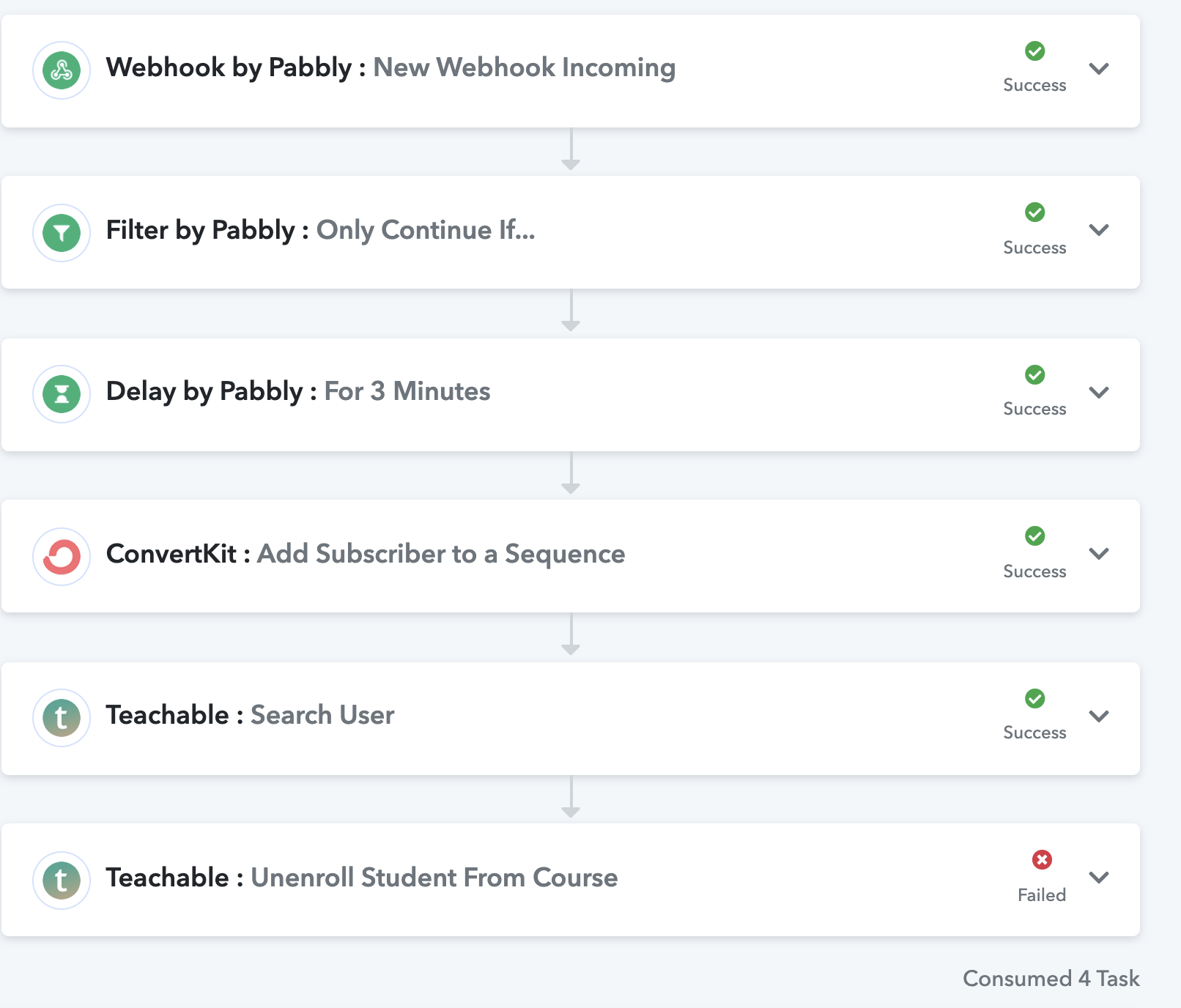

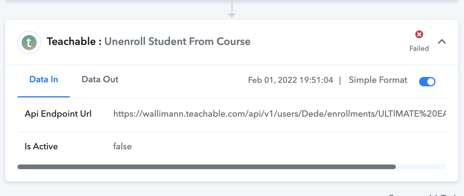

Wallimann
Hello @Supreme
I did multiple times with different test emails. Pabbly says that by ear workflow succeeded bug the course is not removed from the user account in Teachable.
I even paid an expert to try to solve this but he couldn’t fix it. I’m pretty desperate!

Supreme
Hey @Wallimann
While testing the action event we found that unrolling a student/user, you wouldn't be available to know from the course detail when they get unrolled.
You need to check them from the individual student's section. For better understanding, you can check out the following video for a better understanding -
Supreme
Hey @Wallimann
We tried the same at our end and it seems like the students are being unrolled via action step/workflow. But Teachable is not showing the unrolled students from the "Course" section and if you can check the same in the "User" section on your Teachable dashboard you can see it is unrolled.
So regarding your issue of why it is not displaying the same on the "Courses" section, you need to raise the query to the Teachable support team.
And you can also refer to the same video to them as a reference for your concern.
