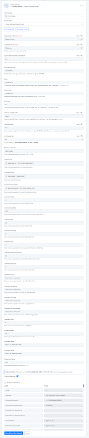

  • Created a Zap with JotForm trigger and Zohobooks "Create Estimate" action for the rental fee.
  • Added a subsequent "Update Estimate" action to include the deposit, but it overwrites everything.
How can I modify my Zap to automatically add the security deposit as a second line item to all Zohobooks estimates generated from JotForm submissions? I'm open to different approaches, including custom fields or alternative actions.

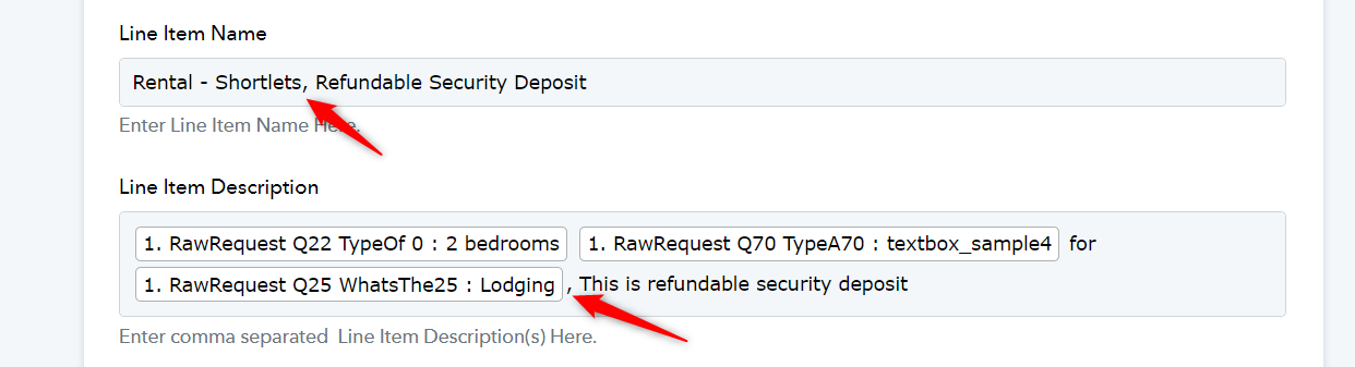

Hi @Foreal,
You can use a comma to separate two line items and enter the 'Refundable Security Deposit' as Line Item 2 in this manner.

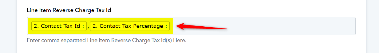

Please try clearing this entire field of Line Item Reverse Charge Tax Id and see if this fixes the issue for you.
Foreal
Thank you so much for your responses. I am still getting the same error message after clearing this Line Item Reverse Charge Tax ID.
Kindly note that i was just trying out different ideas to fix this and this is why the field was even filled. It used to be empty, meanwhile i get the same error message.

Hey @Foreal
Could you please confirm whether you have set the "Reverse Tax ID" field as required in your Zoho Books account? This field might be the reason why you are facing difficulties in creating estimates in the Zoho Books account.

We've removed the "Reference line item Tax ID" field from the action step of creating an estimate in Zoho Books. Kindly confirm from your end and inform us if it is functioning as expected.
Foreal
Hey @Foreal
Thank you for your patience.
Thank you so much.
I noticed there's a "Create Estimate (beta)". It works now.
