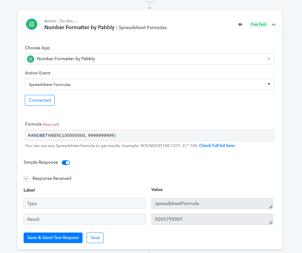

3- Then I have username and password field in MySQL that I like pabbly to generate a random I fill in the username and password with that random username and password
To generate the random password in your automation you can use "Number Formatter by Pabbly: Spreadsheet Formulas" which will pick the random number between any digits which you can map in the field of Password.

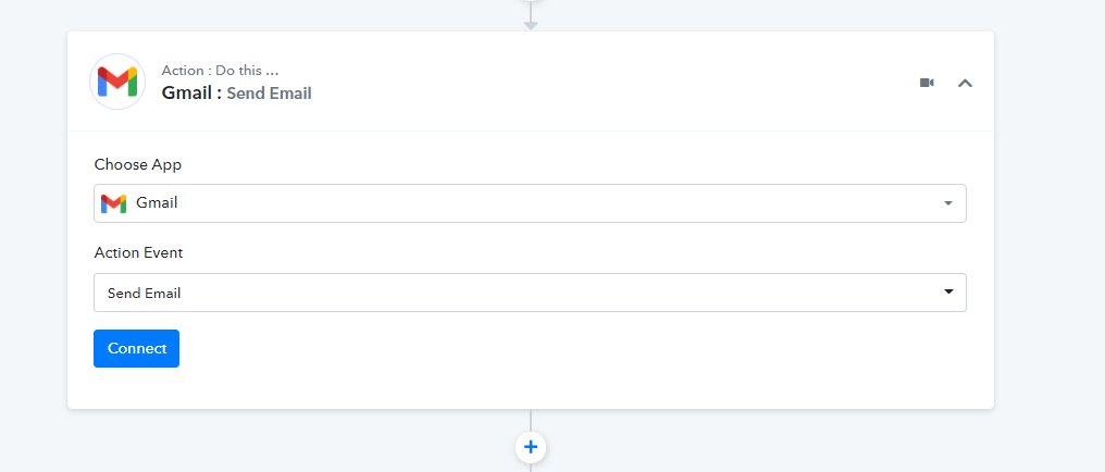

4- I like to either send email or SMS telling the customer that ordee has been processed and this is the username and password to sign into our subscription platform.
To send an email you can use the "Gmail" action step.

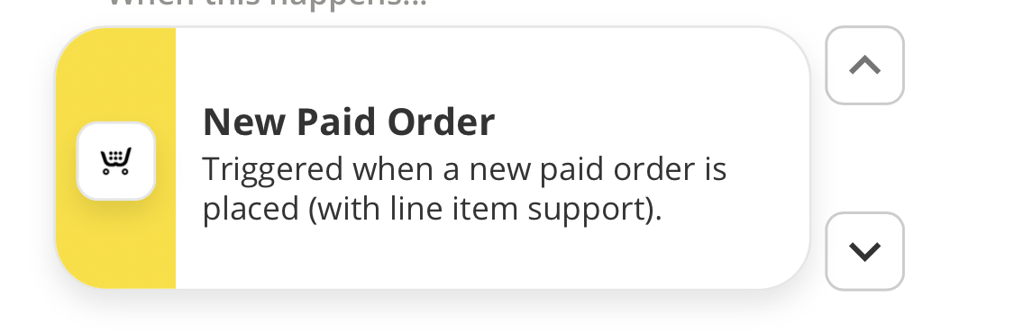

davidmajors
This is one of the ECWID event option in Zapier. Can you please add this event for Order fully paid event.

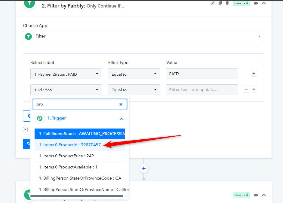

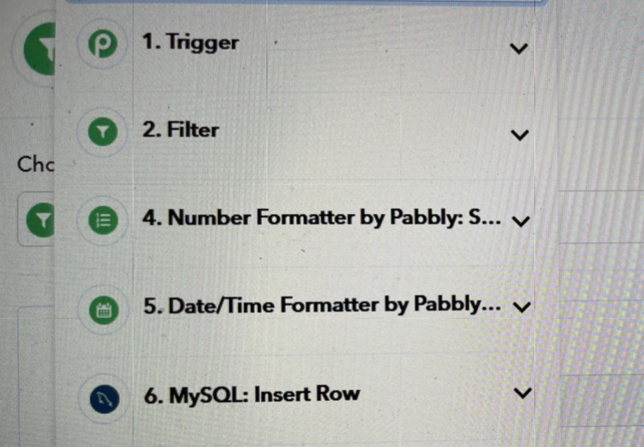

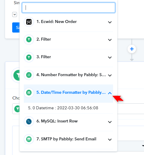

davidmajors
Hi Pabbly,
I found a glitch in Filter
When I select ECWID I can create the first filter for ecwid
Then I click + sign to create the 2nd filter for ecwid and all it gives me is order ID and no other fields or even an option for ecwid.
See picture
So I ended up making another filter separately.
Please see pictures.
I was able to connect ECWID to MYSQL and also send Confirmation using SMTP to the customer. The only issue I am facing is automating the status to delivered for ecwid to Delivered.

Supreme
Hey @davidmajors
The filter action step is picking up all the responses from all the action steps.
And regarding your cocnern, we are checking the Ecwids' API documentation for "Update Order". If it is available on their documentation and possible to implement on the platform we will add it up.
davidmajors
Only picks up ECWID on the first filter for example in the filter I defined if awaiting payment EQUALS to PAID
Then I click on the +sign to add another filter and it dies t give ECWID in drop down list. Only shows up on the first row of the condition and not the 2nd condition.
So I had to create a separate Filter by pabbly action in order to define the 2nd condition which was to Filter Product ID
Please advise .
Supreme
Hey @davidmajors
The Filter action step is shoeing the field which you are looking for and by clicking on the + button you are actually creating an AND condition inside the filter which will check for both the condition to process your workflow.
