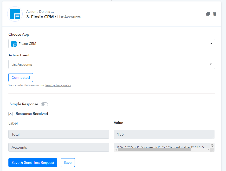

Active member
In my step 3 I got a field that stated: Total = 155
Before the router step need to create a field that counts
Router step 3 would then be if count =155 then send webhook
