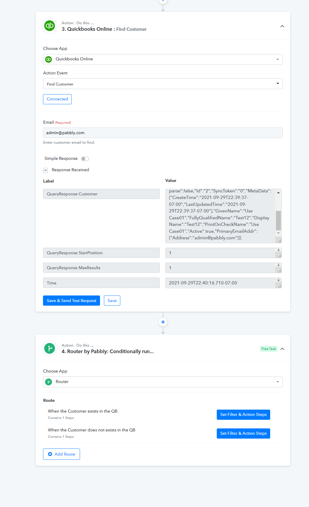

Hey @twshouston
We have created a similar kind of use case on the QuickBooksOnline on the basis of the presence of a customer in the account, so when the "Find a Customer" action event found a customer you can "Update the Customer " inside the router condition, or else you can create the customer when the customer is not present in you QuickBooks account.
Here is the workflow where you can copy similar steps and the router condition.
Cheers!

Hey @twshouston
Cheers!

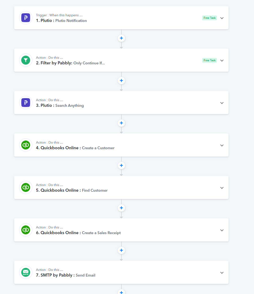

Thanks a bunch. I did create something similar to what you have earlier but for some reason the workflow would not process my router.
I'll try again with your version. THANK YOU!!!
This is the workflow that I came up with initially. I'll modify the last few steps to incorporate your router logic.

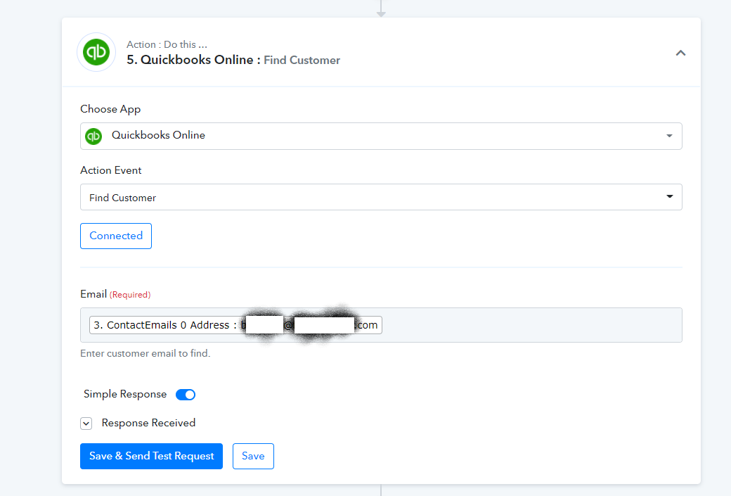

Have you tried a simple query like this one?
After connecting via the wizard, as long as my syntax is correct, I can run queries.
Replace the "3. ContactEmails 0..." section with an email address that you know to exist in your QBO environment.

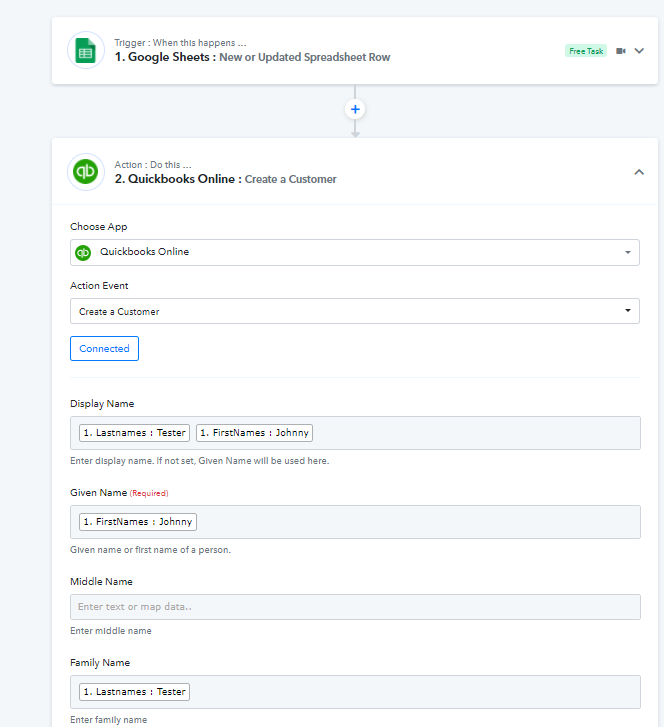

What I was trying to do was just create an invoice from a google sheet entry ... so I just went 'create invoice' and had all the information in the google sheet row... so are you saying I should a find customer first, and then create an invoice?

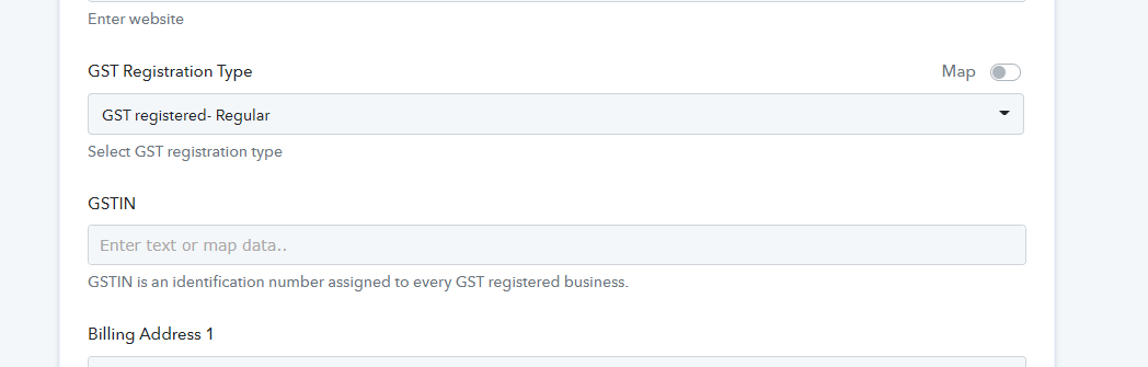

The other one I am trying to do is from a google sheet just create a customer... so I have all the data, it imports from a google sheet fine, but then when I try to create a customer I get a 6000 error. I don't imagine that in that one I should need a find customer routine at all?
twshouston

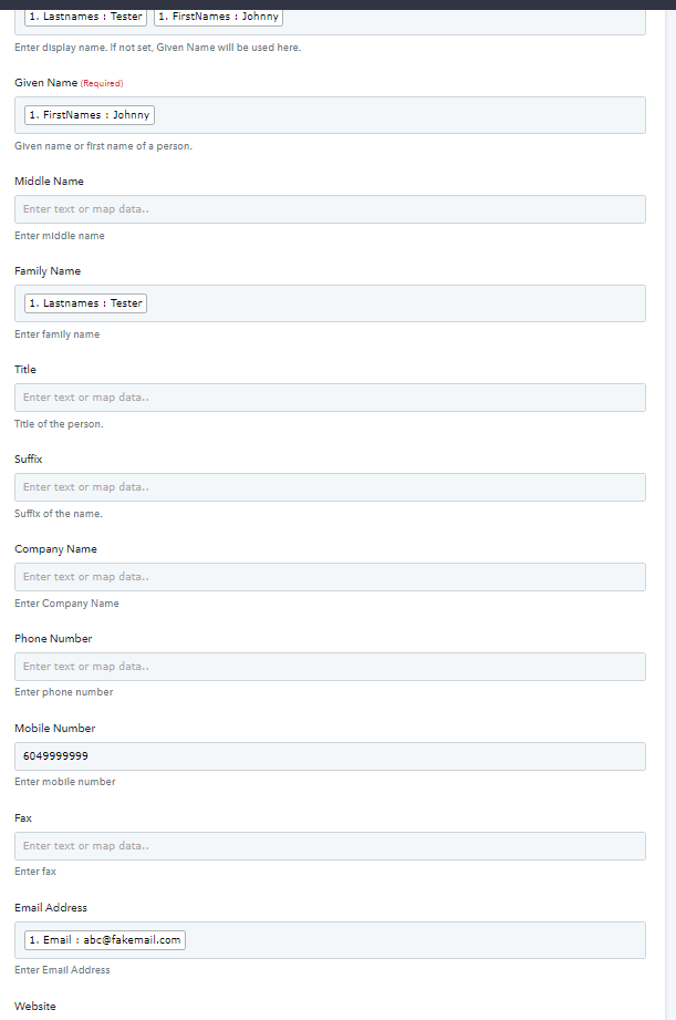

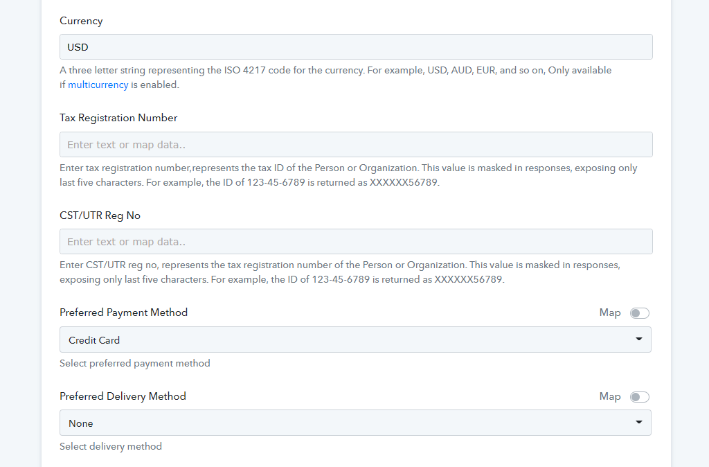

For create customer, you'll need this if you don't have it already
I added postal code ( needed for tax calculation )

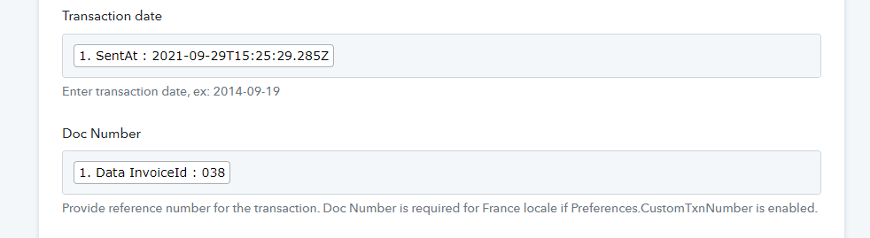

Instead of create invoice create " Sales Receipt"
Fields you need
Customer
(customer ID)
Email
Billing Address Country (USA) for me
Deposit To
Transaction date
Doc Number
