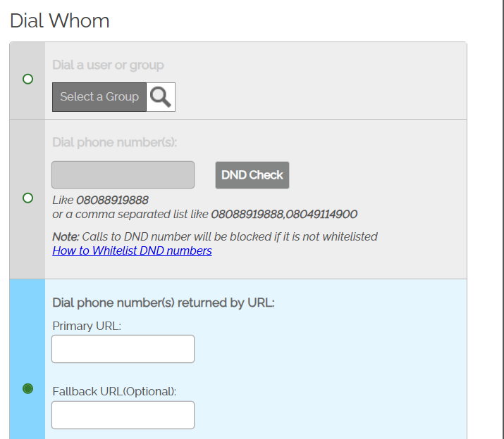

I am trying to figure out if Pabbly can be used to return a particular response when called from within Exotel call flow applet. Please look at the image below.

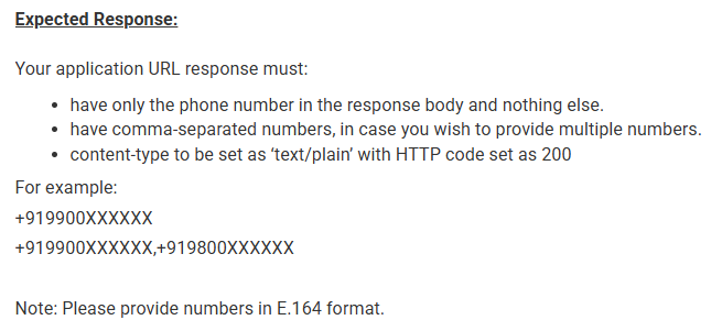

What I am looking for is to "trigger or call" a flow in Pabbly by keying in the (Primary) URL in Exotel applet as mentioned in above image. And then be able to lookup a Gsheet through an action and return back with a particular phone number in the same URL to Exotel. Here's Exotel's API Doc regarding the same https://support.exotel.com/support/...088074-working-with-connect-applet-dial-whom-

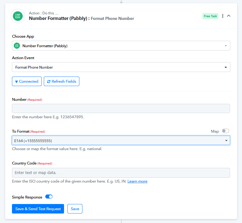

Hello @sunstorm,
You can use the Number Format: Format Phone Number action to convert the phone number into the E.164 format. Please try this step to obtain the required format. If you encounter any further issues, feel free to reach out, and we’ll be happy to assist you.

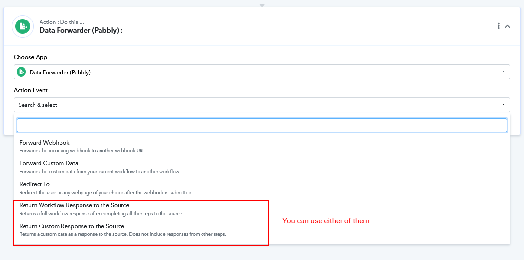

Hello @sunstorm,
You can use the Data Forwarder feature in Pabbly Connect to forward the data back to the source. This should allow you to send the formatted number as a response to the incoming trigger (webhook URL).
Please try this and let us know if it works for you.
