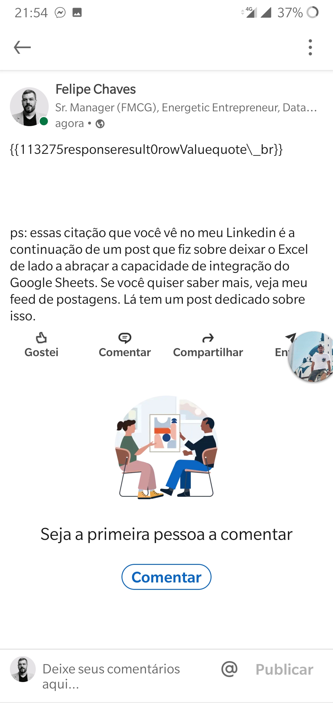

Connected to my workflow using my mobile phone, re-authorized/connected LinkedIn with the workflow, ran every step of it and went to LinkedIn to check the result.
What was supposed to be a Quote coming from a google sheet was a string, I assume, related to the workflow variable.
Note the 1st line bellow the picture, my picture.

Hey Felipe,
Just checked your workflow and found that, the Lookup Value that you mapped in the Google Sheets Lookup step is not valid, please check the attached screenshot of your workflow.
Kindly add proper value that to be looked up in the sheet to generate the response and then, map the result in the next step i.e. in LinkedIn.
Hope that will work.

Apart from bug#2 the workflow works fine on Desktop. The bug here is exact that you found. After running it on mobile it delivers the wrong output.

Naveen, If the workflow did not got broken, after loosing LinkedIn authentication by itself, I would not try to restore it on my mobile phone. Anyway, this is not the issue I'm reporting. The problem is having a workflow broken, I mean it because it delivered the wrong post on my LinkedIn, simply because I ran it on my cell phone. It's wrong. I'm reporting so you can fix it and not tell men that I should not poke on my workflows if they're running.

Revisiting the post here. Just to state that the links were right and working and got broken when I used my mobile phone to solve the lost authentication. Reinforcing this because I'm sure that there is a larger problem here.

Could you please tell me the steps that you are performing with the mobile, I would like to reproduce the same or let me know if we can have a short meeting over this to solve your issues.
What will be the best time for the meeting and all, please send the meeting link and details at [email protected]
