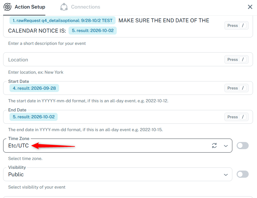

Pabbly Support โ€” Reply ยท
Thank you for the confirmation.
Please change the timezone in the Google Calendar action step to UTC, save the step, and check if that resolves the issue.

Lauren Pigtails Caparso โ€” Reply ยท
still coming up a day short. i changed all time conversions and the gcal step to utc
We only needed the timezone in the Google Calendar action step changed for testing. We have reverted all the other timezone changes, except for the Google Calendar one.
Thank you for sharing the screenshot. Could you please specify the Start and End dates you submitted in the form so we can make further adjustments?

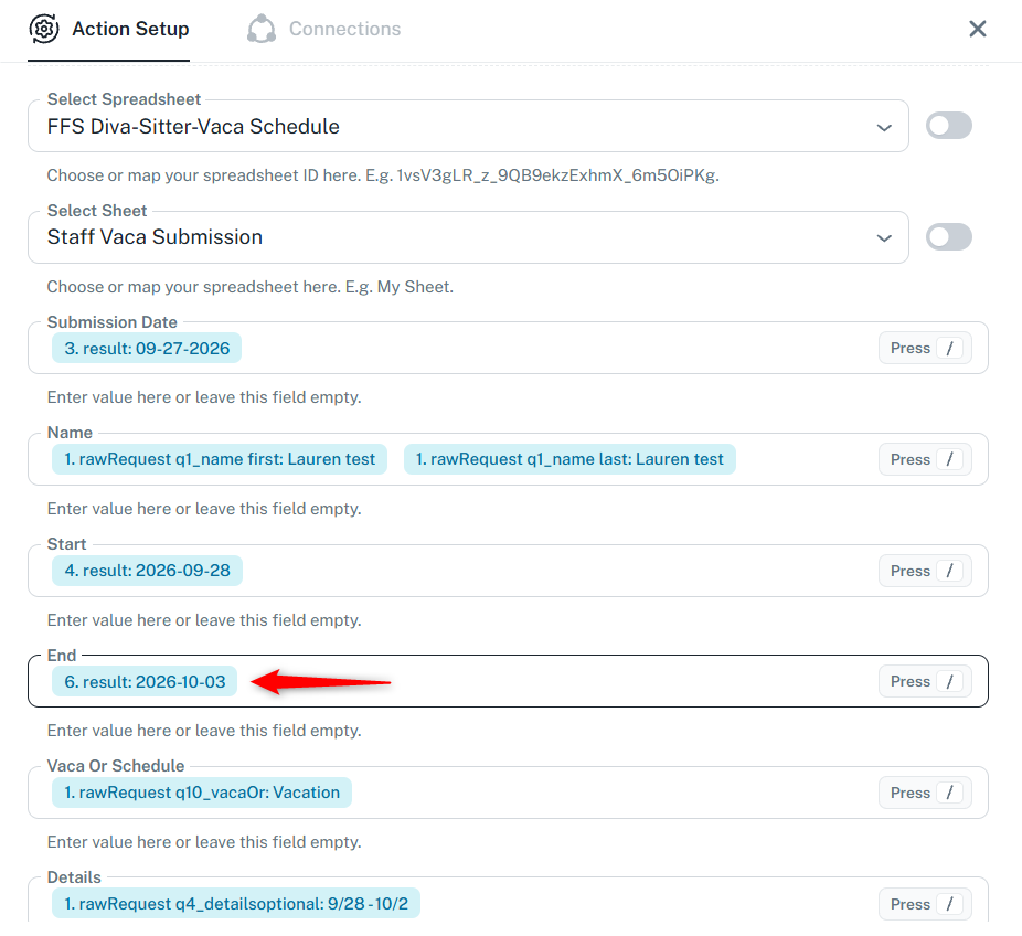

9/28 start and 10/2 end
We have added a Date/Time Formatter to your workflow, which will allow you to add one day to the end date before passing it to Google Calendar. Please test the workflow and see if this resolves the issue.

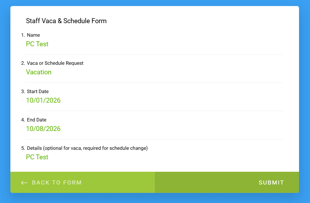

We have made a test submission with October 1 as the start date and October 8 as the end date. Could you please check the same event in your Google Calendar?
Arshil Ahmad
๐ŸŒ Pabbly.com
this one worked! so is it all set now?
