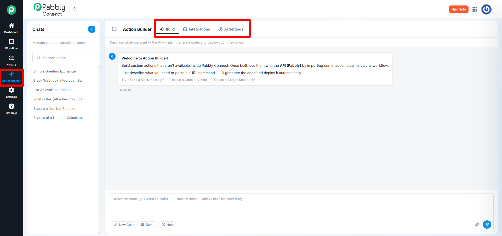

Step 1: Access Action Builder
1. Log in to your Pabbly Connect account.
2. In the left sidebar, click on Action Builder.
3. You will see the main dashboard with three tabs:
- Build -- Chat with AI to create integrations
- Integrations -- View and manage your deployed integrations
- AI Settings -- Configure your AI provider

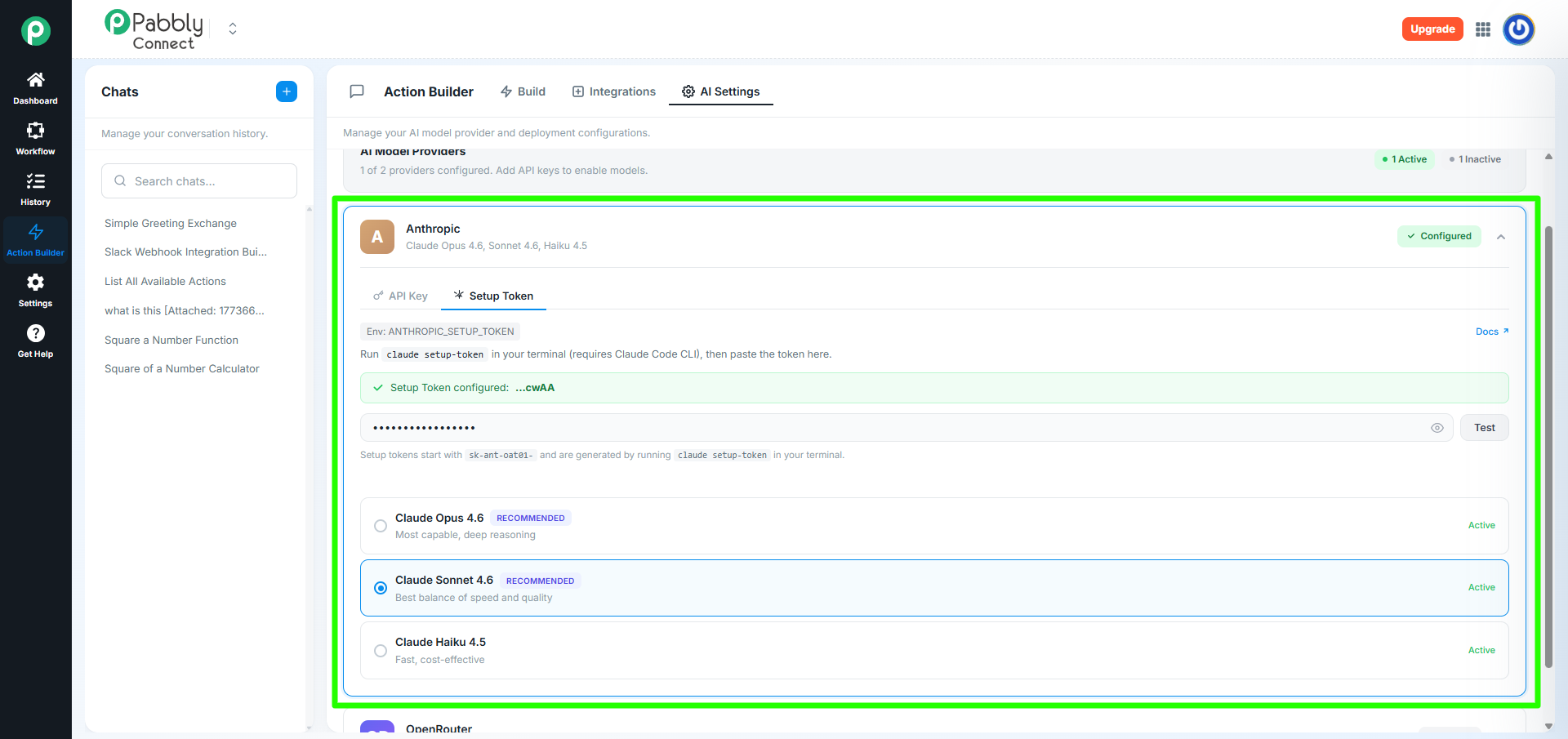

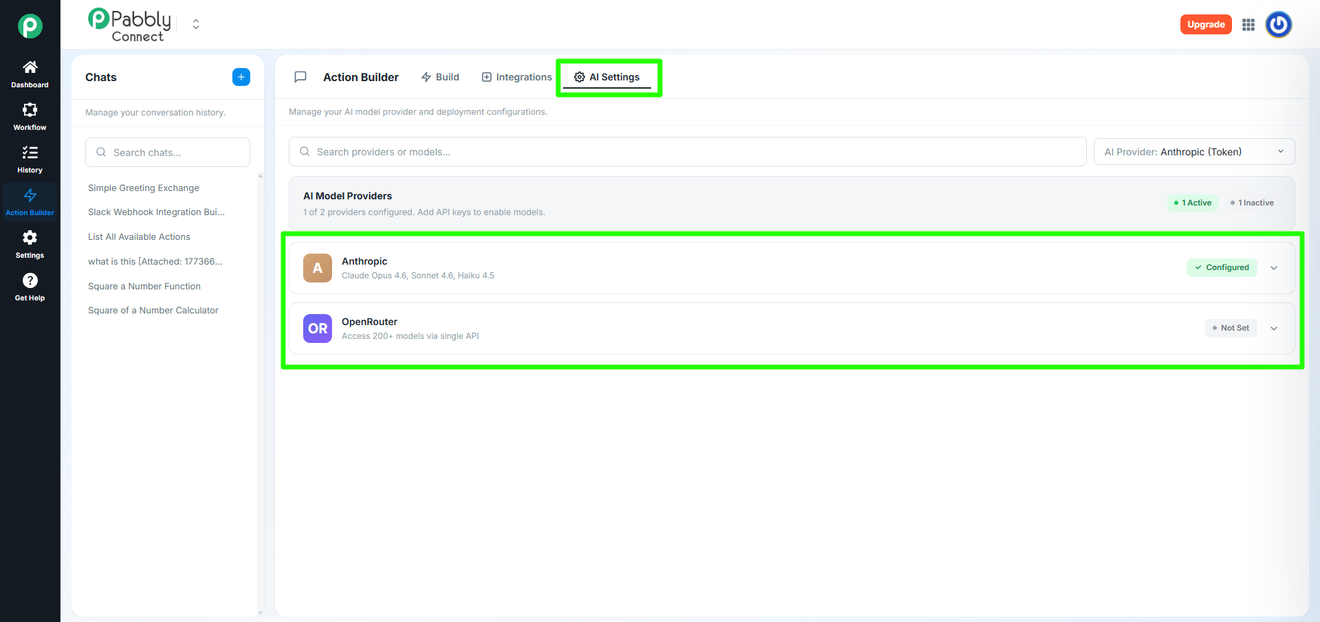

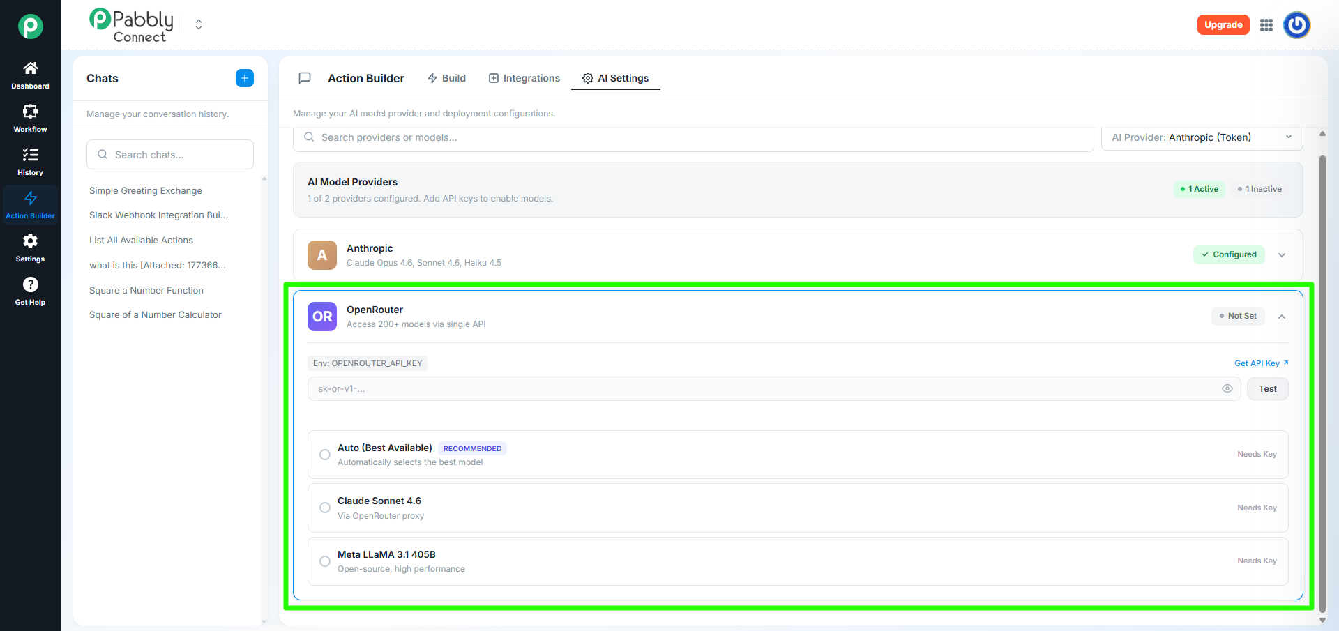

Step 2: Configure AI Settings (First-Time Only)
Before creating your first integration, you need to set up an AI provider.
1. Click the AI Settings tab.
2. You will see two AI provider options:
- Anthropic (Recommended) -- Claude Opus 4.6, Sonnet 4.6, Haiku 4.5
- OpenRouter -- Access 200+ models via a single API
3. Expand the Anthropic card by clicking on it.
4. Choose your authentication method:
- API Key -- Get your key from console.anthropic.com. It starts with sk-ant-api03-...
- Setup Token -- Run claude setup-token in your terminal and paste the generated token.
5. Paste your key/token in the input field.
6. Click Test to verify the key works.
7. Select your preferred AI model (Claude Sonnet 4.6 is recommended).
Important: Your API key is stored securely and never exposed in the generated code or logs.

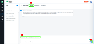

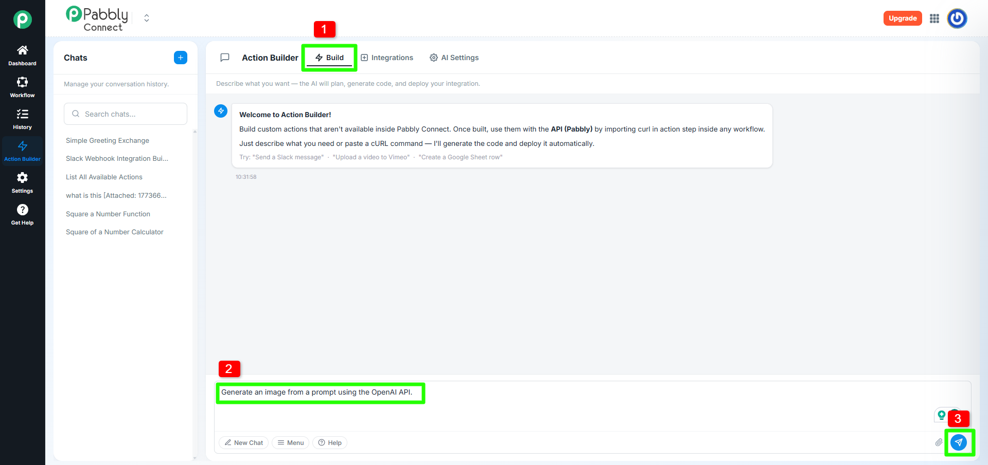

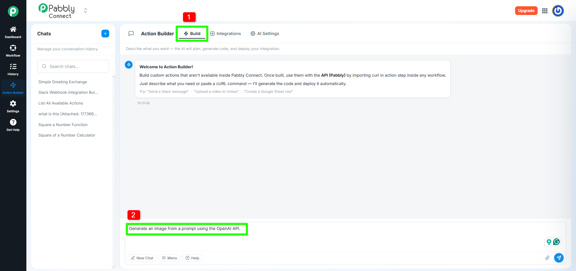

Step 3: Describe What You Want to Build
1. Go to the Build tab.
2. In the chat input at the bottom, describe what you want to build. Be specific about:
- Which external API or service to use
- What action(s) the integration should perform
- What input parameters it needs
Example prompts:
  • "Send a Slack message to a channel using a webhook URL"
  • "Generate an image from a text prompt using OpenAI DALL-E 3"
  • "Create a new row in Google Sheets using the Google Sheets API"
  • "Send an SMS using Twilio API"
  • "Upload a video to Vimeo from a URL"
3. Press Enter to send your message.

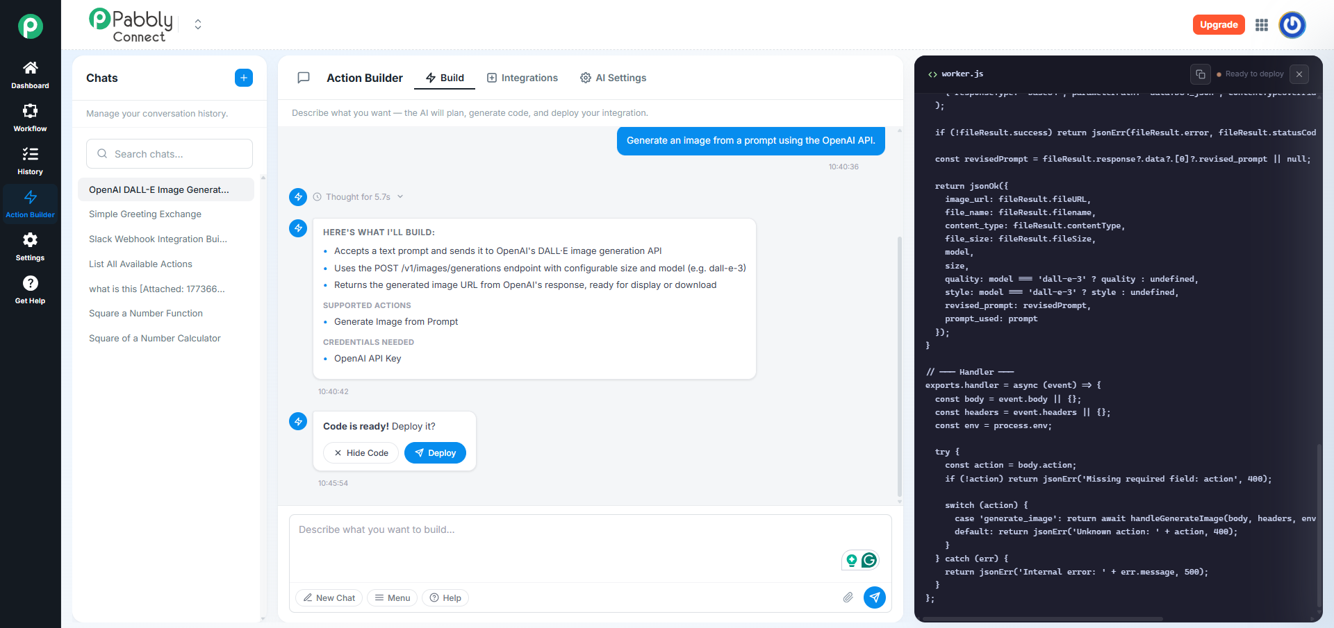

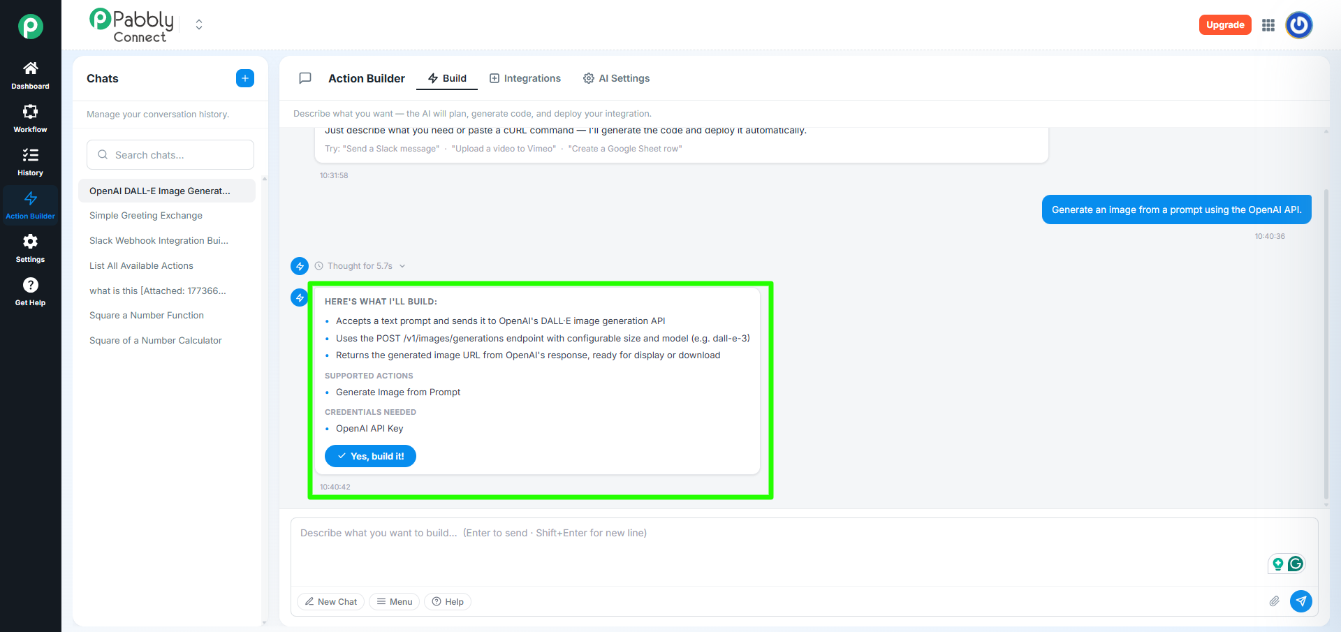

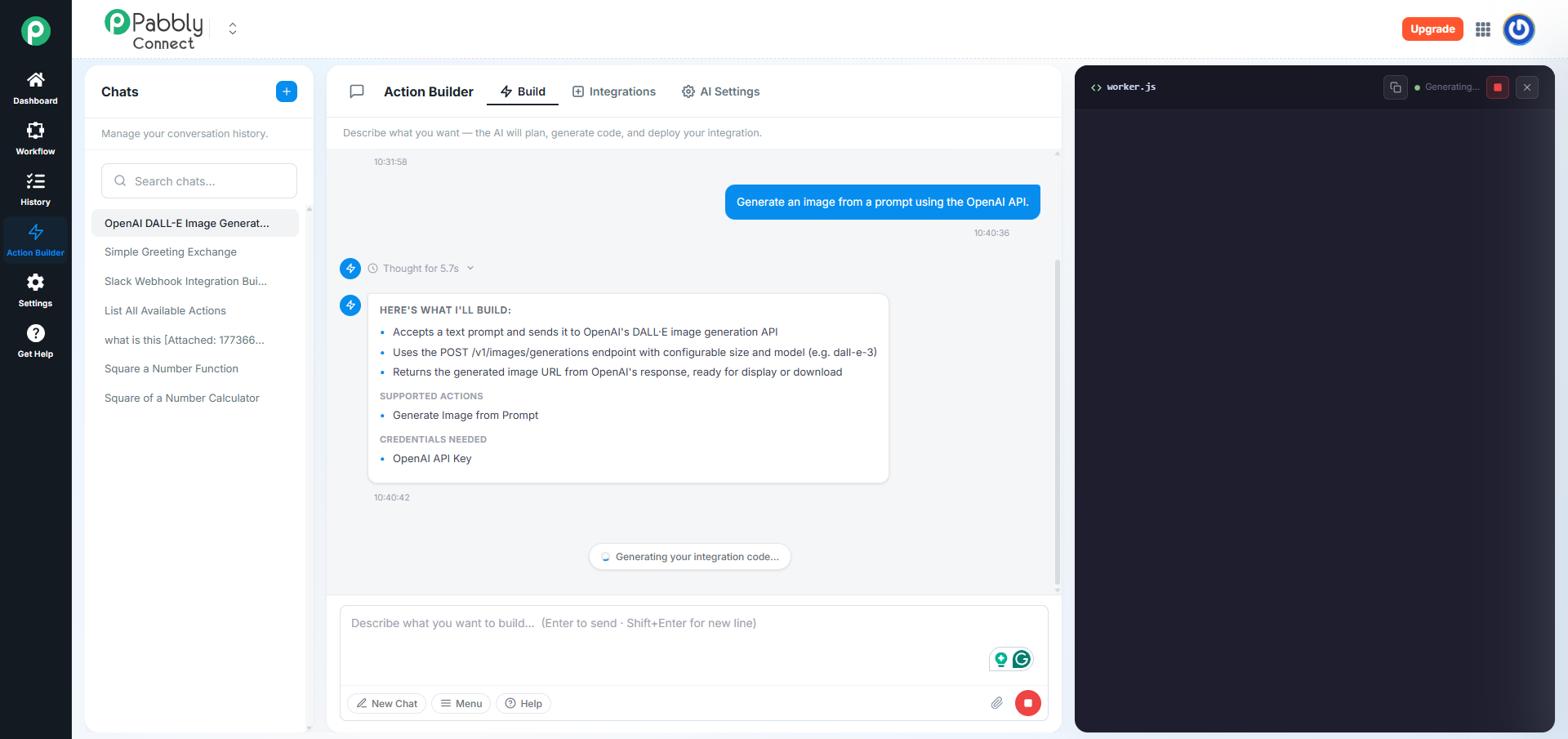

Step 4: Review the AI Plan
After you send your description, the AI will present a plan card showing:
  • What it will build -- 2-3 bullet points describing the integration
  • Supported actions -- The API actions it will create
  • Credentials needed -- API keys, tokens, or webhook URLs required
If the plan looks correct:
Click Yes, build it! to proceed.
If you want changes:
Type your modification in the chat (e.g., "also add a delete action").

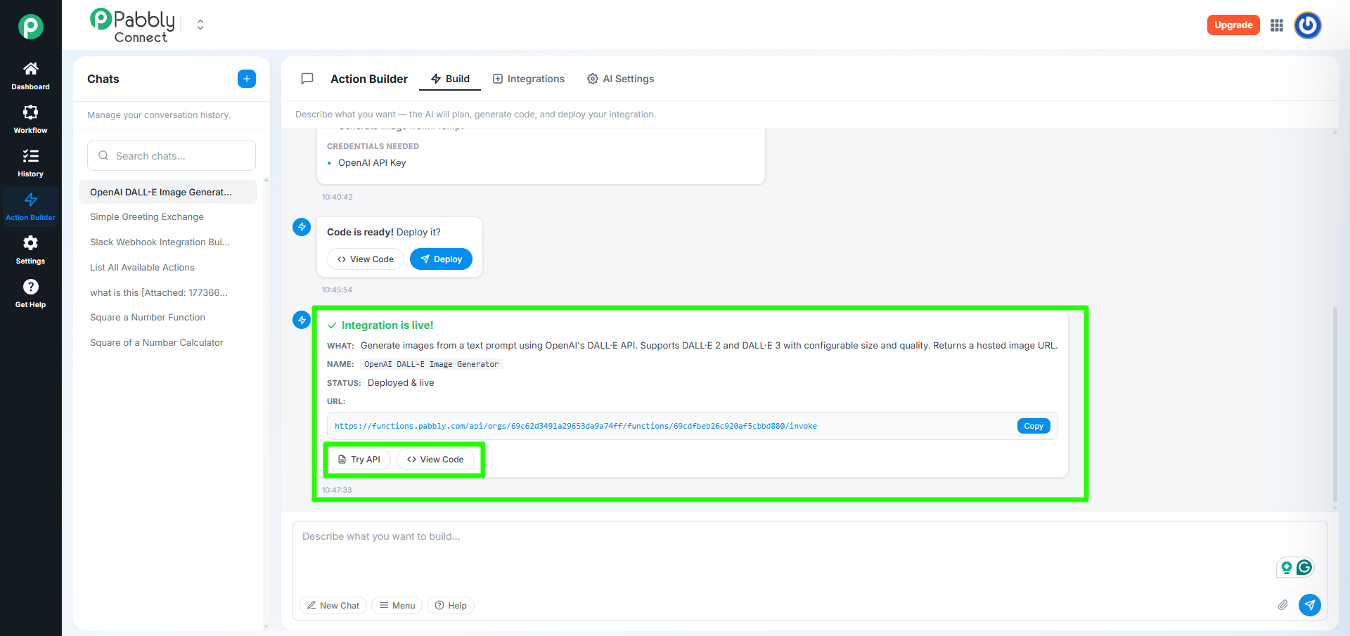

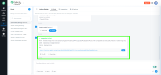

Step 5: Code Generation & Deployment
Once you approve the plan:
1. The AI generates the code in real-time -- you can watch it stream in the code panel.

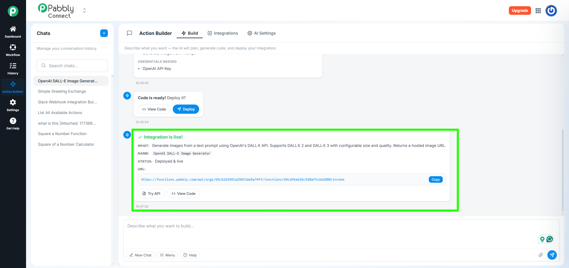

2. Click Deploy to deploy the integration to Pabbly Functions.
3. You'll see the "Integration is live!" success card with:
- The invoke URL (your API endpoint)
- Try API button to test it immediately
- View Code button to see the generated code

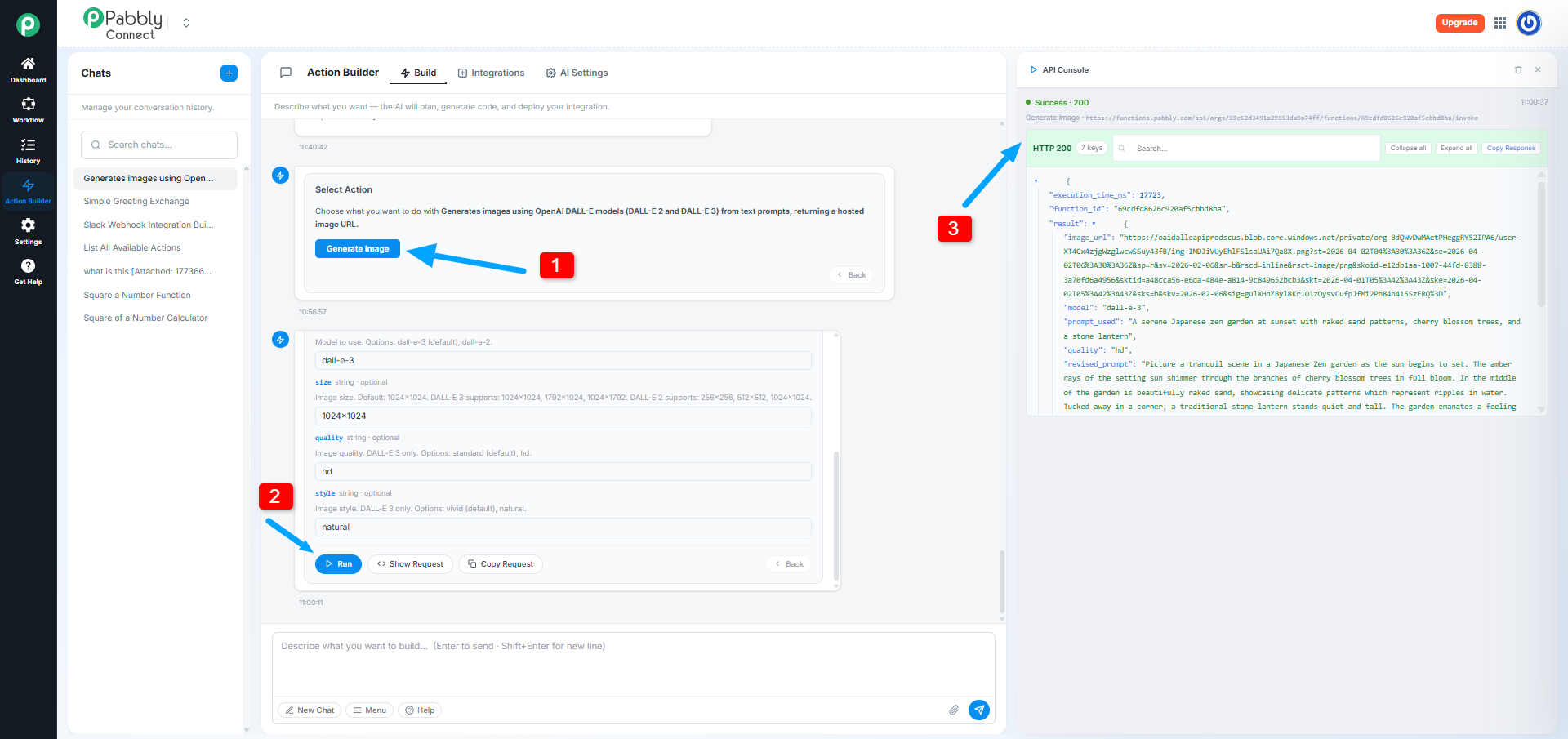

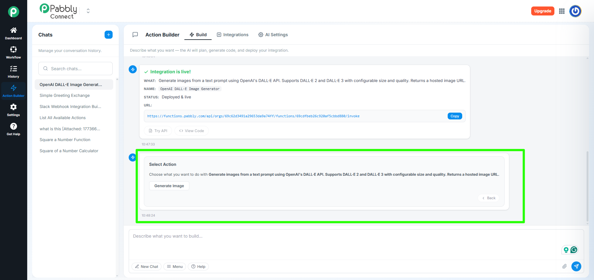

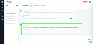

Step 6: Test Your Integration
1. Click the Try API button on the success card.
2. Select which action to test.
3. Fill in the required parameters.
4. Add your credential headers (API keys, tokens).
5. Click Run to send a test request.
6. The API Console panel opens.
7. The response appears showing the status code and JSON data.

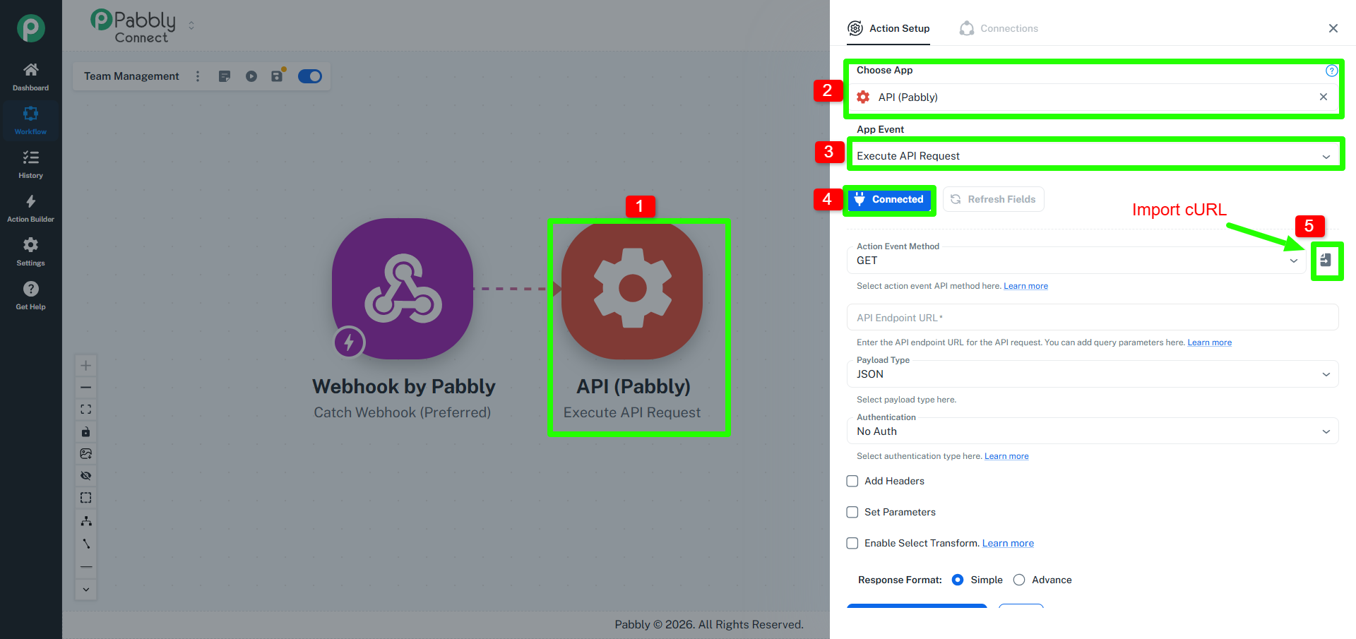

Step 7: Use in Pabbly Connect Workflow
Now that your integration is live, use it as a custom action step:
1. In your workflow, add an API / Webhook by Pabbly action step (or HTTP Request / cURL).
2. Set the method to POST.
3. Paste your integration's invoke URL.
4. Set Content-Type: application/json header.
5. Add credential headers (e.g., X-Api-Key: your_key).
6. Set the body as JSON:
JSON:
  "action": "your_action_name",
  "param1": "value from previous step",
  "param2": "another value",
  "invoked_by": {
    "name": "Pabbly Connect",
    "email": "[email protected]"
7. Map the fields from previous workflow steps.
