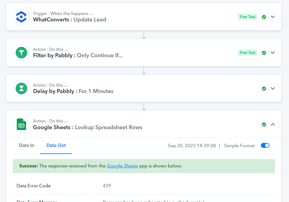

I don't understand when getting this email there is no way I'm doing more than "500 requests per 100 seconds per project and 100 requests per 100 seconds per user"

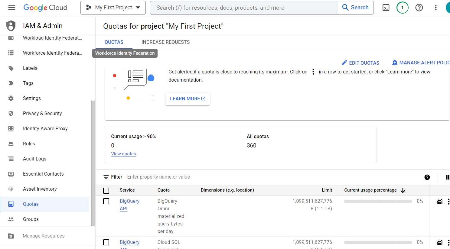

I've check my Google Cloud API quota usage and I can't find anything, it all says zero, so not sure where exactly to check

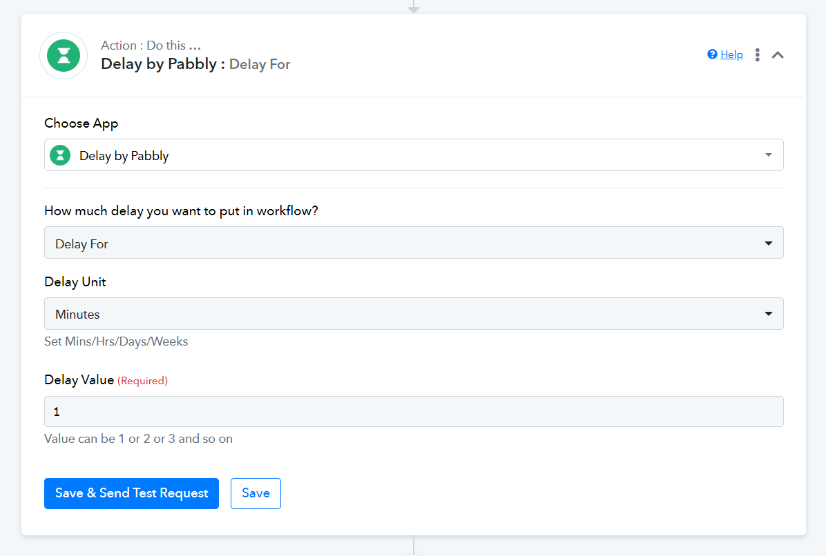

Could you please try adding a 1-minute delay after the Filter step and see if this resolves the issue for you?
Yes I did try that since I read it on another post, it did not work and still got the error.
Why would this even help though? It's not like it's adding a delay between Google steps? Maybe it would be better to put a delay between the google steps? So it looks up the value on the sheet, then pause, then changes the value on the sheet.

But the workflows with "Google Sheets : Lookup Spreadsheet Rows" is where that step breaks due to "resources exhausted"

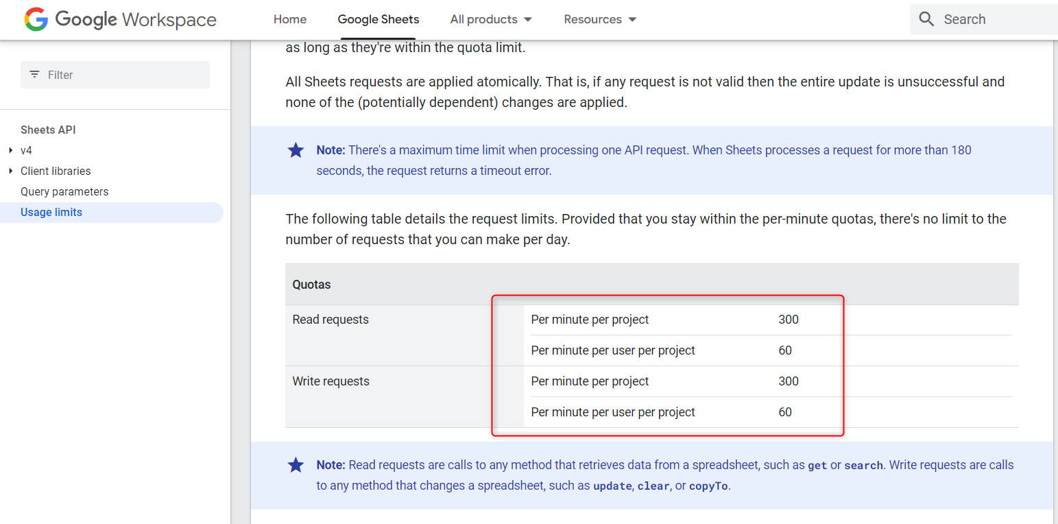

I had a discussion with the technical team, and they informed me that, based on your task history, we can see that you have used the Google Sheets action step in many of your workflows. Each workflow is being executed seconds apart from each other, and because of this, you are encountering resource-exhausted issues.
