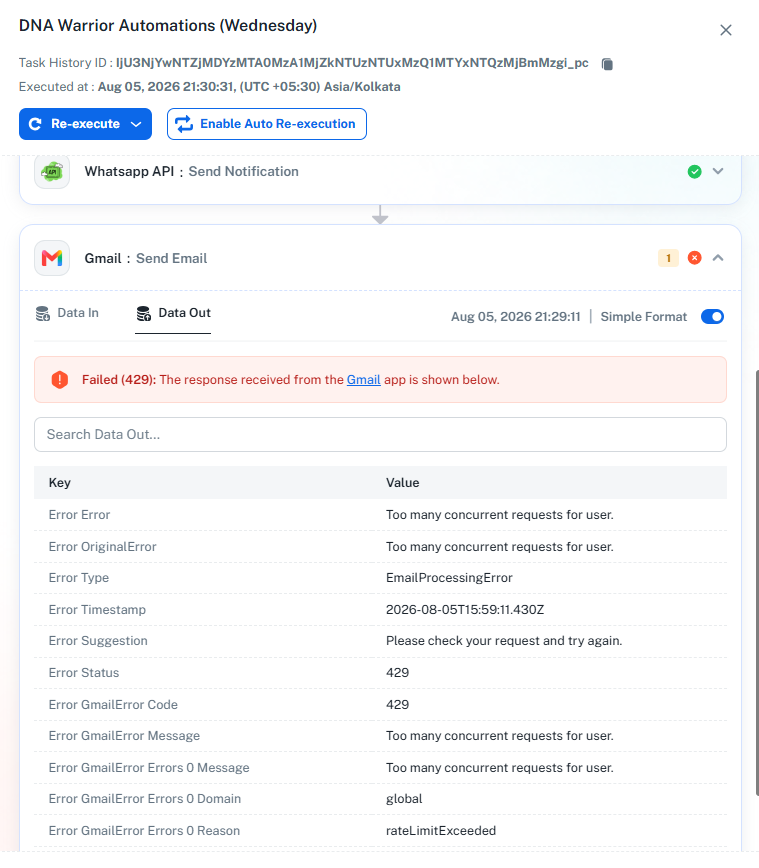

You can check it has iteration issue
WellnessVibe LLP โ€” Reply ยท
Some of my Iteration Steps is not working
Pabbly Support โ€” Reply ยท
Thank you for your response.
We re-inspected your execution logs in detail for Task History ID IjU3NjYwNTZjMDYzMTA0MzA1MjZkNTUzNTUxMzQ1MTYxNTQzMjBmMzgi_pc.
The Iterator step ran successfully and processed 945 iterations. However, the Gmail step failed due to an error in your Gmail step:
  • Error: 429 - Too many concurrent requests for user / rateLimitExceeded
  • Cause: Gmail has strict rate limits on how many emails can be sent concurrently within a short timeframe. When sending emails rapidly inside a high-volume loop, Gmail blocks further requests, which causes the workflow execution to stop at that iteration.
Because the Gmail step failed due to rate limits, the execution stopped, which is why the subsequent iterations were not completed and messages beyond row 945 were skipped..
Recommended Fix:
To prevent Gmail rate limiting from stopping your Iterator workflow:
  1. Increase the Delay duration: Increase the time in your Delay by Pabbly step (placed before or after the Gmail step inside the Iterator loop) to spread out the email sending rate.
  2. Use Pabbly Email Marketing or SMTP: For sending bulk/scheduled emails across hundreds of rows, we recommend using Email by Pabbly or an SMTP service (such as Amazon SES, SendGrid, etc.) rather than a standard Gmail/Google Workspace account, as Gmail is not designed for high-frequency automated batch emailing.
Once you adjust the delay or switch the email action, you can re-execute the workflow.
