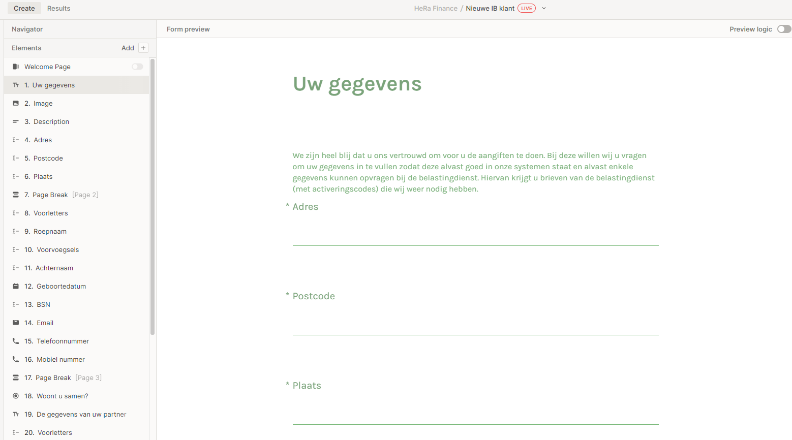

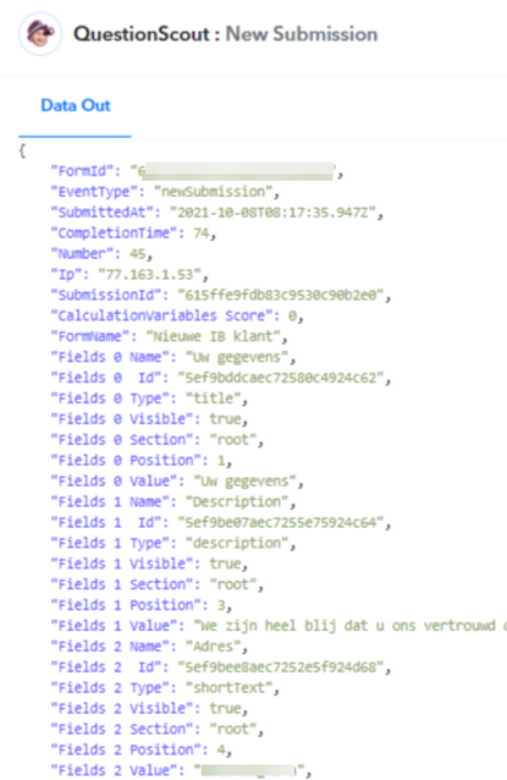

I enclose a form of mine and the payload what I receive in Pabbly.
Each form start with "Field 0", Questionscout submits 7 entries for each element inside the form, such as id but also the value.
So if I wnt to map "Adres" of the form inside Pabbly, I can that "Adres" is equal to the values inside "Field 2"of the payload. To match it inside Pabbly I need to match the field "Fields 2 Value".
I hope this helps.
