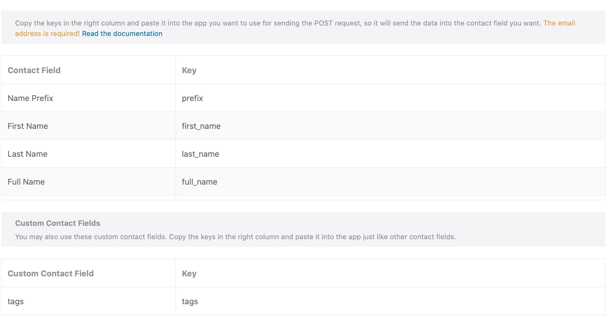

But I found out a way. Im mentioning it here for others to benefit.
1. Create a custom field called tags
2. create incoming webhooks and make sure the custom field is displayed in the bottom (See attached)
3. In Pabbly, you can add new row and give same field name and map the tag.

Yes, I fig out the way to do it using price of the product. Thanks.
Okay I will check with FluentCRM.
Can you add the screenshot of your mapping in Pabbly Connect?
