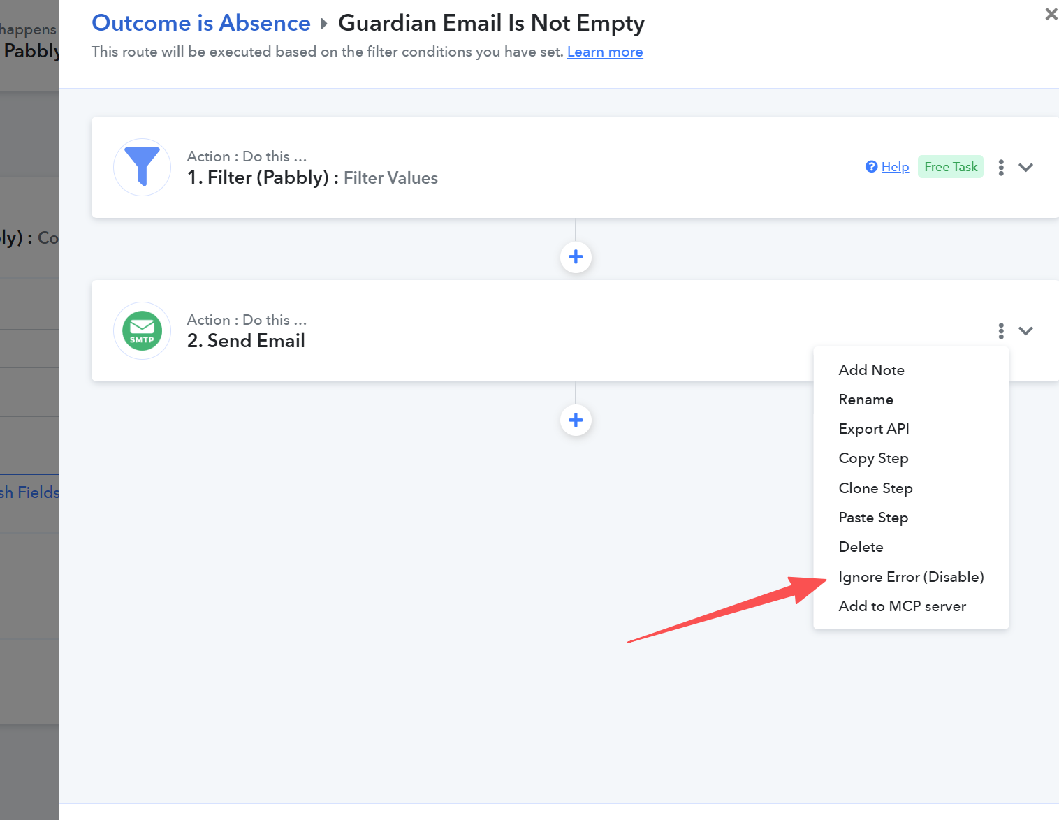

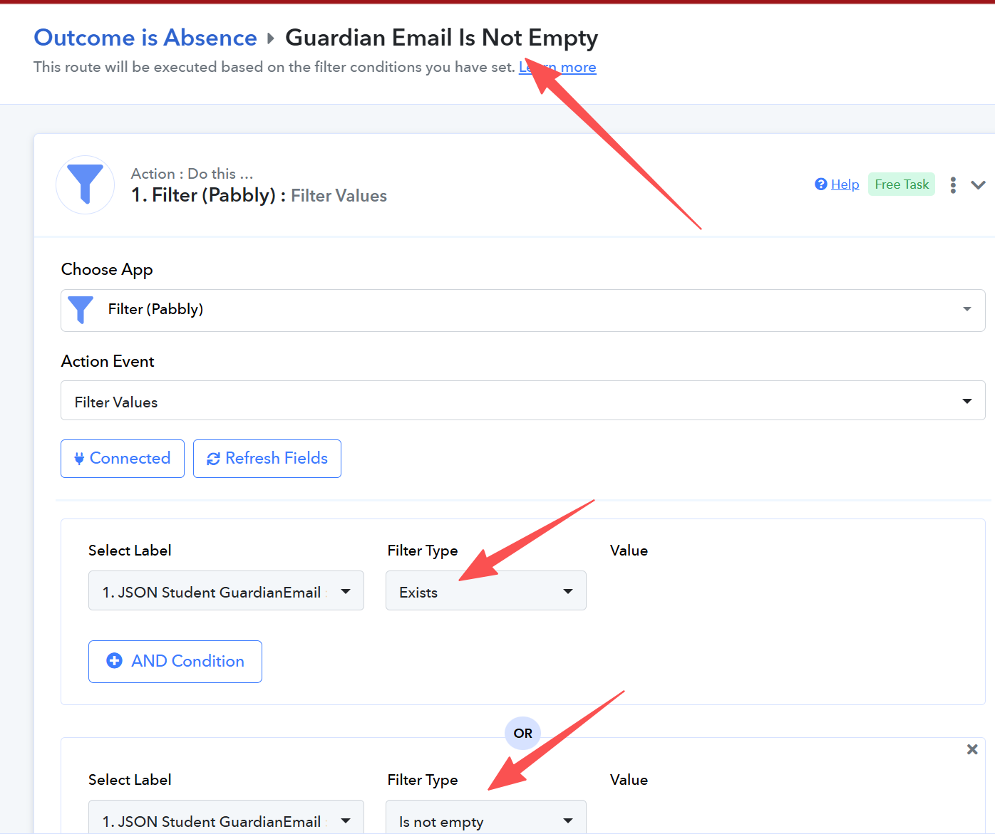

1. We have set a Router condition only execute if Email is Not Empty or Exist. BUT the flow still enacts and cause an error when sending email. Please check?
AND

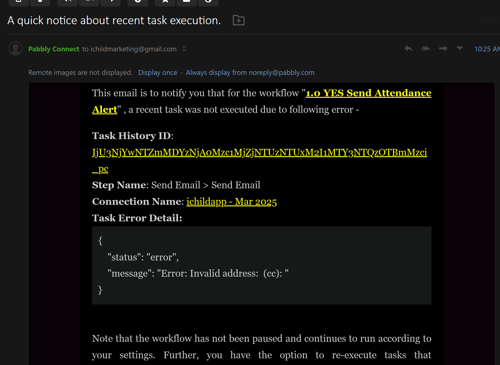

2. Why does the system still send an error email when we have enabled "Ignore Error (Enabled)" . Please check on this else we will be getting so many redundant email alerts.

1, Your filter is OR condition, so if the Key Exist then it will go ahead. If you want both conditions to be true then use AND and not OR.
  1. Ignore error(enabled) is used to execute next step even though there are error in that step(dependent steps), it doesn't stop sending error emails.

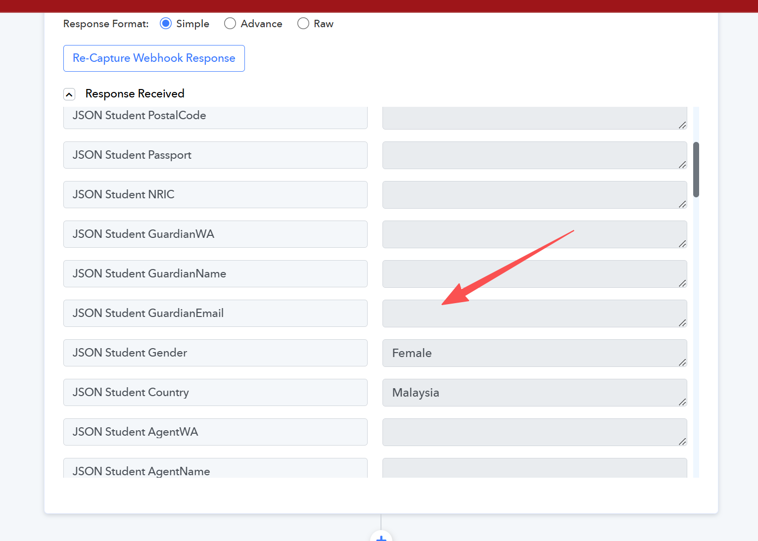

You yourself shared a screenshot where email is empty but key exist -

As mentioned by Fagun Shah, Filter condition is working normally, with the OR condition if either of the condition is fulfilled then tthe workflow will execute further. As the Label/key is available and empty as well, the filter is True. You can try an AND condition if you want both the condition to be fulfilled. Or you can explain your use case so that we can provide information accordingly.

This is expected behavior. Enabling 'Ignore Error' allows the workflow to continue past the failed step, but you will still receive failure-notification emails for those ignored errors.

Base on this screenshot. Does it mean:
1. Key = JSON Student GuardianEmail
2. Key Exist = True
3. Key is empty = True.
I am confused the definition about "Key" here.
Pabbly Support — Reply ·
Yes, your understanding is correct.
In the filter:
  1. Key = Student GuardianEmail — this is the label/field name that you want to check.
  2. Key Exists = True — checks whether the specified key/field exists.
  3. Key is Empty = True — checks whether the specified key/field is empty.
The Key refers to the field/label on which you want to apply the filter.
Also, when you select filter types such as Exists or Is Empty, you do not need to provide any additional value. The filter simply checks the condition for the selected key.
I hope this clarifies the filter configuration for you.
