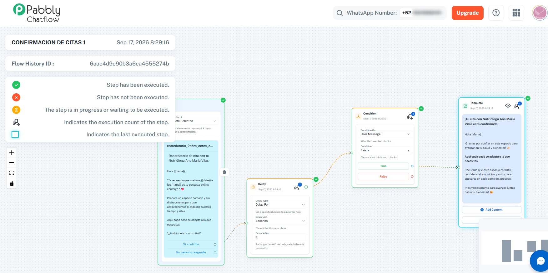

Pabbly Support — Reply ·
We sent a template message to our test number using the "Pabbly Chatflow: Send Template Message" action step. We then replied by pressing a button, which successfully triggered the flow in Pabbly Chatflow.
Flow History ID: 6aac4d9c90b3a6ca4555274b

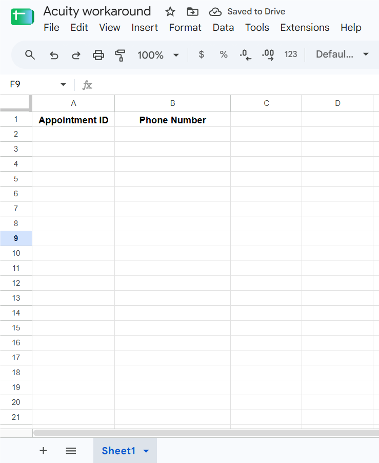

2. The use case you are describing is possible, but it would require a workaround.
It would work like this: you will send a template message using Pabbly Connect. Then, your flow will be triggered in Pabbly Chatflow, and its steps will execute. You have already done this.
You would have to create a new workflow in Pabbly Connect with "Webhook by Pabbly" as the trigger step. Let's call this Workflow 2.
Add an API Request node to your Pabbly Chatflow flow (CONFIRMACION DE CITAS 1) at the end. This will allow you to send data to Workflow 2.
https://youtu.be/TMu35XAOK0A?si=Yic6A1VvdwPDtIJd
Now comes the tricky part. Workflow 2 will receive only the phone number of your appointee. It won’t have any appointment ID or email address that you could use to search for the appointment ID and cancel the subscription.
For this, you would have to use a workaround involving Google Sheets. We need you to create a Google Sheets spreadsheet with two headers: "Appointment ID" and "Phone Number." Once you have done so, let us know, and we will inform you of the next steps.
Arshil Ahmad

  2. For the workaround related to cancelling an Acuity appointment when the button is pressed in a WhatsApp template message, please follow the steps below.
We have added the “Google Sheets: Add New Row” action step to this workflow. This will allow you to add the appointment ID along with the phone number to your Google Sheets spreadsheet.
https://connect.pabbly.com/v2/app/workflow/mapping/IjU3NjcwNTY4MDYzMzA0MzM1MjZmNTUzNTUxMzci_pc
Then, in your other workflow, you need to add the “Google Sheets: Lookup Spreadsheet Rows” action step. This will allow you to search for the appointment ID using the phone number. We will add this step on your behalf as well.
https://connect.pabbly.com/v2/app/workflow/mapping/IjU3NjcwNTY4MDYzMzA0MzM1MjZmNTUzNDUxMzYi_pc

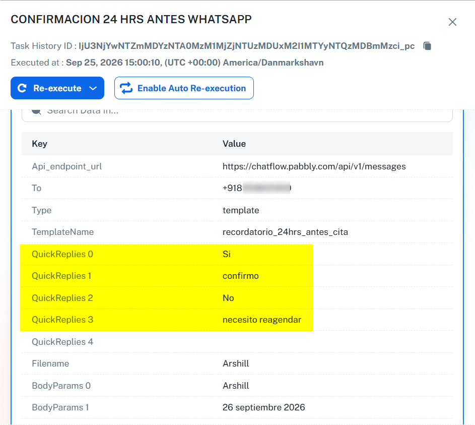

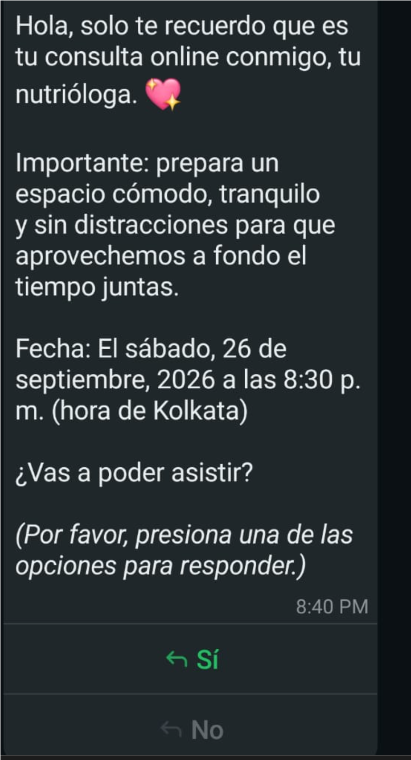

I think we found the issue here. This workflow was triggered, and we did receive a template message.
However, the template message we received through the workflow contained slightly different quick reply buttons. It contained only “Sí” and “No” instead of “Sí, confirmo” and “No, necesito reagendar”.
It appears that because of this, the flow in your Pabbly Chatflow did not trigger, as it is expecting either “Sí, confirmo” or “No, necesito reagendar” as the response.
https://chatflow.pabbly.com/app/flows/edit/69e3d6dbf62fc46a02a957c5
To fix this issue, we recommend creating a new template with quick reply buttons that do not contain any commas, as they seem to be causing an issue when the template message is sent through the Pabbly Connect workflow.
Please use the new template in both your Pabbly Connect workflow and Pabbly Chatflow flow. Once you have done so, please let us know, and we will test the entire process again.

Nutrizione nutrizione — Reply ·
No, that message is form Confirmafy, a program that I use to confirm my appointmets between we do the configuration, I see that the workflow didnt send the message, could you activate it mannually?
Please let me know. Thank you
Thank you for the additional context. There was some confusion due to the difference in language. Apologies for that.
However, the issue with the template message not being sent still seems to be related to the presence of commas in your quick reply buttons. As we can see in this Task History, since there are commas in the quick replies, they are being treated as four different buttons instead of two. This could be causing the message to not be delivered through the Pabbly Connect workflow in the first place.
IjU3NjYwNTZmMDYzNTA0MzM1MjZjNTUzMDUxM2I1MTYyNTQzMDBmMzci_pc
We suggest trying a different template that does not contain commas in the quick reply button
