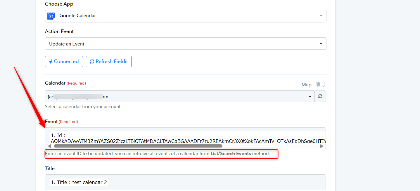

I have previously create a workflow for TODO (new task) to google calendar (new event).
Now, I would like to create a new flow for update event dates, but the test request doesn't work, and got error.

just checked. I have permissions to access and modify the calendar. The error code is 404.

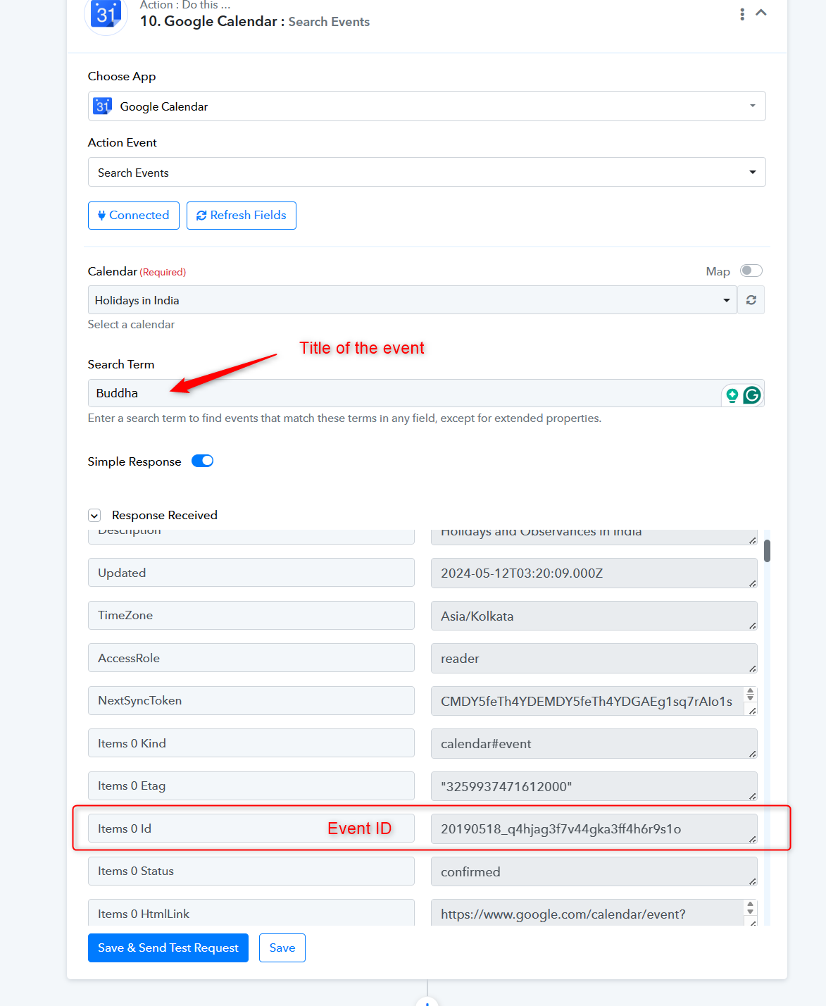

It seems that in the action step for updating an event in Google Calendar, you are mistakenly passing the Event Id from Microsoft ToDo instead of the required Event ID from your Google Calendar event, which should be retrieved using the List/Search Events method.
