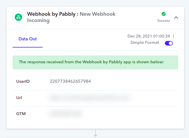

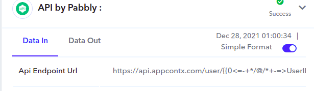

I am getting data via webhook and one of the values is userID from my chatbot.
I am sending this variable to Google Sheets along with other info. I am also initiating API calls where userID is a dynamic value, which I am mapping correctly.

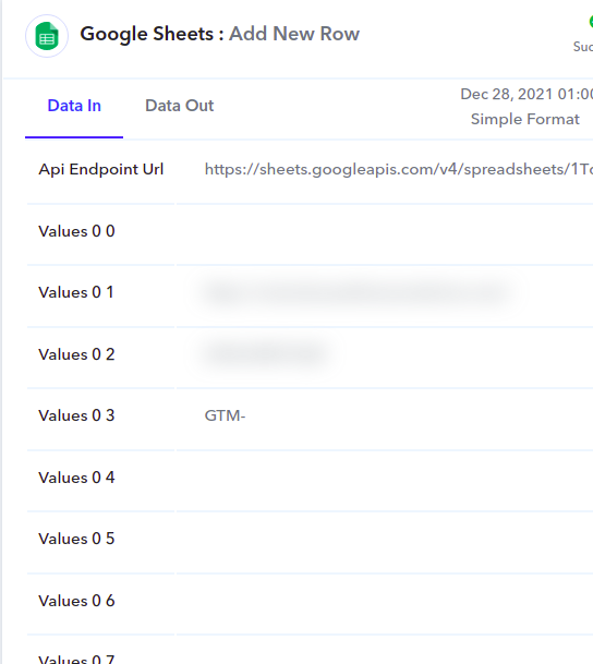

However, in random cases, the userID doesn't populate in both the action blocks .i.e GS action and even when sending out the API call.
In GS, the relevant value shows up as blank in GS.
During the API call, the actual value isn't replaced at all and cos of this the API call breaks.
Can you please look into this and suggest what am I doing wrong?

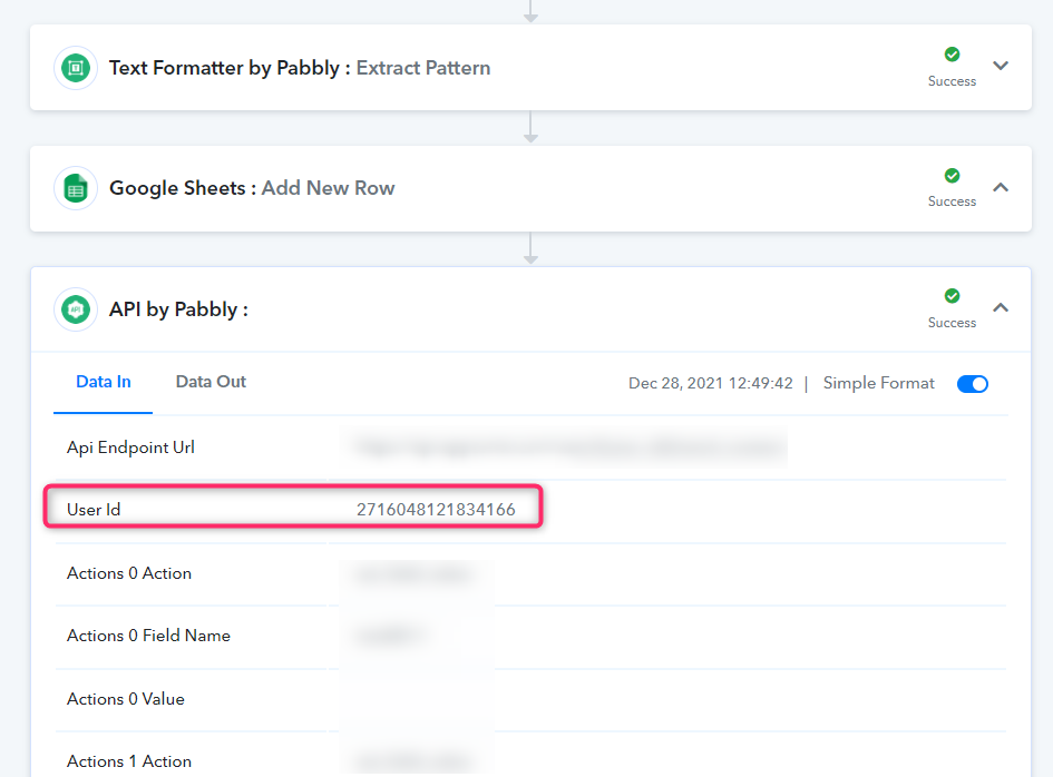

Supreme
Hey @botbuilders_tech

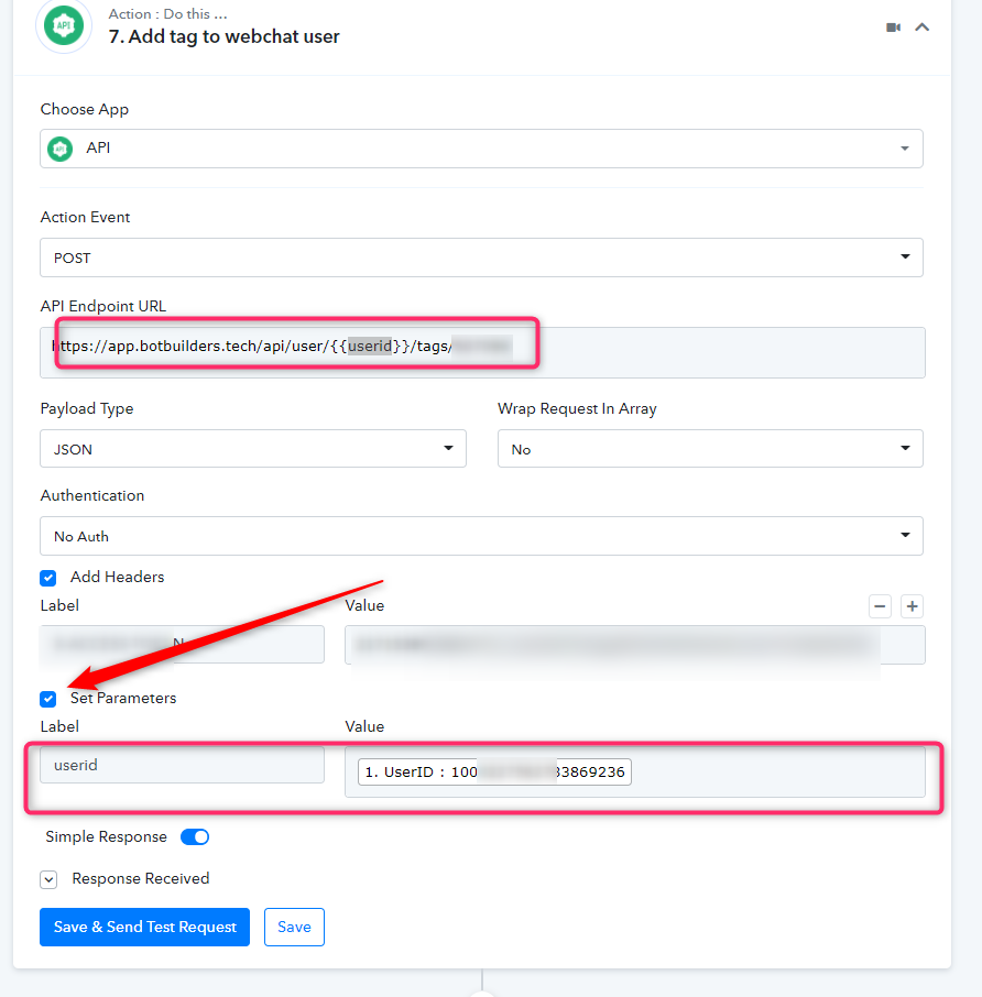

For your concern, kindly use the "userId field" in the set parameters and map the value further in the respective field. Kindly check out the following screenshot for a better understanding.
Though we have re-executed your recent execution and it is working fine.

However, there are a couple of points I would like to highlight here.
1) the userID doesn't insert even for Google Sheet action.
2) i am using custom API call with JSON payload being sent. So, I can't set the Parameters like you showed. I tried adding a userid in the JSON body, but it didn't work. Can you give me the correct format?

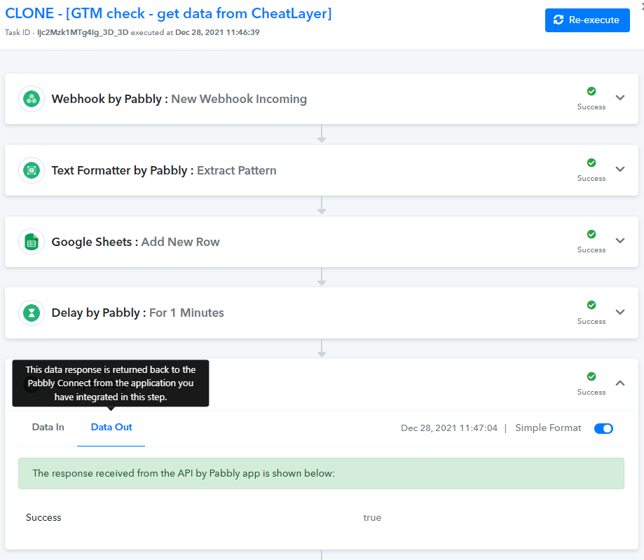

Else you can add a delay action step so that API by Pabbly gets the Id/Value which is mapped onto it.
Though we have tried that too and it is working too.
unfortunately this doesn't explain why the userID isn't being sent to Google sheets.
Can you look into that as well, please?
The userID should be mapped to values 0 0 in the google sheet action.

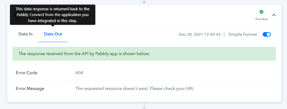

As we can see in your recent execution the API's response is coming directly from their end(Date Out) and since the Data In which the data is being sent from our end is fine.
So, kindly contact the applciation's support team as the message is showing that the resource which you called upon doesn't exist.

By the way, the API call works fine within swagger and other tools. It doesn't fire from within Pabbly only as i believe the userID isn't being inserted properly

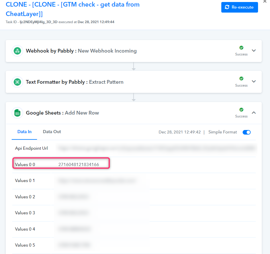

As we can see in your cloned workflow the UserID field is passing perfectly in the respective action fields of your workflow.
Further, if you are still not getting the mapped values passed then kindly re-authorize your Google Sheets action step and try again.
