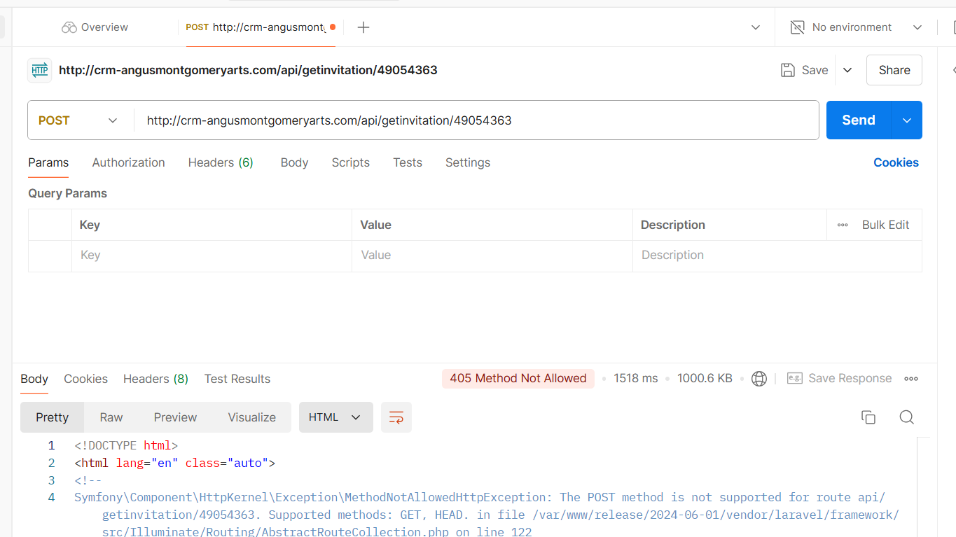

Team- Its GET call NOT POST. Please change GET it will work.
We have verified this with a GET request, and the API call is still unresponsive as it is taking more than 25 seconds. Please contact the API provider to check the response time.

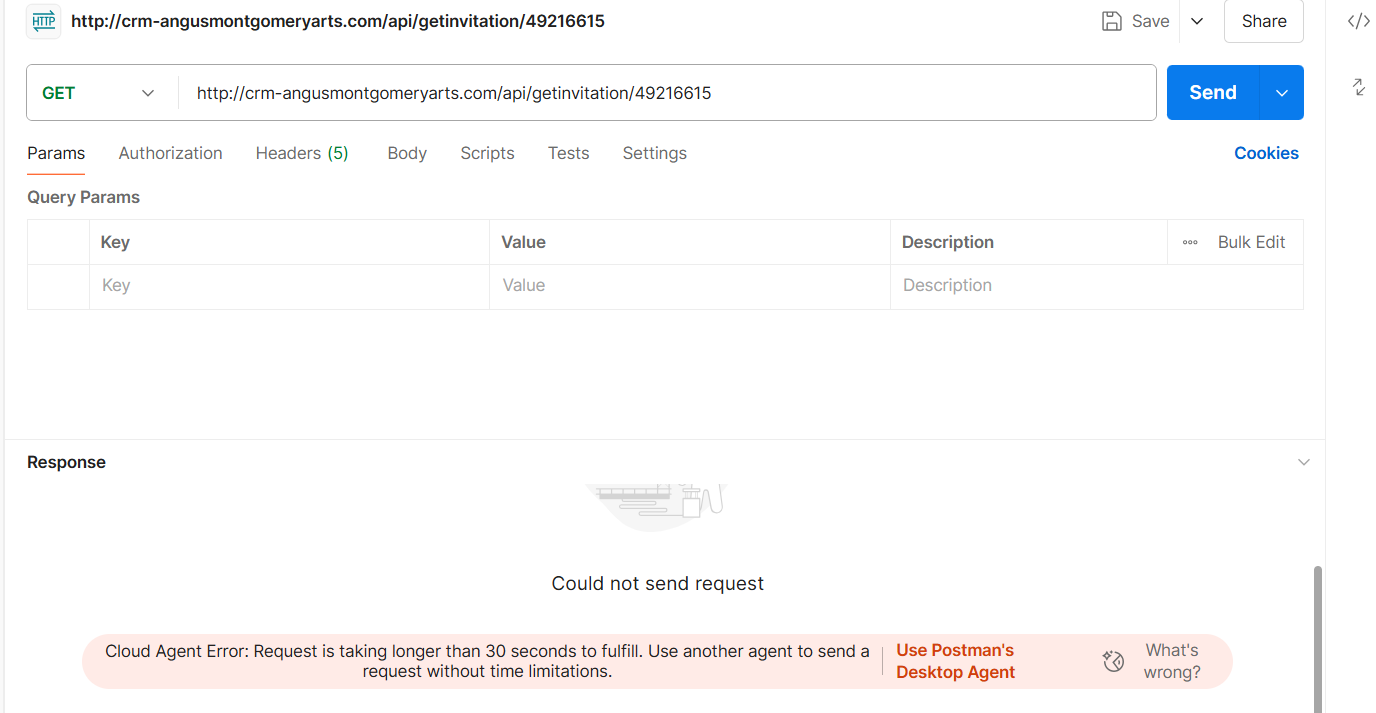

Team - I don't know why this request is not working in your end. It's working for my end successfully. see below
URL-
http://crm-angusmontgomeryarts.com/api/getinvitation/49216615
Please check the following short recorded video. We tried using our Postman application online, but it is not working.
Team- Above screenshot URL is not working for me. Could you please setup meeting with me so we can discuss this issue over call and resolve asap without back&forth. Please setup meeting with this email id "[email hidden]".
Please note that we only support API requests with endpoint URLs using HTTPS. For security reasons, HTTP (without the "s") is not supported. Kindly update your request to use an HTTPS endpoint to ensure a successful connection.
