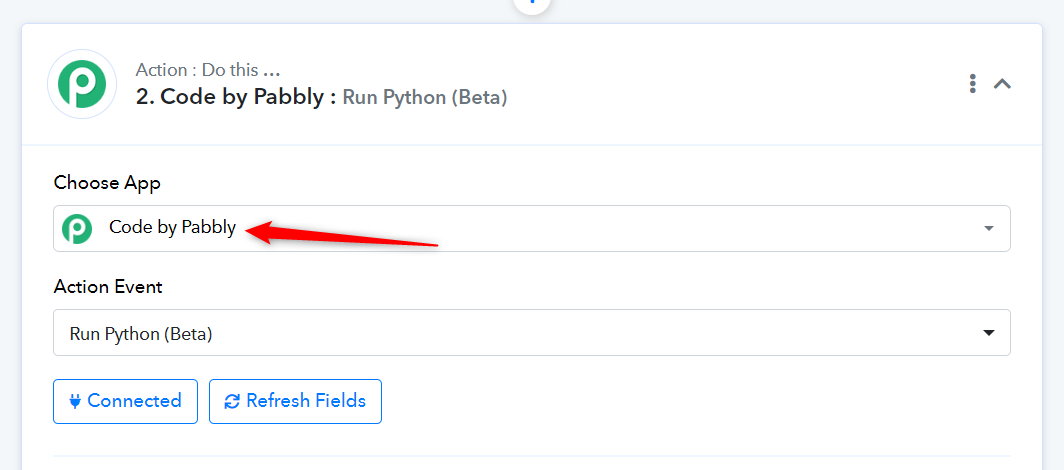

When making changes to a deprecated application, ensure that you select the application from the 'Choose App' field. This will help resolve the issue.
JeffreyYu — Reply ·
Ohhh that’s different from other steps. I Will try that next time, thank you!
