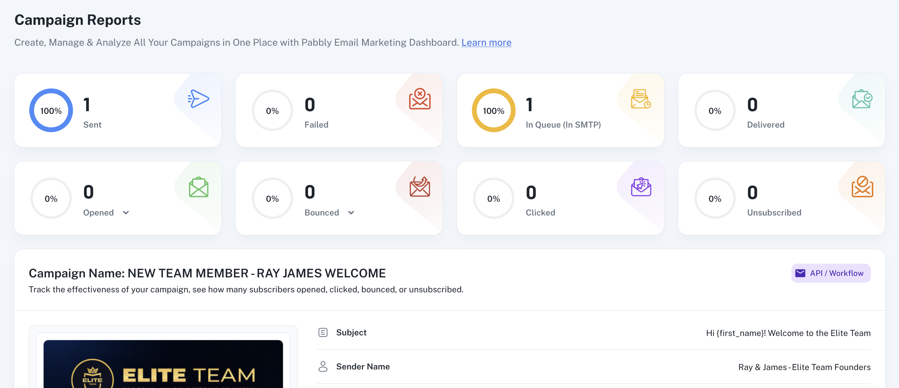

So continuing the conversation about the Campaign stats.
Here's a campaign I ran yesterday with 1 Subscriber in the campaign.
As you can see from the image 1 email was sent to the recipient. I have confirmed with my smarthost company (SMTP2GO.com) that the email was sent and the report there confirms it was sent, delivered and opened.
However your statistics tell me a completely different story.
Your statistics tell me it was sent (AGREED), that its stuck in a queue (DISAGREE) and that its unopened (DISAGREE), in fact the recipient not only received the email and we have since had a conversation BECAUSE he received the email.
So your campaign statistics are broken - really broken.

Hello Raymond,
Thank you for your response and for sharing the details regarding your SMTP2GO campaign.
Our technical team inspected your account and logs to trace why the delivery and open statuses were not reflected. Upon checking, we found that no event data (webhooks) is currently being received by Pabbly from your third-party delivery server.
Since delivery status, bounce reports, and open/click stats rely on incoming webhooks from SMTP2GO, could you please verify if the Delivered, Bounce, and Spam Webhook URLs are correctly added and active in your SMTP2GO dashboard settings?
You can find your specific webhook URLs by navigating to Settings > Delivery Server in your Pabbly Email Marketing dashboard, selecting your SMTP2GO / Elite Team server, and expanding the Delivered, Bounce & Spam Settings section.
Please re-check your configuration in SMTP2GO and let us know if you need any assistance getting them set up!
