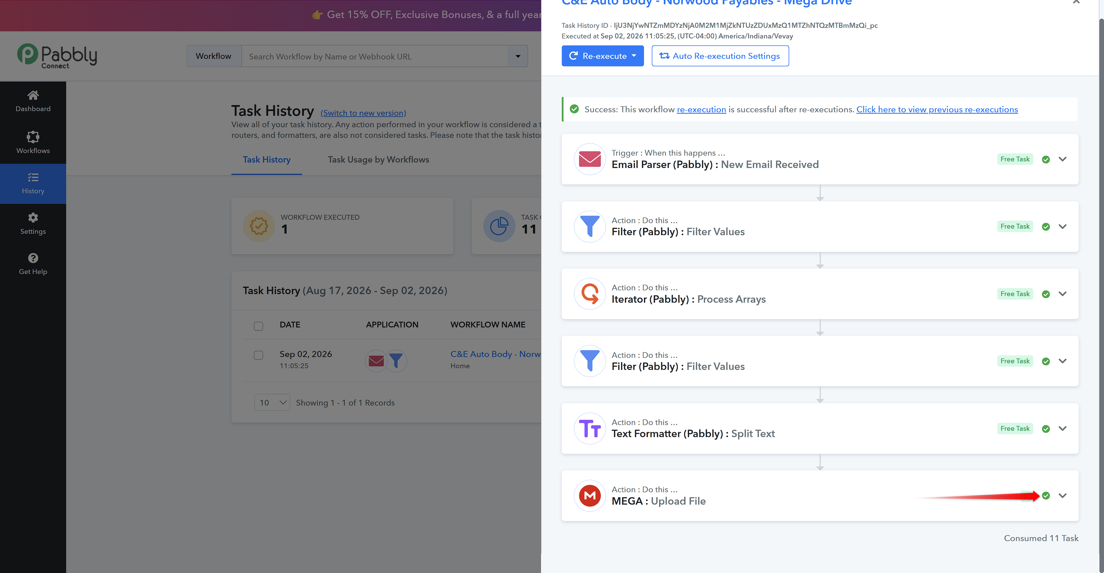

Periodically I receive an email stating:
This email is to notify you that for the workflow "C&E Auto Body - Norwood Payables - Mega Drive" , a recent task was not executed due to following error -
Task History ID: IjU3NjYwNTZmMDYzNjA0M2M1MjZkNTUzZDUxMzQ1MTZhNTQzMTBmMzQi_pc
Step Name: MEGA > Upload File
Connection Name: MEGA 1
Task Error Detail:
However, when I click the link and look at the history for the tasks, there are only Success completions ?
Is this meaning that it retried the step and it then went through as expected ?.
Is there anything I should do when I receive these messages ?
Pabbly Support — Reply ·
Hello Tony,
Thanks for contacting us.
We checked the failed task that you shared with us, we found that the task has executed successfully in the re-execution as they particular step was failed initially due to temporary error at Mega Upload's end.
image.pngAs you have enabled auto-re-execution settings for the workflow, you may receive failed task error but when you check the task may be executed successfully as the issue was a temporary issue.
