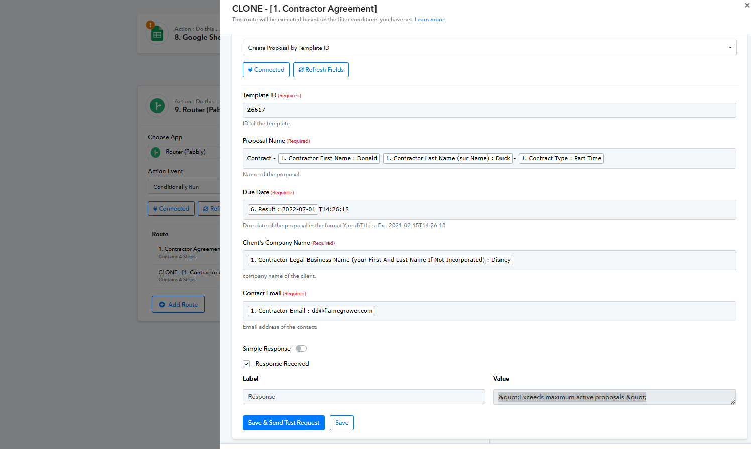

I am attempting to utilize the fresh proposals create proposal function. It worked for me in the past (2022) but it no longer seems to work.
I am able to successfully create/edit a new contact.
the error message " "Exceeds maximum active proposals." "

The error is coming from fresh proposal not from pabbly connect. "Exceeds maximum active proposal" Means with your current plan in fresh proposal Exceeds maximum limits to create proposal.
FYI I'm not from pabbly connect team I'm freelancer who helps other pabbly users. If you still have any doubts you can dm me.

I reached out to Freshproposals and they had a bug in their system. Once the bug was fixed this began to work again. Thanks!
Thank you for the update. We are glad the issue is fixed now.
