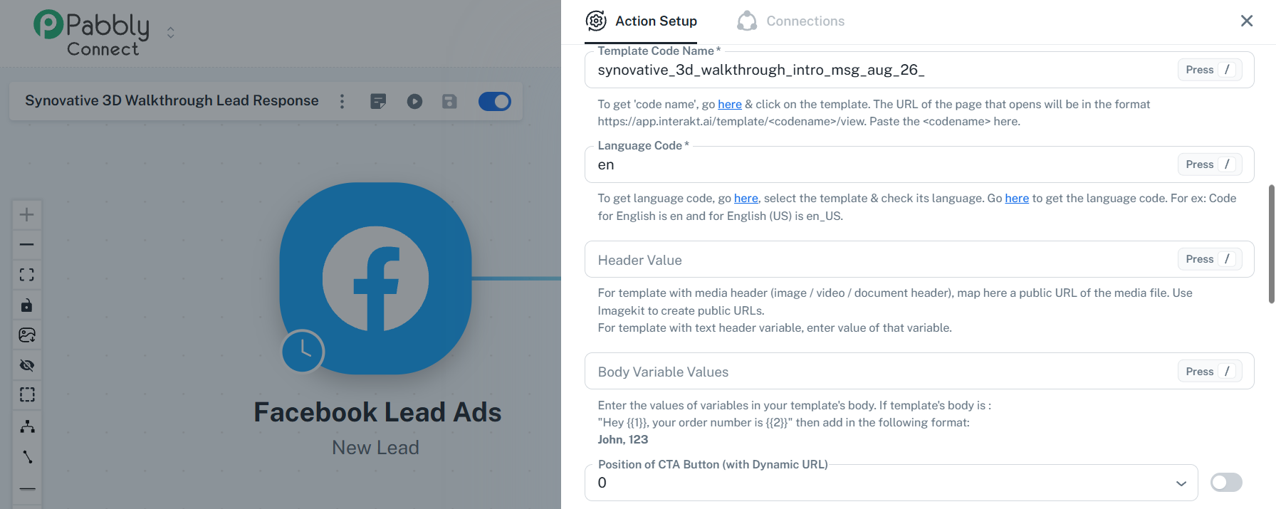

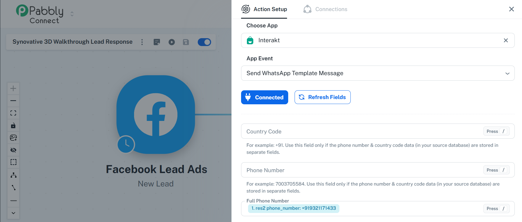

My meta lead generation campaign is on, and I want to reply to every lead using Interakt. I already created a message template in Interakt

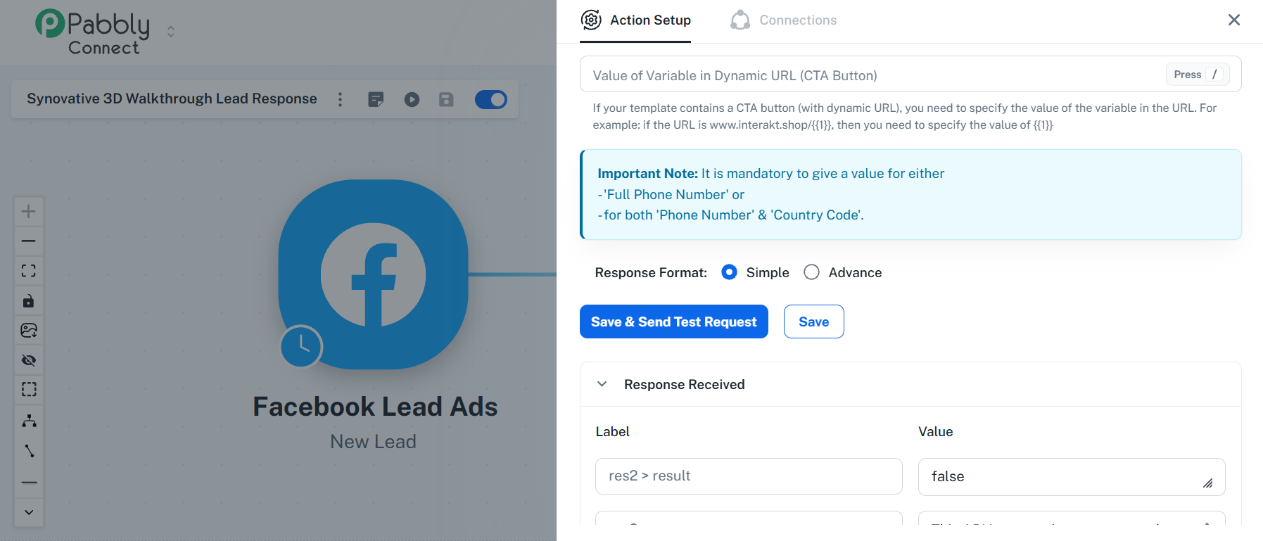

So I am trying to connect Interakt to Pabbly, but I'm facing an error in the last step when Interakt connects to Pabbly.

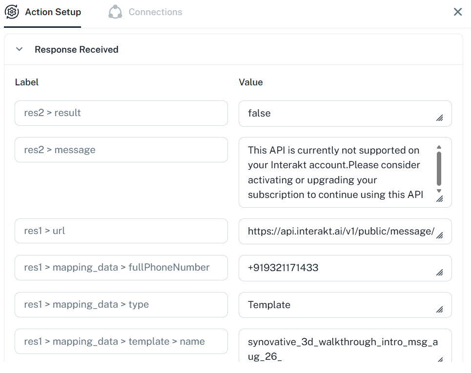

Upon inspecting your workflow execution logs, we found the following error message returned directly by Interakt during the WhatsApp Template action step:
"res2 > message": "This API is currently not supported on your Interakt account. Please consider activating or upgrading your subscription to continue using this API"
What this means:
This error occurs because the Public API access feature is restricted or not included in your current Interakt plan/subscription. As a result, Interakt is blocking Pabbly Connect from sending messages through their API.
