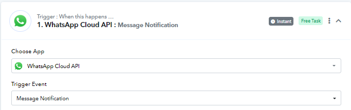

You can execute this by setting up your WhatsApp Cloud API template so that it has a button for Deletion or Unsubscribing. And you get any keyword such as "Delete" or "Unsubscribe" in the response. Then you can add trigger step WhatsApp Cloud API with trigger event message notification. Follow the instructions in this video -

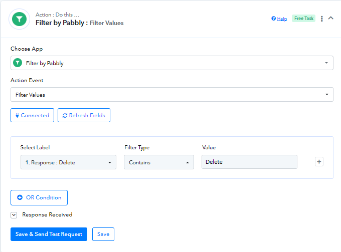

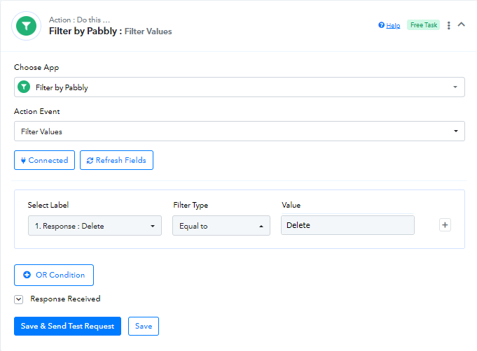

Now, for the next step you can add Filter by Pabbly and map it so that the workflow will only proceed if there is confirmation from the user.

Hello, with filter by pabbly, I can't seem to be able to fine the response option
What do I do
Hey @measured1
You can click on the "Select Label" option in the filter and then you can map any response from the previous step, i.e. WhatsApp Cloud API.
Also, Kindly let us know your workflow name or ID, and the account by which you are using Pabbly Connect so that we can assist you better.
