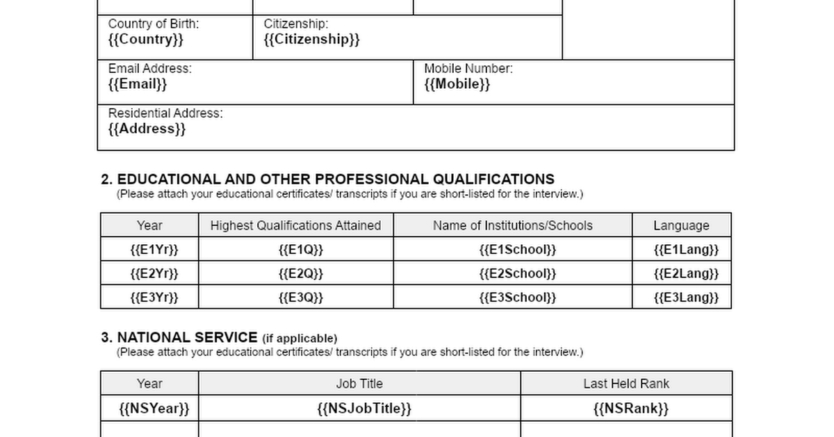

hi all,
Would like some advise on the follow process.
1. We have gotten a set of data from Google form
2. Set of data is updated to Google Doc when there's a New Google Form Response i.e NewResponsefromGoogleForm attached
3. One of the data uploaded fromGoogle form is a picture uploaded to Drive (photo) i.e https://drive.google.com/open?id=1IXiNzWEpAaS6tEVJmrgdU_X1fRmmNPCA
4. How can we set this photo into the specific location in the Google Doc. See attached GoogleDocSpecificLocation - with {{Photo}}
We have set up the Workflow Process so far as attached. Was prompted by the process to use GetGetdocumentDetails to get the specific locations on the Google Doc. However, we could not find any video guide on this, nor can we able to identify the correct parameter to choose from under the GetDocumentDetails Test Response to map to the correct location.
Please advise what's the best

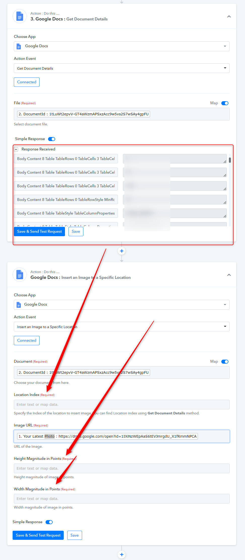

Hey @ichilddev
Kindly use the "Google Docs: Insert an Image to a Specific Location" action step to pass the image into the specific location of the Documentation.
You have to pass the Location Index and Magnitudes height with its width.

Hey @ichilddev
Is this the Magnitude height? I can't find the Magnitude Width

Hey @ichilddev
You have to check the Magnitude Width and dimension according to the documentation in which you are trying to passing.

Hey @ichilddev
You can check the dimension of the docs by manually passing the image to the location.
There is no tool available which can give you the exact location of the photo here you want to pass.
