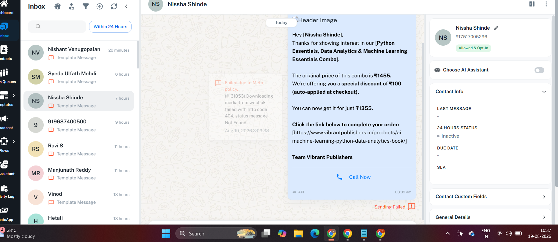

Messages are not delivering from my chatflow
Status: Closed · Asked by Vibrant Publishers Support Team on · 0 views
Vibrant Publishers Support Team — Question ·
Automated messages are not delivering from the chatflow
Pabbly Support — Reply ·
Thank you for sharing the screenshot.
It appears that the template you are sending is an image-type template, and the image URL being passed with the template is not accessible properly, which is causing the delivery failure.
We recommend checking the image URL configured in the template and ensuring that it is publicly accessible.
Also, it appears that these templates are being sent via API. Could you please confirm whether you are using a Pabbly Connect workflow to send these messages?
If yes, kindly share the workflow URL so we can review it and assist you further.
