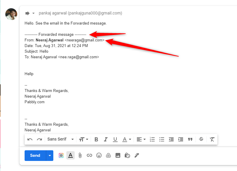

Usually when the emails are forwarded. The original From emails are preserved in the Forwarded Body of the email.
Do check the Body HTML of the parsed email and see if you captured any email address over there. If yes, you can extract that email by applying some Text Extraction logic.
You can check the Email Parser video to learn how to extract data from body of the email.
