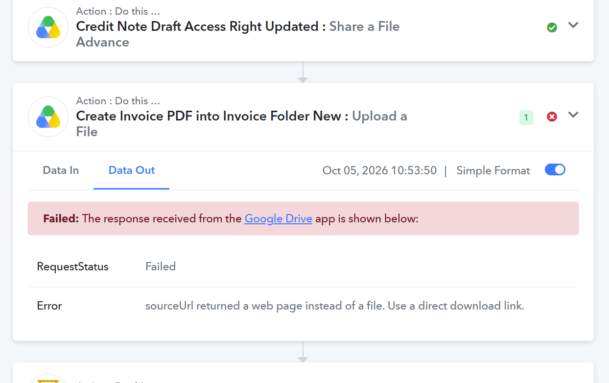

New Google Drive Upload Has Issue YET AGAIN!
Status: Closed · Asked by IChild Company on · 0 views
IChild Company — Question ·
Dear Support.
Source URL is intact. No Issue at all, yet kept giving this issue when giving this response: sourceUrl returned a web page instead of a file. Use a direct download link.

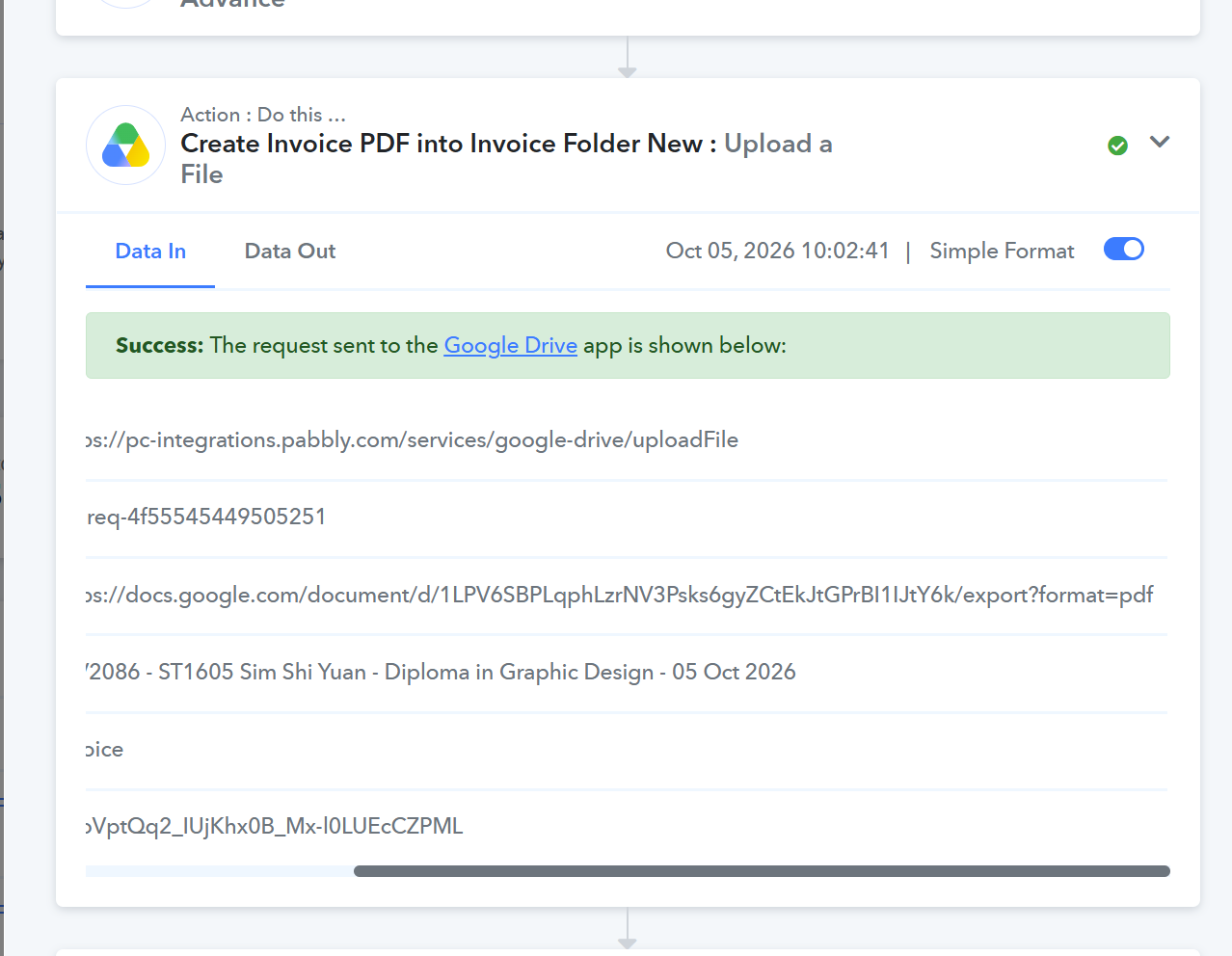

Same Method, Same time period executed by another flow, NO ISSUE AT ALL. Please check asap.

We reviewed your workflow and Task History details. The error:
occurs because the URL mapped in the File URL field is not returning the actual file to Pabbly. Instead, Google is returning an HTML access/login page.

URL from the previously working workflow:
https://docs.google.com/document/d/1LPV6SBPLqphLzrNV3Psks6gyZCtEkJtGPrBI1IJtY6k/export?format=pdf
When testing this URL, Google currently returns a “Sorry, the file you have requested has been deleted” page.

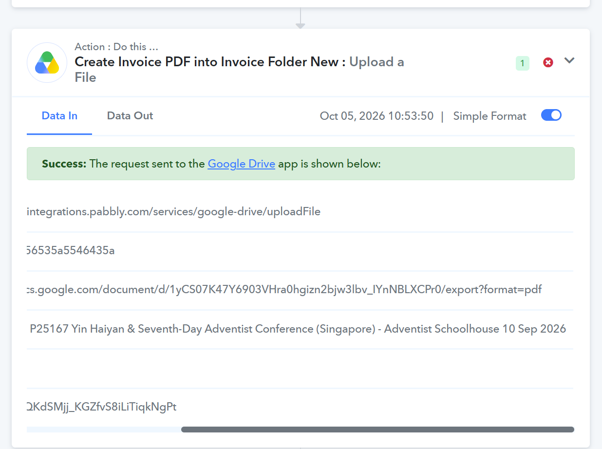

URL from the failing workflow:
https://docs.google.com/document/d/1yCS07K47Y6903VHra0hgizn2bjw3lbv_IYnNBLXCPr0/export?format=pdf
When testing this URL in an unauthenticated window, Google returns “You need access.”
This indicates that access to this particular Google Doc is restricted. When Pabbly attempts to download the file using the URL, Google redirects the request to an access/login page instead of returning the PDF file itself. As a result, Pabbly receives an HTML webpage rather than the expected PDF file, which causes the error:

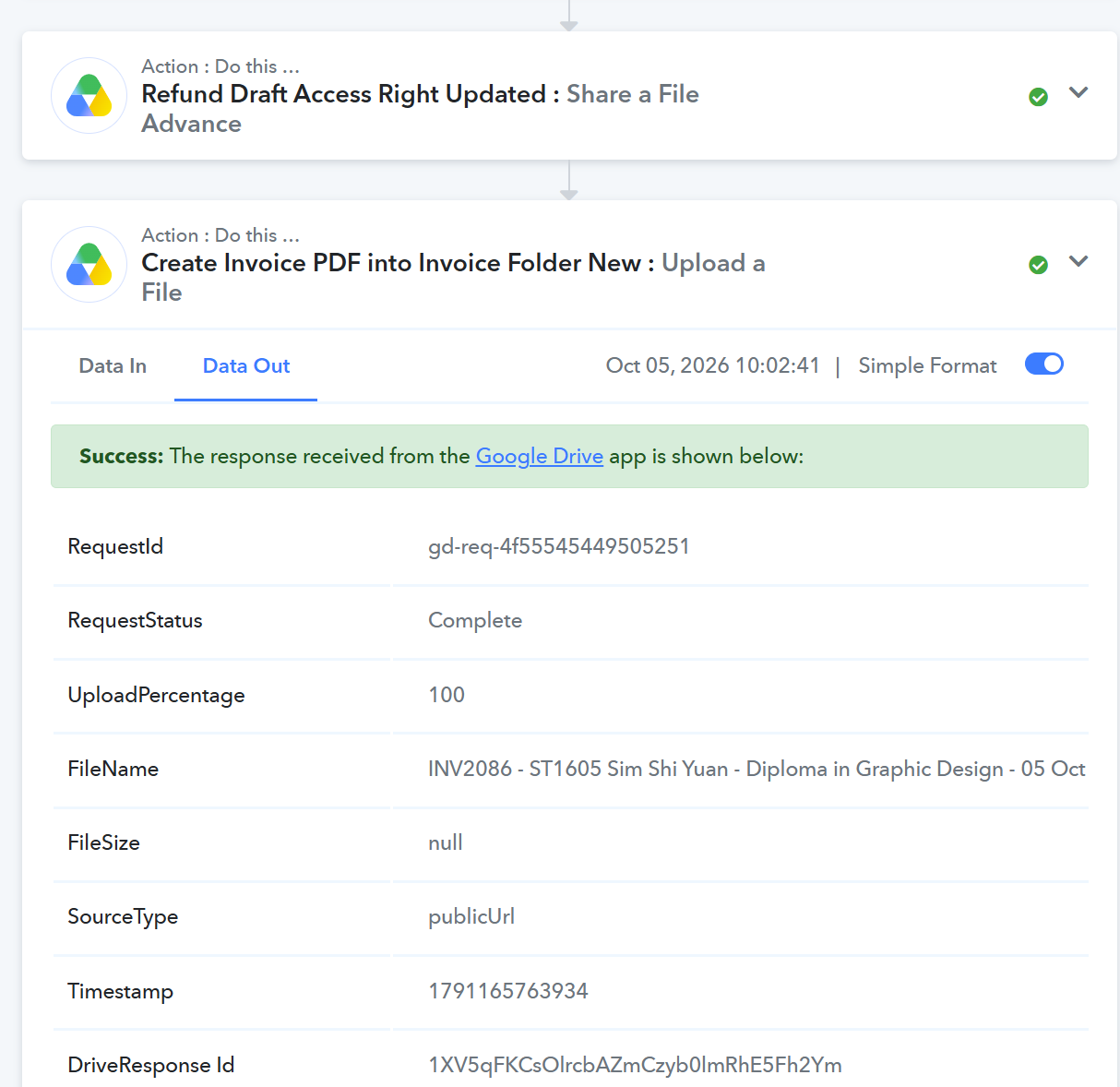

To rebuke your above explanation, please see all the following Task IDs which are successful just 1 hour ago.
1. IjU3NjYwNTZmMDYzMjA0M2Q1MjZkNTUzMDUxMzU1MTZiNTQzNjBmMzQi_pc
  1. IjU3NjYwNTZmMDYzMjA0M2Q1MjZjNTUzZDUxMzA1MTYyNTQzOTBmMzAi_pc
  2. IjU3NjYwNTZmMDYzMjA0M2Q1MjZjNTUzZDUxMzM1MTYxNTQzNTBmMzci_pc
