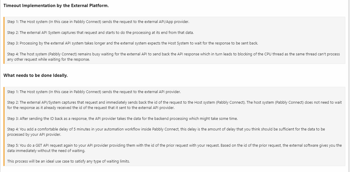

Hey @chuchi
Currently, the 15-second response capturing works globally in Pabbly Connect and cannot be changed.
Perhaps you might be using the application extensively or the data you are passing couldn't process by the application itself under the time bracket.

We have also written a guide on how to better handle the wait time for external application that you can recommend to OpenAI team.
We talked internally to the tech team today itself and somehow the limit of 25 seconds is not planned to be increased for now.

For a limited time, we have increased the Timeout window for OpenAI Generate Content to 40 seconds. Although this is not an ideal thing to do.
Please note Zapier has the timeout limit of 30 seconds for OpenAI and similar issues are been faced by the users across different platforms.
The ideal way to handle this use-case is something that we have informed to the OpenAI team. We have sent the email but haven't received any reply back from them.

Temporarily, the Timeout window for OpenAI Generate Content has been increased to 40 seconds, although this is not the preferred solution. It is important to note that Zapier has a timeout limit of 30 seconds for OpenAI and other platforms are encountering similar issues.
We have informed the OpenAI team about the ideal solution for this, but have not received a response.
