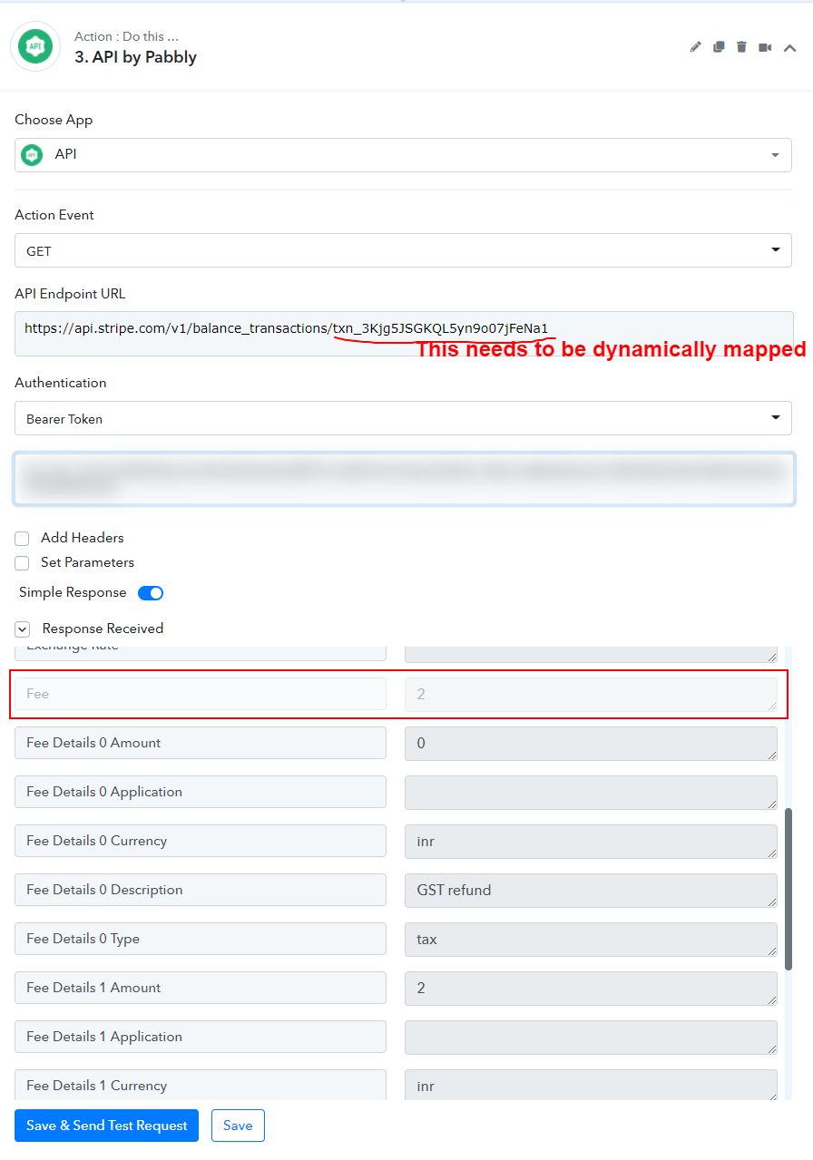

I am assuming that you are using Charge.succeeded event for webhook, then you must be getting "Transaction ID".
You can do another Custom API call to get Stripe Fees,
