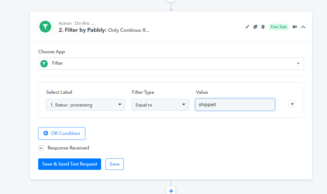

I am sharing my flow here.
when this flow completed I need to sent the user with their tracking link on whatsapp. What I have did is add one more filter to get the status as shipped, but test response is error

Hey @vmpetsmart
We understood your concern, kindly place the filter condition to shipped and manually type the message as Shipped in the next action step, so that it will always send the message when an order gets shipped. Though setting up the filter condition will give you false results in the initial setup but will run accordingly in automation.

yes but i need map the data of tracking link from the last filer response. If the response is error, how can retrieve the data and map to the next action

If you have used the Completed order status as "Shipped" then you can simply use it in the filter condition and set the WhatsApp API accordingly for the order which is shipped.

I have tested it live. since there is no data received from it. The only problem is my filter condition status is not getting result. Only if getting the result means I can map the data for my WhatsApp template.

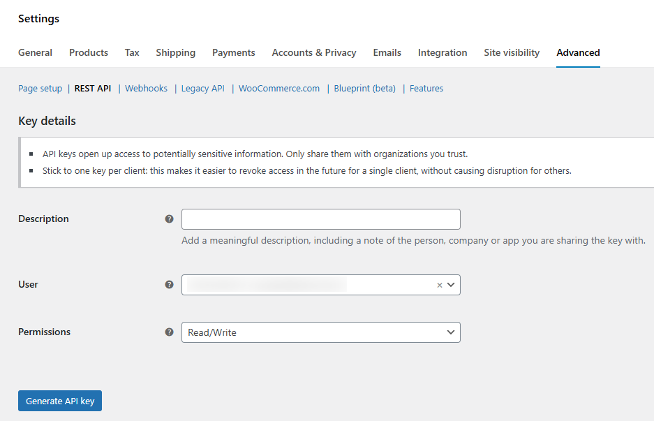

I have an API details with me. Can you help which value to be filled in which places.
This is for retrieving my order tracking number and details
Above is the page I am connecting to by API.
Below images are the documentation provided by the plugin author website which I have connected with me woocomerce.

Supreme
Hey @vmpetsmart
Please check out the following screenshot for using "Add Shipment tracking" in API by Pabbly, kindly use "custom request" to use the API.
In a similar way, you can design other action steps too at your end.
