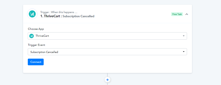

Hey @Keith Dream
We looked over your concern and it seems like you might need to use the "Subscription Cancelled" Trigger Event of Thrivecart.
Please try this event to capture the canceled memberships of yours. Moreover, let us know if that works for you.
Thanks!
Keith Dream
Oh, so simple! I don't know how I missed it, but that worked! Thank you.

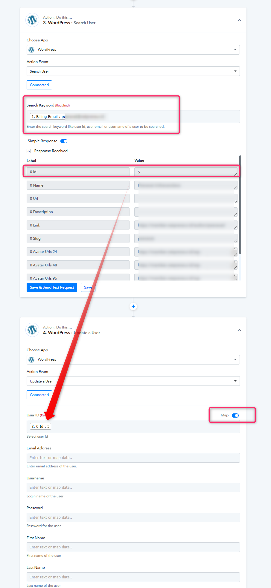

Ok, simple mistake again. I found out how to map the email address. :)
I was able to set the email address and pass the subscription end date in the "Description" field, which I believe is the user's profile. So it isn't ideal, but might work for starters.
I would love to hear any ideas and I'm loving Pabbly!
Here's my flow:
Supreme
Hey @Keith Dream
We looked into your workflow and you might need to map the User Id of that particular user with the help of the Search Contact User. And as of now, you have to pass the end of the subscription in the description field.
Keith Dream
Thanks for the follow up. Do I have to do the User Search action first. It seemed like I could skip that step and use the email address in the "Update a User" action.
And thanks for the advice on the subscription end date. It will be nice to have that option in the future, but at least I have a way to do it now.

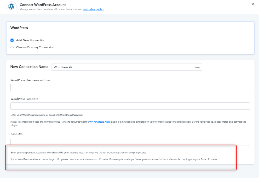

Supreme
Hey @Keith Dream
When you update the user in WordPress you might need to pass the user Id in the Update User action event. Further, while testing your use case on your account it seems like you might have inputted wring credentials or maybe you passed the domain URL with a trailing slash.
Also, could you please confirm that have you installed the Basic-Auth-master.zip plugin in your WordPress account?
If not, kindly check this out - https://forum.pabbly.com/threads/wo...-are-not-allowed-to-create-new-users-401.813/
