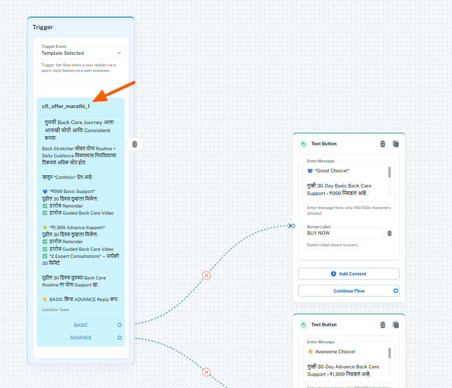

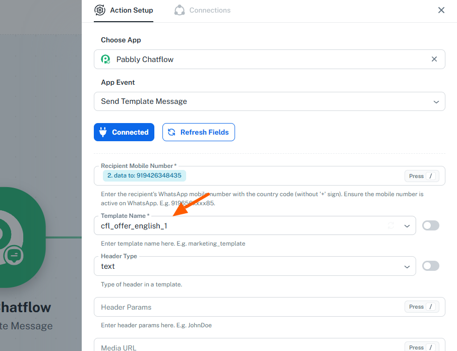

  1. I have attached screenshots of my current flow configuration for your reference.
  2. The issue is occurring in my Pabbly Chatflow setup.
  3. Yes, the payment trigger is coming through Pabbly Connect from the payment gateway, and then the WhatsApp messages are being sent through Chatflow.
  4. Separate templates have been created for each product: ₹499, ₹999, and ₹1,999. However, despite having separate templates, customers are still receiving incorrect messages. For example, some customers who purchase the ₹999 product are also receiving messages related to the ₹499 product.

Hello Sidharth,
Thank you for sharing the details and screenshots.
We checked your workflow and the Chatflow setup. The issue we noticed is that the template currently configured in your Chatflow does not match the template being used in your Pabbly Connect workflow. The Pabbly Connect workflow is sending the English template, while the Chatflow flow appears to be configured with the Marathi template.
We recommend updating the template in your Chatflow to match the correct template. Once this is done, the flow should work as expected.
Regarding the Healthy Ecosystem error shown in your other screenshot, this can occur for multiple reasons. One possible reason is repeatedly sending the same template to the same contact. We recommend waiting 24–48 hours before attempting to resend messages to the same contact.
