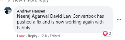

Neeraj
Administrator
ConvertBox has pushed an update to fix the webhooks sending.
