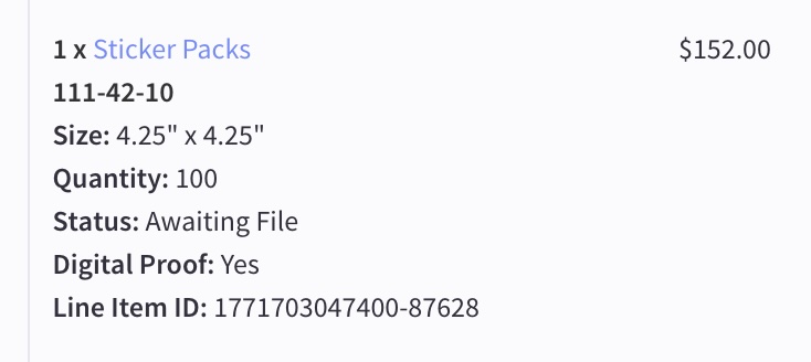

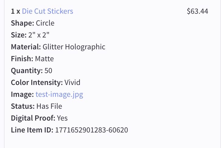

Hi @Preeti Paryani. Our client confirmed they want "all" products in an order as subitems so you can disregard my previous message.
We are having issues with one of their products in particular "Sticker Packs". I've attached an image of the order information. You'll notice "Sticker Packs" don't have as many fields the other products have.
Sticker Packs
  1. Size
  2. Quantity
  3. Status
  4. Digital Proof
Die Cut Stickers, Kiss Cut Stickers, Sticker Sheet, Specialty Stickers
  1. Shape
  2. Size
  3. Material
  4. Finish
  5. Quantity
  6. Color Intensity
  7. Status
  8. Digital Proof
A single order can have any combinations of these products, however it seems that if "Sticker Packs" is one of the items the automation is breaking after adding the Monday.com > Create Item step. My guess is it may be erroring when trying to create the lookup tables since there are none of those fields for that product (Sticker Packs)? Maybe put a filter before each lookup table to check for that field?

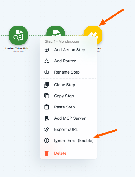

Hi Marc,
Thanks for sharing the workflow details.
First, please try this quick fix before making structural changes:
  1. Go to the Create Subitem (Monday.com) step.
  2. Click on the three dots.
  3. Enable Ignore Error.
  4. Run a test with an order that includes “Sticker Packs”.
If the failure is only due to missing fields (like Shape, Material, Finish, etc.), enabling Ignore Error should allow the workflow to continue without breaking.

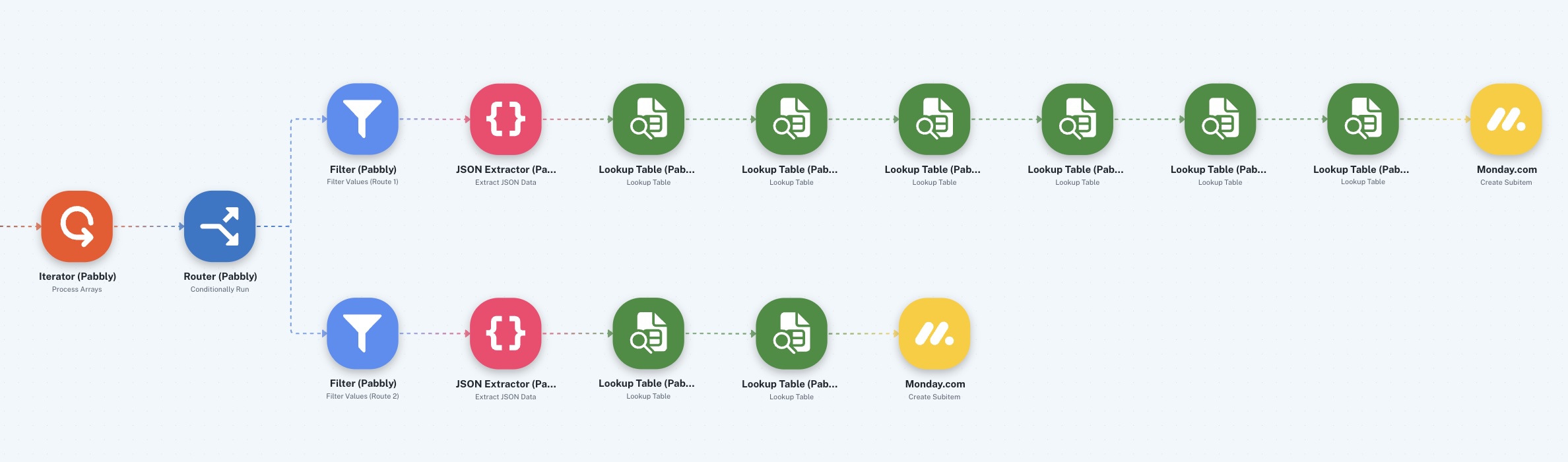

If the issue still persists, then we recommend restructuring the flow using a Router after the Iterator:
  • Route 1: Add a filter where extended fields (e.g., Shape) exist → run all lookup steps → create subitem.
  • Route 2: Add a filter where extended fields do not exist (Sticker Packs) → do not unnecessary lookups → create subitem with only available fields.
Please test the Ignore Error option first and let us know the result. If needed, we will guide you through configuring the Router properly.
ec_206
Hi @Preeti Paryani I enabled ignore error and ran a couple tests. The first was an order with a Die Cut Stickers and Sticker Pack. The iterator ran, but only added the Die Cut Stickers subitem, not the Sticker Pack. The second test order was just a Sticker Pack and it didn't add the subitem.

It is not allowing me to add a Router step after the iterator. I'm seeing a message "Router can only be added at an end of a workflow".
Disregard Preeti. I figured out out to restructure. Needed to delete all actions after the iterator, then add the router.

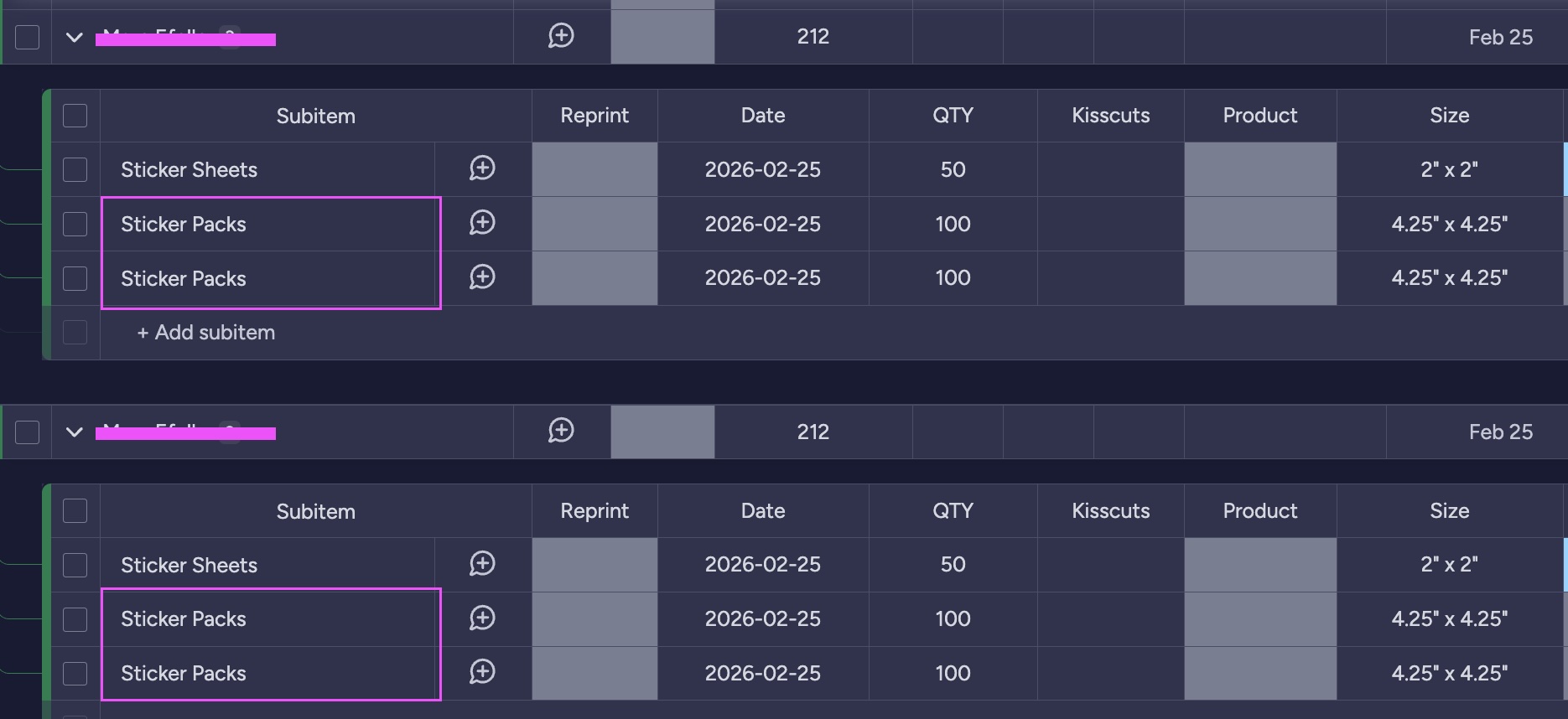

Hi @Preeti Paryani. I think I'm getting close. Attached is a screenshot of the new automation with Router. I cloned the original one. The issue now is it's creating a duplicate Parent Item, then duplicate Sticker Pack subitem? Only one workflow is active so I don't think this is the issue on the duplicate parent creation.
You'll also notice the Sticker Pack route uses a couple of the same lookup tables as the other filter route however the "Lookup key" is different based on the product.
Here is the new automation: https://connect.pabbly.com/v2/app/workflow/mapping/IjU3NjcwNTZjMDYzZjA0MzM1MjZjNTUzNTUxMzQi_pc

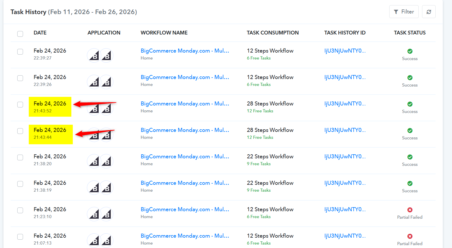

Could you please share the Task History ID for the test instance where the duplicate Parent Item and Sticker Pack subitem were created? This will help us review the execution in detail and assist you in identifying the cause of the issue.
ArshilAhmad
Based on your Task History, we can see that your workflow is executing twice for the same order.
Task History ID - IjU3NjUwNTY0MDYzMjA0Mzc1MjZjNTUzMjUxMzA1MTYwNTQzNjBmMzci_pc
Task History ID - IjU3NjUwNTY0MDYzMjA0Mzc1MjZjNTUzMjUxMzA1MTYwNTQzNjBmMzgi_pc

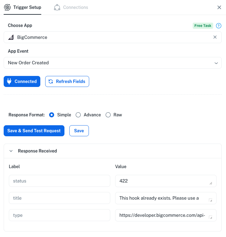

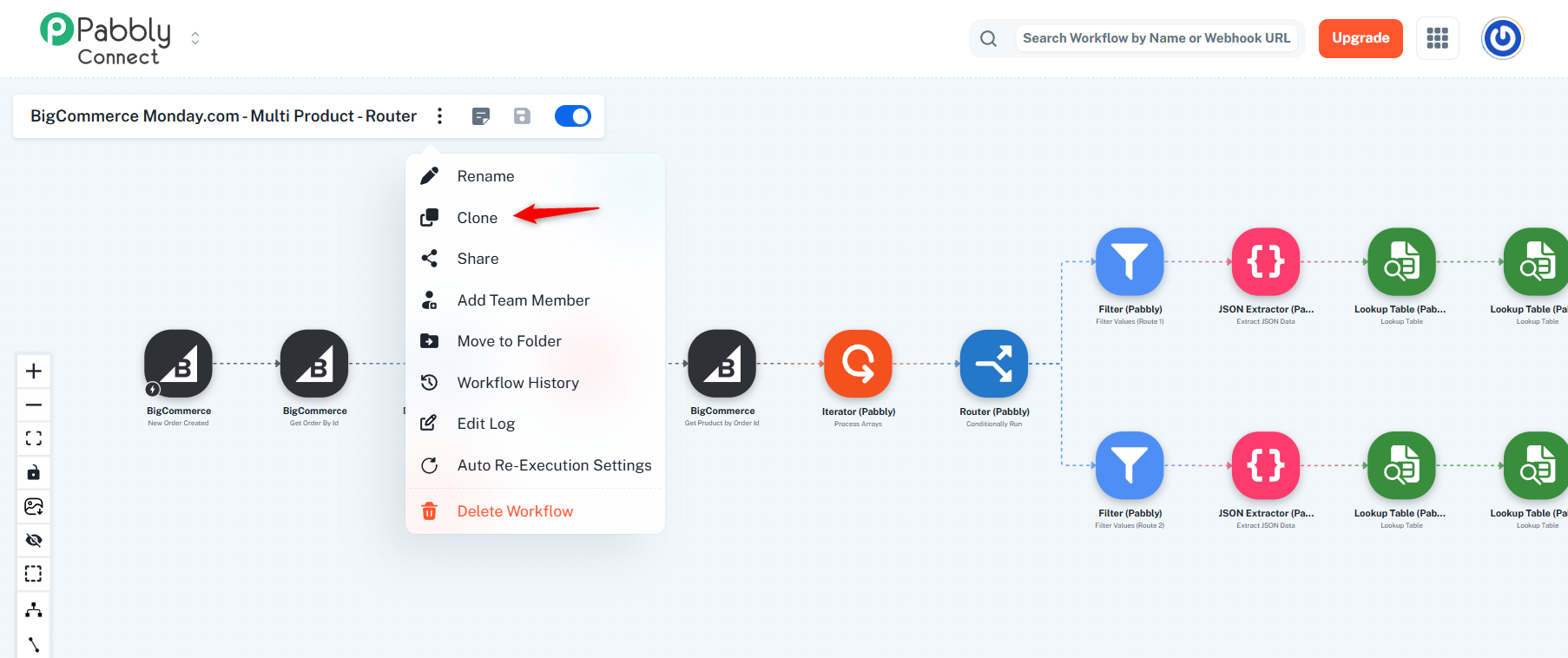

The issue occurs when a user clicks the “Save & Send Test Request” button multiple times in a post webhook–based trigger step. Since the BigCommerce trigger step is based on post webhooks, clicking the “Save & Send Test Request” button multiple times can cause this issue.
To fix this, we suggest that you clone your workflow, disable the existing workflow, and set up BigCommerce as the trigger step again in the new workflow. This will ensure that your workflow is triggered only once.
Arshil Ahmad
🌐 Pabbly.com
👉Rate your support
ec_206
Thanks @ArshilAhmad just to make sure, I cloned the workflow. Do I now click "Save & Send Test Request" in the trigger? It says the hook already exists? Let me know what I should do.
Actually, I'm going to have our client delete the old inactive workflows.
