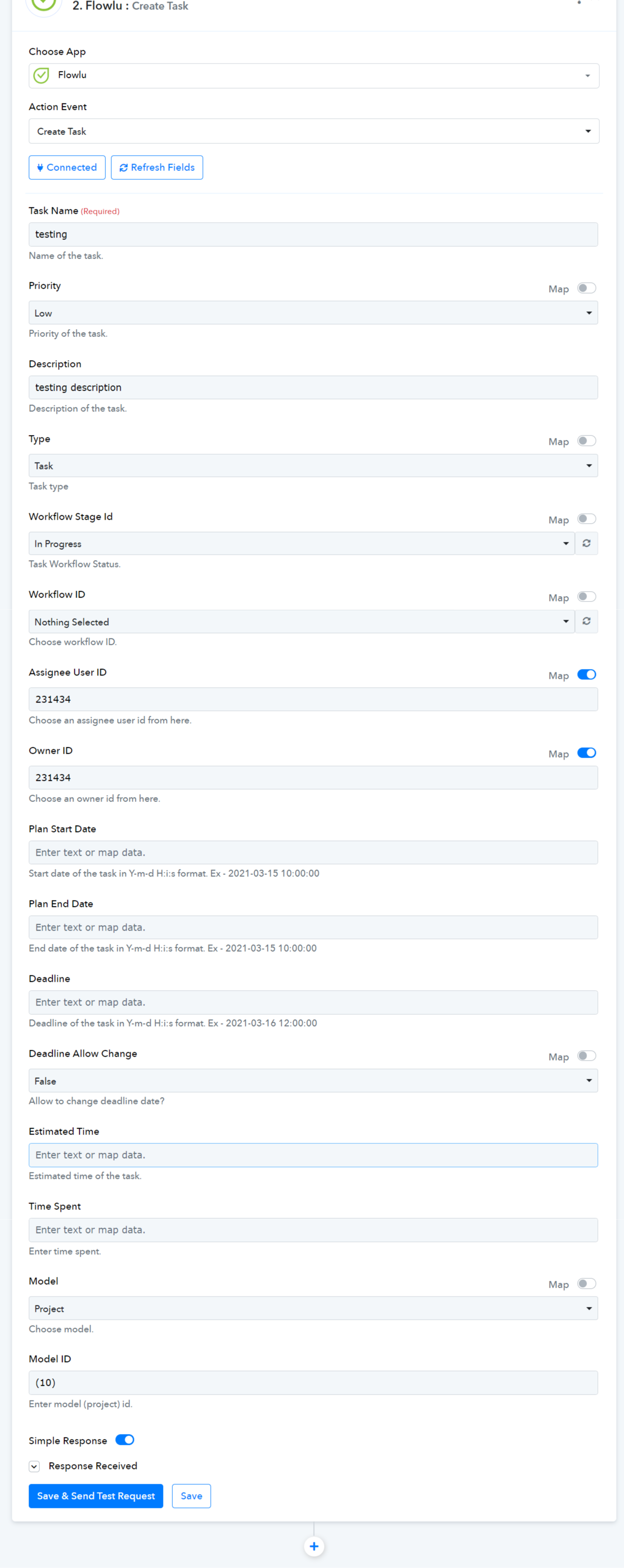

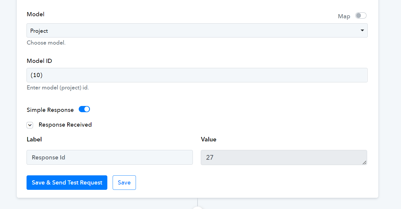

I need to create tasks in specific projects:
Project is (10)
The task is created:

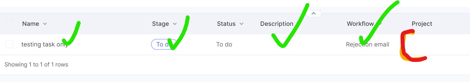

But not in the project:
I tried modifying the 10 just to "10", then "(10)", but nothing seems to work.

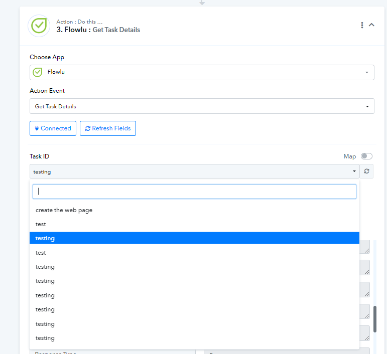

Hey @Oleksandr
I've conducted a test by creating a new task and then adding an action step to retrieve task details.
The task creation process appears to be functioning correctly, as indicated by the dropdown list showing the created task. So, you can rest assured that the task has been successfully created.

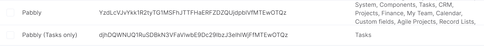

Further, can you please share the workflow URL once and cross-check if you have granted all the permission while creating the API credentials
Oleksandr
Thanks for your quick response.
I tried with 2 different permissions: All permissions and task only. result is the same.
The task is being created, but not attached to the project:

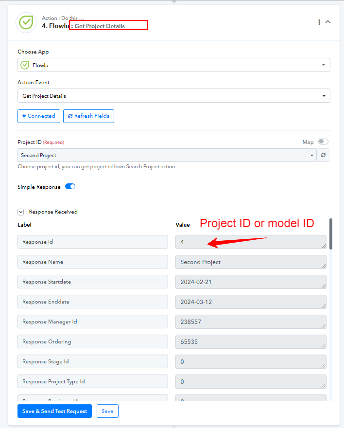

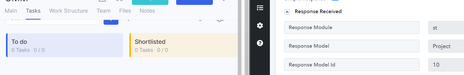

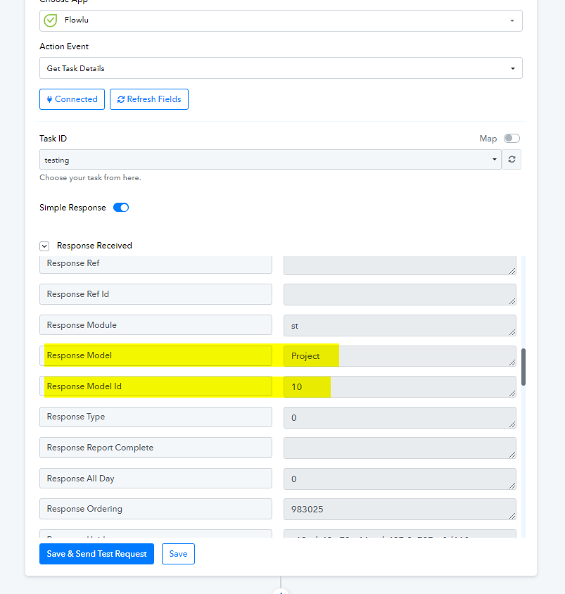

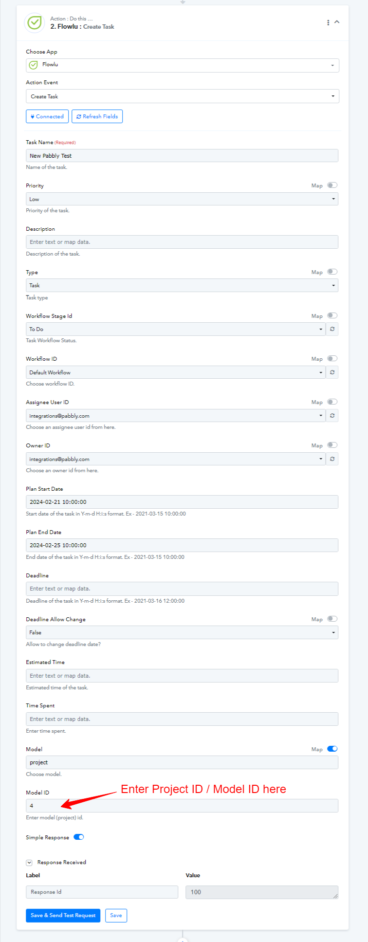

Hey @Oleksandr,
We would like to bring to your attention that the project ID differs from the model ID. It is imperative to input the correct values within the events to ensure accurate fetching of details. Upon my examination, the integration appears to be functioning properly from our end. We kindly request you to verify its functionality from your end as well. For your reference, I am attaching a screenshot.
Should you encounter any further issues, please do not hesitate to inform us. We are here to assist you.

Hello! Now I can confirm that it worked. Before, we had to include the numbers in between (), but now apparently, its only the number of the project. Thanks!
