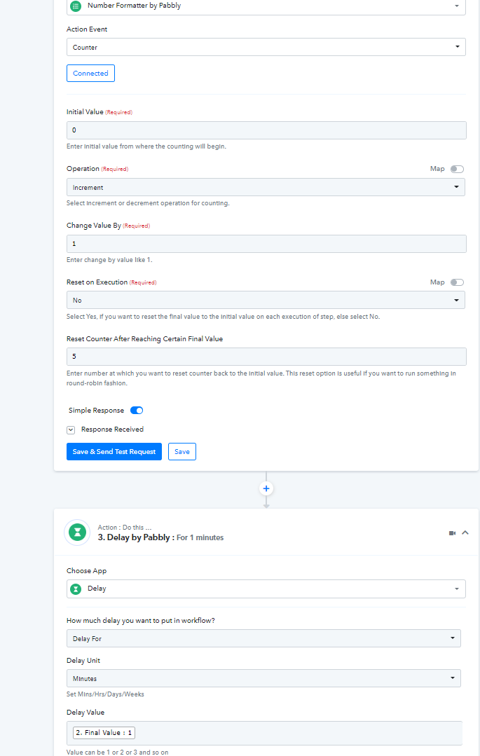

I think I figured this out, at least for my use case:
1) "Add Number Formatter by Pabbly"
2) Choose "Counter"
3) Initial value 0, Increment, Change value by 1, Reset on execution No, reset counter 5.
4) Add delay by Pabbly
5) In "Delay value", input the output from number formatter.
This seemed to work, although adding 200 rows now only took like 7 minutes, so it does not seem these steps actually added the time between each row as I thought it would. But it worked, so I am happy even if I don't understand it fully :)
