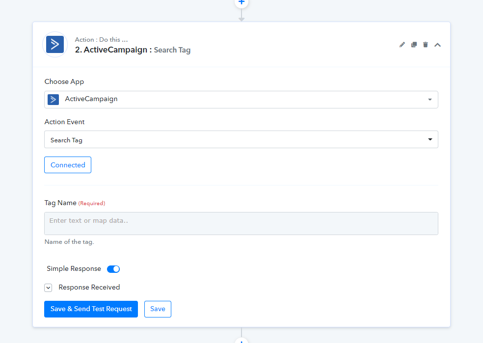

Hey @Aaron Parker
In the Map field, you need to map the Id of the tag which already presents in your Active Campaign. So to retrieve the Tag Id you need to use the " ActiveCampaign: Search Tag" action step and then you can use it further to assign tags.

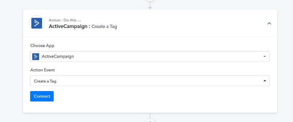

Hey @Aaron Parker
In that case, you need to create a tag first with the help of "ActiveCampaign: Create a Tag" and then need to map the tag ID in the Tag field.
