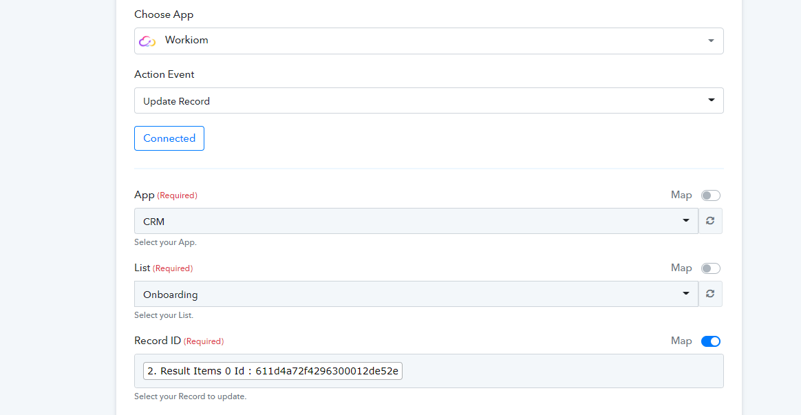

This video only shows 1 Workiom action - Update record.
But I also tried using other Workiom actions prior to using this action: "Find a record" and "Get List Records".

From video I am understanding that Update Record action required unique ID of the record you want to update.
I think so you will be getting that Unique Recor ID as a Response Received when you try Find A Record action of workiom.
Map that unique ID to Update Record Action by toggle on the Map as shown in above screenshot and you should be good to go.
This way it will get the Search for the record in the workiom using email id and get Unique Record ID. Then it will update that particular record using that dynamically mapped Record ID.

Hey @Edwin
We have created a clone of your workflow and added a step of "Find a Record " to get the Record ID. Further the "Company field" is also required and needs to be filled out.
Further, to find and update a record on the basis of the email ID, the email ID has to be already present in the List.

At 2.12 minutes you state that the id is the same, so thats cool. NO.
You need to overwrite that with the result from step 1, otherwise it's not dynamic.

Hey @Edwin
We have remapped the Update Record fields and re-map the Record ID too. So now it will not overwrite on the same record.
Please try again at your end and I hope this might help you.
